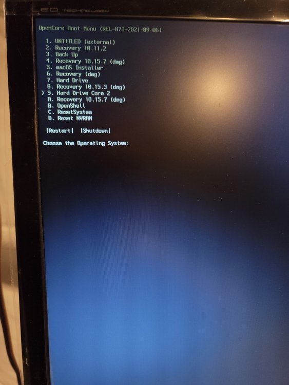

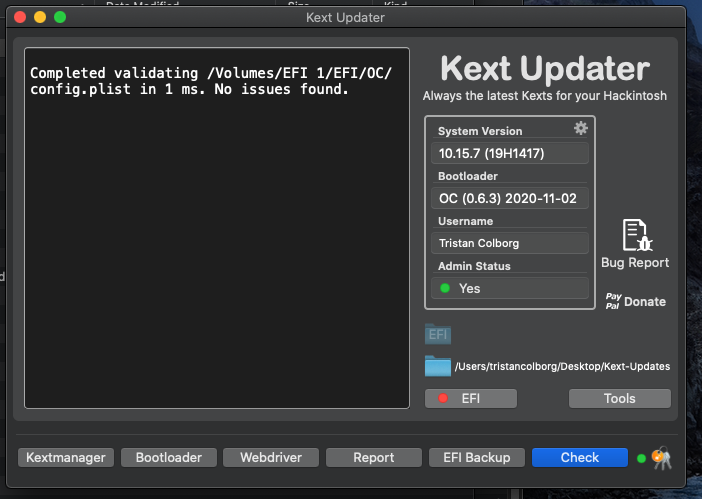

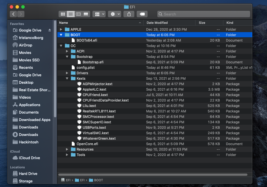

Tristan Colborg Posted September 16, 2021 Share Posted September 16, 2021 (edited) Hey there! I recently updated Opencore utilizing the guide on this site "[GUIDE] Updating and maintaining OpenCore (NEW METHOD!)", and then tried to also set up the new Launcher Option using this guide https://dortania.github.io/OpenCore-Post-Install/multiboot/bootstrap.html#updating-bootstrap-in-0-6-6. However, when I try to boot my new updated system I can't get it to boot. I can see at boot up that I am on the most current version of Opencore, and I am presented with 5 options. I can't recall exactly what they are but they are something like this: 1. EFI 2. Mac Recovery 3. Reset System 4. Reset NVRAM When I select EFI it says invalid OpenCore something. (I will try and grab a picture.) I also get this error in logging. 00:000 00:000 BS: Starting OpenCore... 00:003 00:003 BS: Booter path - \EFI\BOOT\BOOTX64.EFI 00:004 00:000 OCFS: Trying to locate filesystem on BD427798 BBBC5598 00:004 00:000 OCFS: Filesystem DP is \EFI\BOOT\BOOTX64.EFI 00:005 00:001 BS: Trying to start loaded OpenCore image... 00:006 00:001 BS: Unsupported bootstrap protocol 7 vs 6 00:007 00:000 OC: Boot failed - Unsupported 00:008 00:001 OCB: StartImage failed - Unsupported I have trouble shot as much as I know what to look for but can't get to boot unless it is from my backup EFI on my usb. Attached is my setup/equipment. Equipment GPU: Sapphire RX580 Memory: 16GB DDR3 OS: Mac OS 10.15.7 PSU: Thermaltake Smart 700 CPU: Intel Core i5-4690 Wifi: Fenvi T919 Motherboard: GIGABYTE GA-B85M-DS3H-A LGA Audio: Realtek ALC887 Storage: Kingston A400 240GB SSD RAM: G.SKILL Ripjaws X Series 16GB (4 x 4GB) 240-Pin DDR3 SDRAM DDR3 1600 (PC3 12800) Edited September 16, 2021 by Tristan Colborg Quote Link to comment https://www.insanelymac.com/forum/topic/348928-updating-opencore-from-063-to-073-cant-boot-up/ Share on other sites More sharing options...

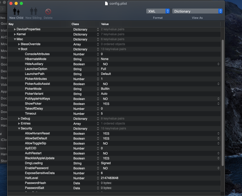

Guest 5T33Z0 Posted September 16, 2021 Share Posted September 16, 2021 (edited) @Tristan Colborg Okay, good. Basically, get into that config and change BootProtect to None (in written letters), save, reboot, perform an NVRAM reset and then you can update OpenCore. Btw, if windows is installed on a different physical drive, dont use bootstrap, you can always boot opencore from the bios bootmenu if windows boot manger takes over the first position in the boot order. It just causes headaches. About your config: the order of your drivers is wrong: 1. HfsPlus, 2 OpenRuntime, 3. OpenCanopy (disabled currently) RebuildAppleMemory Quirk is enabled, but according to the haswell guide it's supposed to be off You shouldn't have a DSDT File in ACPI – is it a patched one? Edited September 16, 2021 by 5T33Z0 Quote Link to comment https://www.insanelymac.com/forum/topic/348928-updating-opencore-from-063-to-073-cant-boot-up/#findComment-2766581 Share on other sites More sharing options...

Guest 5T33Z0 Posted September 16, 2021 Share Posted September 16, 2021 (edited) @Tristan ColborgOh and really important when running any macOS older than Big Sur with OC 073: UEFI > APFS > MinDate: set it to -1 (minus 1) UEFI > APFS > MinVersion: set it to -1 (minus 1) Minus 1 disables the security checks (date & version) for loading the APFS driver. Otherwise the APFS driver won't load (aka no Disk Icons for starting macOS), which seems to be exactly your problem. Edited September 16, 2021 by 5T33Z0 Quote Link to comment https://www.insanelymac.com/forum/topic/348928-updating-opencore-from-063-to-073-cant-boot-up/#findComment-2766585 Share on other sites More sharing options...

Guest 5T33Z0 Posted September 16, 2021 Share Posted September 16, 2021 (edited) Nope I wouldn't with your CPU. Big Sur has even more stuff running in the background than ever. I would stay on Catalina or Mojave (if 32 bit support is required). Or buy a cheap SSD for 30 bucks and throw Big Sur on there for testing. @Tristan Colborg Another source of machine not booting: SecureBootModel. Set it to Disabled if the machine doesn't boot Edited September 16, 2021 by 5T33Z0 Quote Link to comment https://www.insanelymac.com/forum/topic/348928-updating-opencore-from-063-to-073-cant-boot-up/#findComment-2766588 Share on other sites More sharing options...

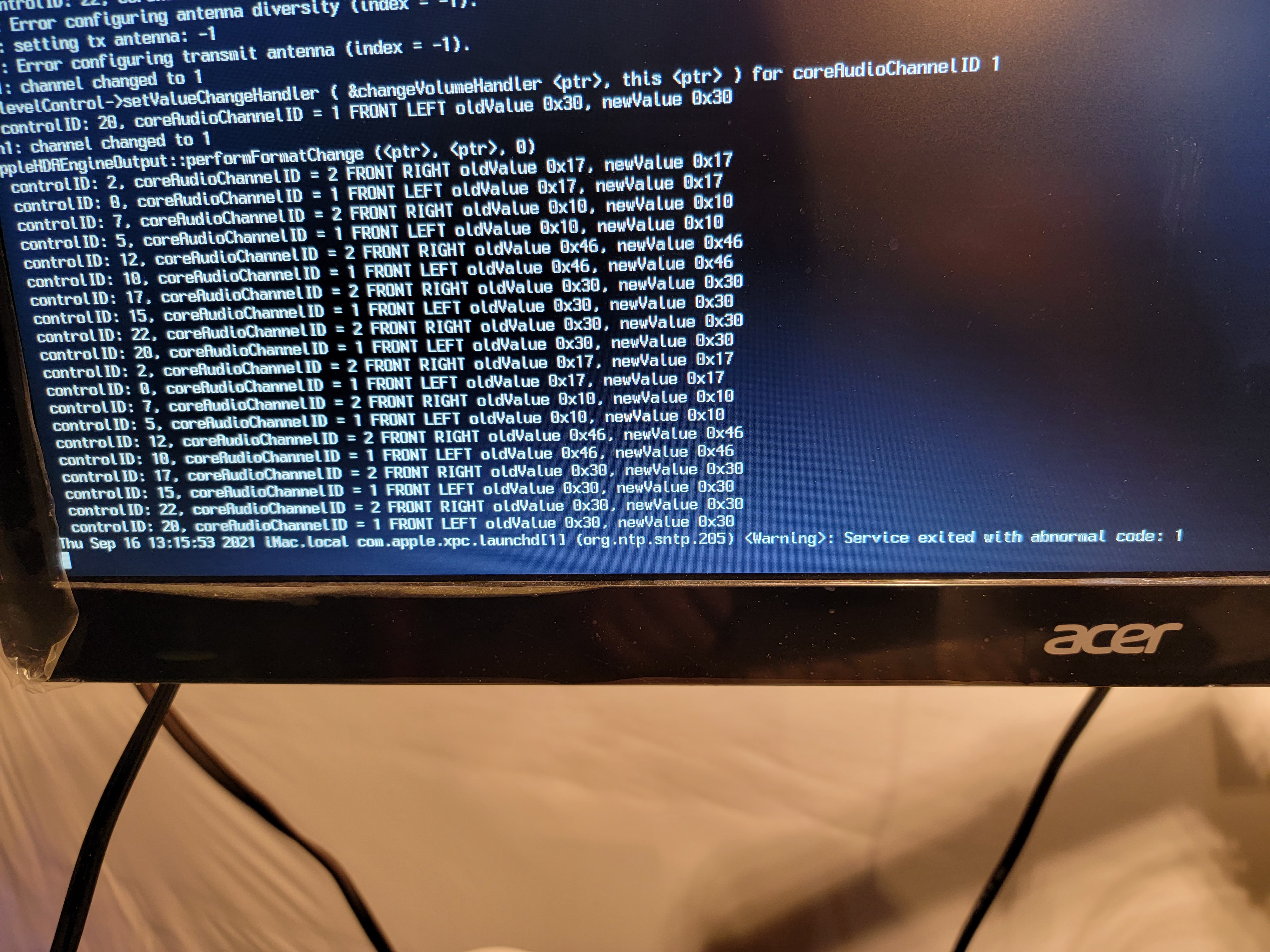

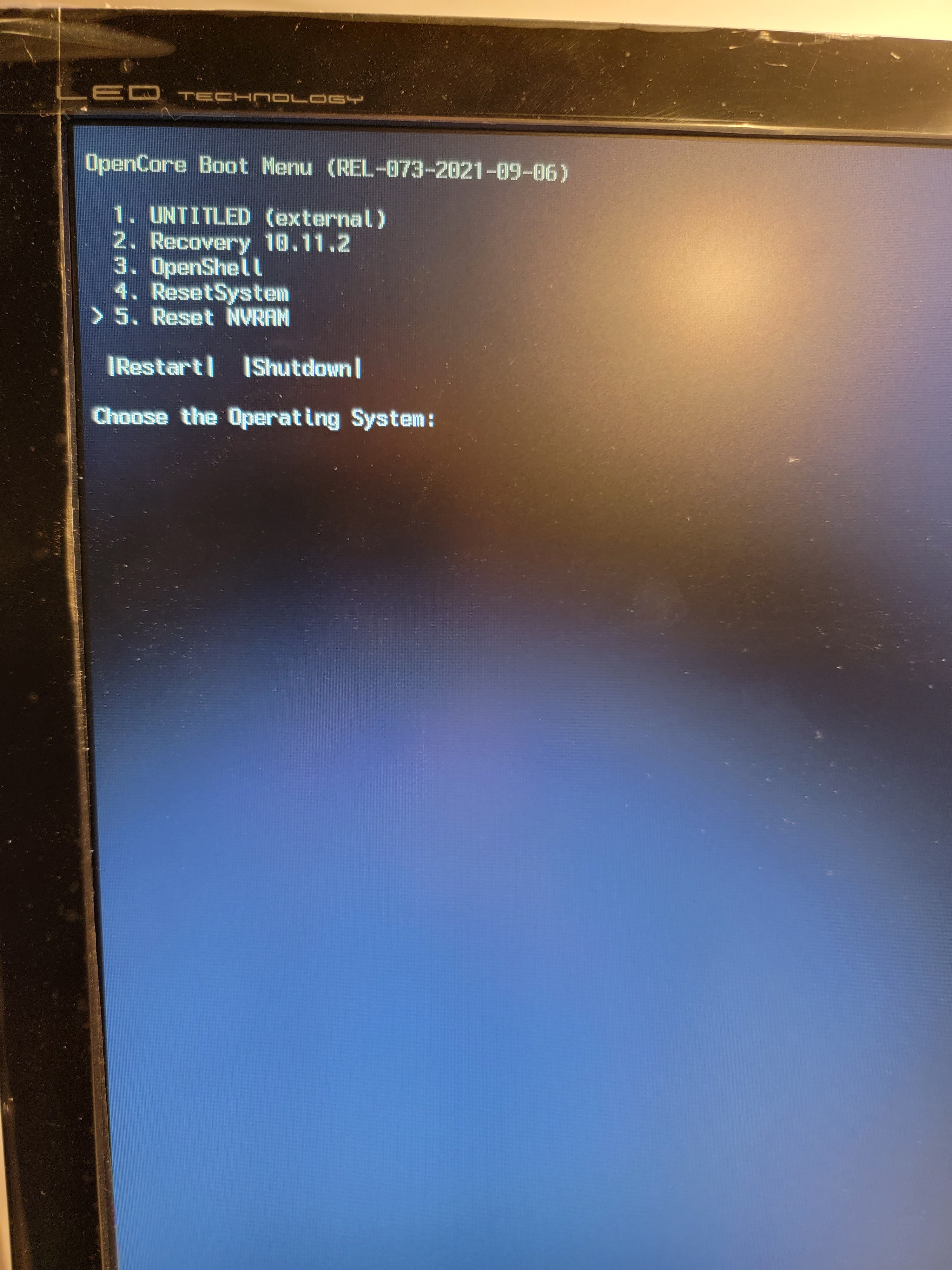

Tristan Colborg Posted September 16, 2021 Author Share Posted September 16, 2021 9 minutes ago, 5T33Z0 said: Nope I wouldn't with your CPU. Big Sur has even more stuff running in the background than ever. I would stay on Catalina or Mojave (if 32 bit support is required). Or buy a cheap SSD for 30 bucks and throw Big Sur on there for testing. @Tristan Colborg Another source of machine not booting: SecureBootModel. Set it to Disabled if the machine doesn't boot Okay so this is where I am at now. I did what you recommended and got it to boot the new OpenCore and have my drives show up. I selected my HD and it boots until I get the attached error. Then it stops and finishes booting into Recovery. 12 minutes ago, 5T33Z0 said: Nope I wouldn't with your CPU. Big Sur has even more stuff running in the background than ever. I would stay on Catalina or Mojave (if 32 bit support is required). Or buy a cheap SSD for 30 bucks and throw Big Sur on there for testing. @Tristan Colborg Another source of machine not booting: SecureBootModel. Set it to Disabled if the machine doesn't boot Could I upgrade my CPU with the current motherboard? Or upgrade both with the other equipment I have? Quote Link to comment https://www.insanelymac.com/forum/topic/348928-updating-opencore-from-063-to-073-cant-boot-up/#findComment-2766590 Share on other sites More sharing options...

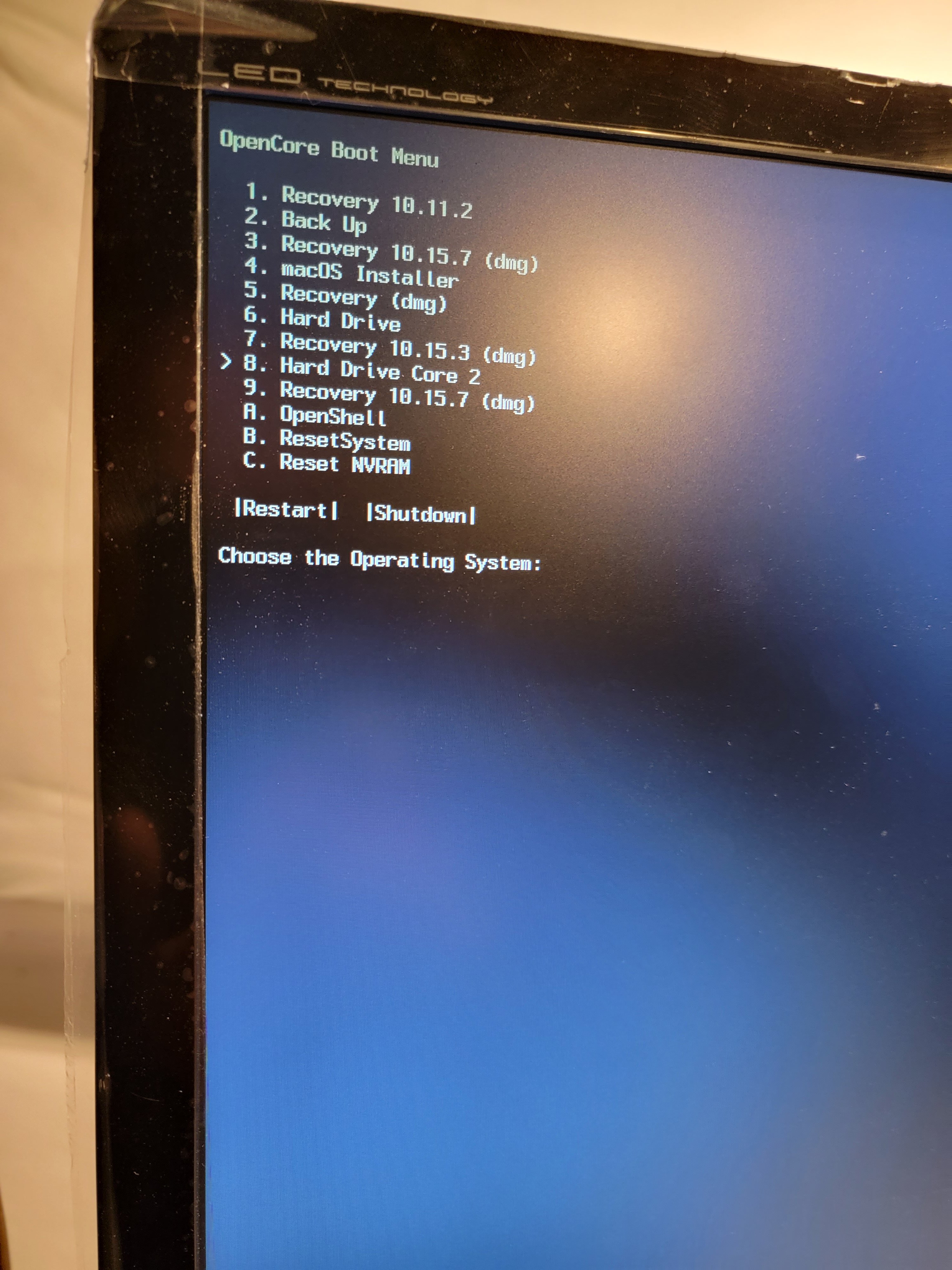

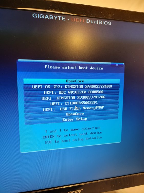

Tristan Colborg Posted September 16, 2021 Author Share Posted September 16, 2021 Okay I changed SecureBootModel to disabled looks like I can get it to boot using the newest OpenCore. However, I don't get an option on my BIOS boot screen for OpenCore am I supposed to? Quote Link to comment https://www.insanelymac.com/forum/topic/348928-updating-opencore-from-063-to-073-cant-boot-up/#findComment-2766591 Share on other sites More sharing options...
Tristan Colborg Posted September 16, 2021 Author Share Posted September 16, 2021 5 minutes ago, Tristan Colborg said: Okay I changed SecureBootModel to disabled looks like I can get it to boot using the newest OpenCore. However, I don't get an option on my BIOS boot screen for OpenCore am I supposed to? Never mind got it fixed. I needed to go back into the Config file and change LauncherOption to full. Now when I boot my BIOS menu shows OpenCore as an option and then boots to the OpenCore menu. I select my HD and it boots up... Thanks I appreciate the help! Quote Link to comment https://www.insanelymac.com/forum/topic/348928-updating-opencore-from-063-to-073-cant-boot-up/#findComment-2766592 Share on other sites More sharing options...
Guest 5T33Z0 Posted September 16, 2021 Share Posted September 16, 2021 @Tristan Colborg Did you update your Kexts as Slam suggested? Did you disable RebuildAppleMemoryMap as well as recommended by the guide? The pic looks like issues with the Bluetooth/Wifi kext as well as AppleALC The hierarchy of your kexts is wrong: Lilu, VirtualSMC, Whatevergreen, Rest I would start with a minimal set as recommended by slam 1 minute ago, Tristan Colborg said: Never mind got it fixed. I needed to go back into the Config file and change LauncherOption to full. Now when I boot my BIOS menu shows OpenCore as an option and then boots to the OpenCore menu. I select my HD and it boots up... Thanks I appreciate the help! Did you change it for the old (063) version or the new one (073)? Because if you changed it back on the old one and then upgrade the misery starts all over again. Quote Link to comment https://www.insanelymac.com/forum/topic/348928-updating-opencore-from-063-to-073-cant-boot-up/#findComment-2766593 Share on other sites More sharing options...

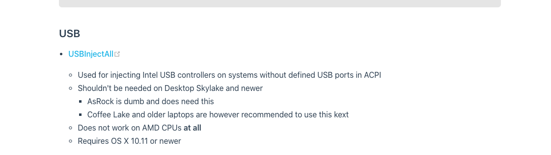

Tristan Colborg Posted September 17, 2021 Author Share Posted September 17, 2021 On 9/16/2021 at 7:46 AM, 5T33Z0 said: @Tristan Colborg Did you update your Kexts as Slam suggested? Did you disable RebuildAppleMemoryMap as well as recommended by the guide? The pic looks like issues with the Bluetooth/Wifi kext as well as AppleALC The hierarchy of your kexts is wrong: Lilu, VirtualSMC, Whatevergreen, Rest I would start with a minimal set as recommended by slam Did you change it for the old (063) version or the new one (073)? Because if you changed it back on the old one and then upgrade the misery starts all over again. I changed it on the new version. I switched the hierarchy of my KEXT files on my config.plist, and all my KEXT are updated. It boots up fine, but question is there a way for it to auto select the startup OS? It defaults to whatever is at the top of the list and want it to default to my other hard drive. See picture for example. 23 hours ago, slam said: I know this sounds a bit silly, I find USB3 flash drives get installation problems. If you have a USB2 one, it works much better. Your MB and Graphics card should be very easy to configure. You should only need Boot args: alcid=1 for kexts: should only need: Lilu, Virtual SMC, AppleALC, IntelMausi, USBInjectAll, WhateverGreen. I think your WiFi/Bluetooth card may need some other kexts, but you can fix them afterwards, once Catalina is installed. the only problem is ACPI, make sure you don't download from some guide, everyone's a little bit different, try to make your own following the guide, is quite straight forward the last thing is the Bios settings: - M.I.T > Extreme Memory Profile (XMP) > Profile 1 - CSM support > Disabled - Secure Boot > Disabled - Intel Platform Trust Technology > Disabled - USB Configuration > Legacy USB support > Enabled - USB Configuration > XHCI Hands-off > Enabled - Network Stack Configuration > Network Stack > Disabled - Vt-d > Disabled - Internal Graphics > Automatic I don't have your board, but Gigabyte MB are quite similar. I made the changes to the BIOS that you recommended. I didn't have all the options but the ones I did have I changed. From what I remember reading in the guide I don't need a couple of the KEXT files you are recommending. IntelMausi I don't need because my MB has a RealTek ethernet card on it. I also thought I didn't need the USBInjectAll because I thought my set up was Skylake or newer. Lastly I can't remember where to change/add the boot args. Quote Link to comment https://www.insanelymac.com/forum/topic/348928-updating-opencore-from-063-to-073-cant-boot-up/#findComment-2766682 Share on other sites More sharing options...
Guest 5T33Z0 Posted September 17, 2021 Share Posted September 17, 2021 @Tristan Colborg OpenCore doesn't require USBInjectAll. You can enable XhciPortLimit Quirk in the config, instead. You only need USBInjectAll if you need to create a USB Port Map with Hackintool. If you plain to use Big Sur you need to map USB ports if your board has more than 15 USB ports per controller overall (USB 3 counts as 2 ports: one USB 2 and one USB 3 port). Startup Disk: you change it in System Preferences > Startup Disk like on a regular Mac. Set it to the disk you want. Alternatively, you can enable PollAppleHotkeys in OC config. Then you can set the default bootdisk by pressing CTRL+ENTER in the BootPicker. Quote Link to comment https://www.insanelymac.com/forum/topic/348928-updating-opencore-from-063-to-073-cant-boot-up/#findComment-2766685 Share on other sites More sharing options...
