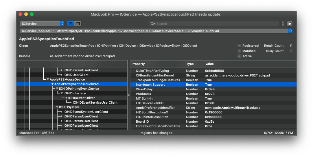

Avery B Posted September 7, 2021 Share Posted September 7, 2021 (edited) Does it support Intertouch? (Connected over SMBus). If you look under IOReg, it should say something about Intertouch Support if it does work. If that's the case, I'd take a look at VoodooRMI - that'd work better than either PS2 kext. (Pic below) Spoiler For VoodooPS2, I honestly have no clue. Might be something weird with Extended W mode being used, but it doesn't mention any sort of deadzone quickly looking through the code. Edited September 7, 2021 by 1Revenger1 Link to comment https://www.insanelymac.com/forum/topic/348807-remove-dead-zone-from-thinkpad-trackpad-voodoops2controller/#findComment-2765854 Share on other sites More sharing options...
Guest 5T33Z0 Posted September 8, 2021 Share Posted September 8, 2021 10 hours ago, 1Revenger1 said: Does it support Intertouch? (Connected over SMBus). If you look under IOReg, it should say something about Intertouch Support if it does work. If that's the case, I'd take a look at VoodooRMI - that'd work better than either PS2 kext. (Pic below) Reveal hidden contents For VoodooPS2, I honestly have no clue. Might be something weird with Extended W mode being used, but it doesn't mention any sort of deadzone quickly looking through the code. Unfortunately, it's not connected over SMBus. But I will look into this Extended W Mode. Thanks for the help. Link to comment https://www.insanelymac.com/forum/topic/348807-remove-dead-zone-from-thinkpad-trackpad-voodoops2controller/#findComment-2765893 Share on other sites More sharing options...
