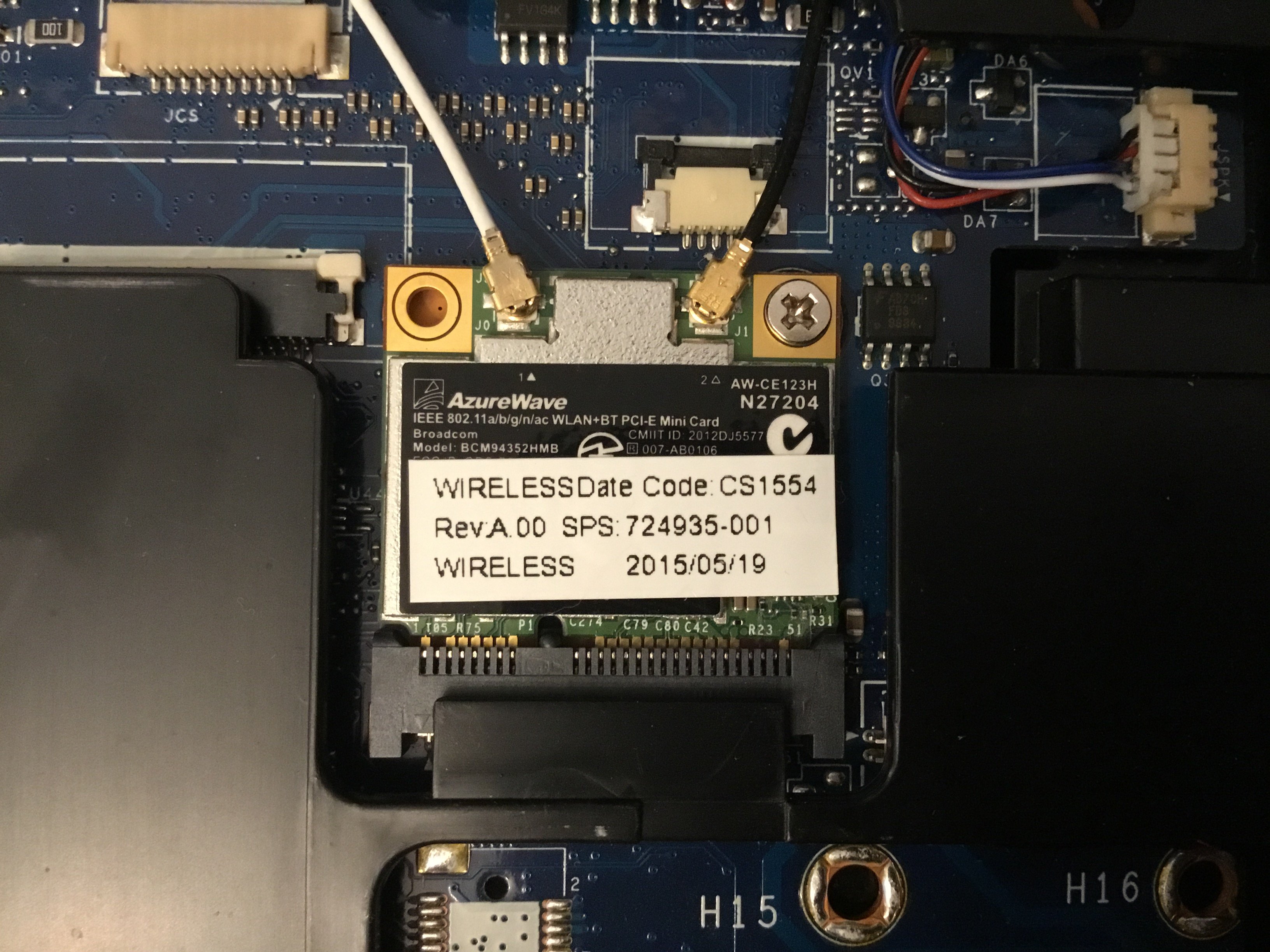

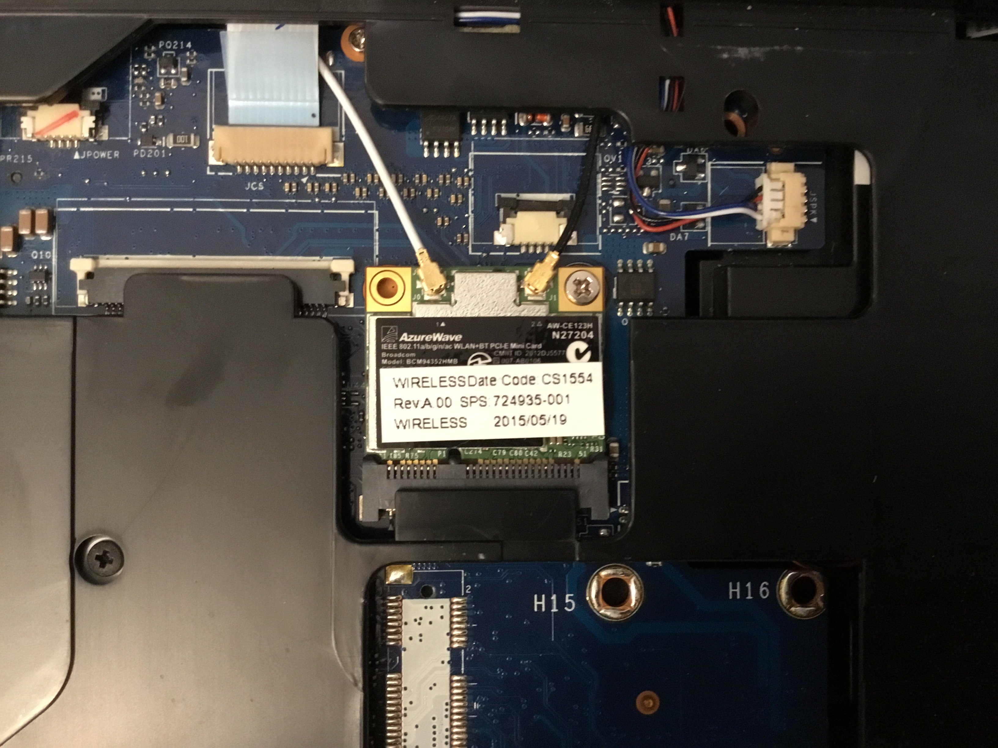

Fortitude Posted July 24, 2021 Author Share Posted July 24, 2021 (edited) I hate to admit it, but when running “lsusb” in Linux, the bluetooth card doesn’t show up. Nor does it show up in the Windows Device Manager. This is quite frustrating and confusing because like I said earlier the bluetooth on my AR9285/AR3011 card worked properly. The exact part number for that card is K000113820. Meanwhile here's what the new card look like in my system. Is it possible that I could have a defective card or a whitelist? I’ve got WiFi working across all three operating systems, but not bluetooth. I’ve extracted my BIOS, EC, and VBIOS if anyone knows how to look for a whitelist. (I have a 2010 Aptio BIOS.) BIOS.rom EC.rom VBIOS.rom Edited October 7, 2024 by Fortitude Quote Link to comment https://www.insanelymac.com/forum/topic/348335-broadcom-20702a3-bluetooth-problems/#findComment-2763480 Share on other sites More sharing options...

Fortitude Posted July 26, 2021 Author Share Posted July 26, 2021 (edited) I cannot believe it, but my assumptions were correct… There’s a whitelist implemented somewhere on this laptop, and taping pin 51 on my nic bypassed it. I now have working bluetooth across all of my operating systems. Edited October 7, 2024 by Fortitude Quote Link to comment https://www.insanelymac.com/forum/topic/348335-broadcom-20702a3-bluetooth-problems/#findComment-2763643 Share on other sites More sharing options...
