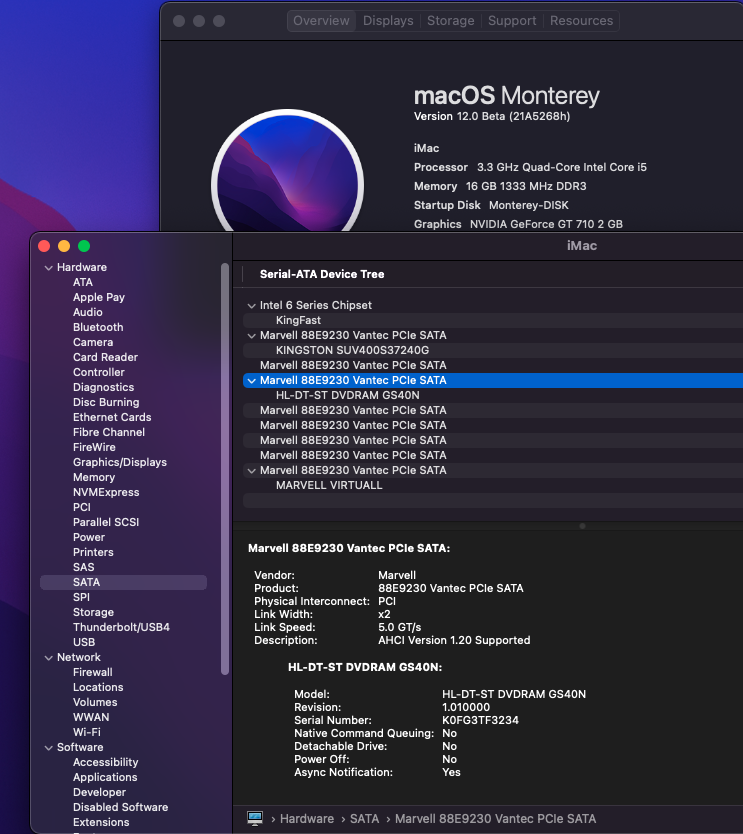

chris1111 Posted July 18, 2021 Share Posted July 18, 2021 (edited) 1 hour ago, mboy said: Can I use the IO CREST SI-PEX40059 card (Marvell chipset 88SE9120) to connect an internal DVD drive to its SATA port on my hack? An ASM1061 chipset controller card did not work as apparently this card does not recognize ATAPI commands. Any advice ? If your DVD is connect to the SATA port on the ASM1061 with that card its work We have also the 4 Channel 6-Port SATA 6Gb/S PCIe RAID Host Card Works great Monterey and Big Sur See DVDRAM GS40N connect to the SATA on the Vantec card Edited July 18, 2021 by chris1111 1 Link to comment https://www.insanelymac.com/forum/topic/348307-marvell-88se9120-and-dvd-drive/#findComment-2763149 Share on other sites More sharing options...

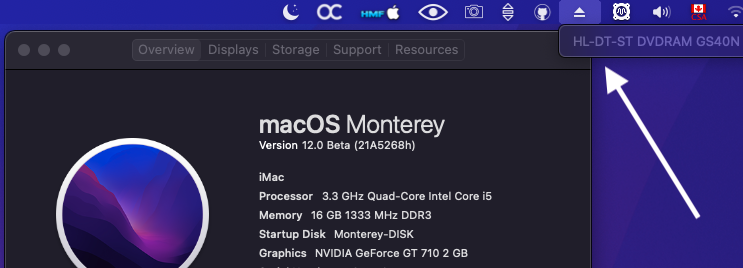

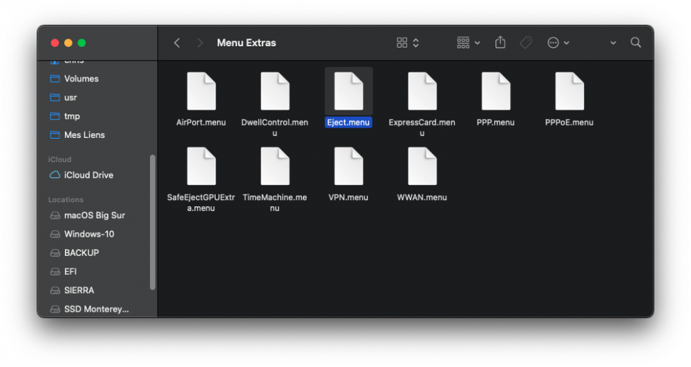

chris1111 Posted July 18, 2021 Share Posted July 18, 2021 (edited) 23 minutes ago, mboy said: I am using the SY-PEX40039 card you mentioned. The eject button does not work. Roxio Toast Titanium crashes on start-up. Burn application causes the system to freeze after a DVD is inserted in the drive. I believe this is a know problem with this storage controller card. I was wondering if anyone has success with a Marvell chipset card. I dont have any issue with that card on my DVD the eject Button works good you have to copy on desktop /Sytem/Library/CoreServices/Menu Extras/ Eject.menue And double clic to see the Eject.menue on the bar What is the DVD Writer? Edited July 18, 2021 by chris1111 1 Link to comment https://www.insanelymac.com/forum/topic/348307-marvell-88se9120-and-dvd-drive/#findComment-2763152 Share on other sites More sharing options...

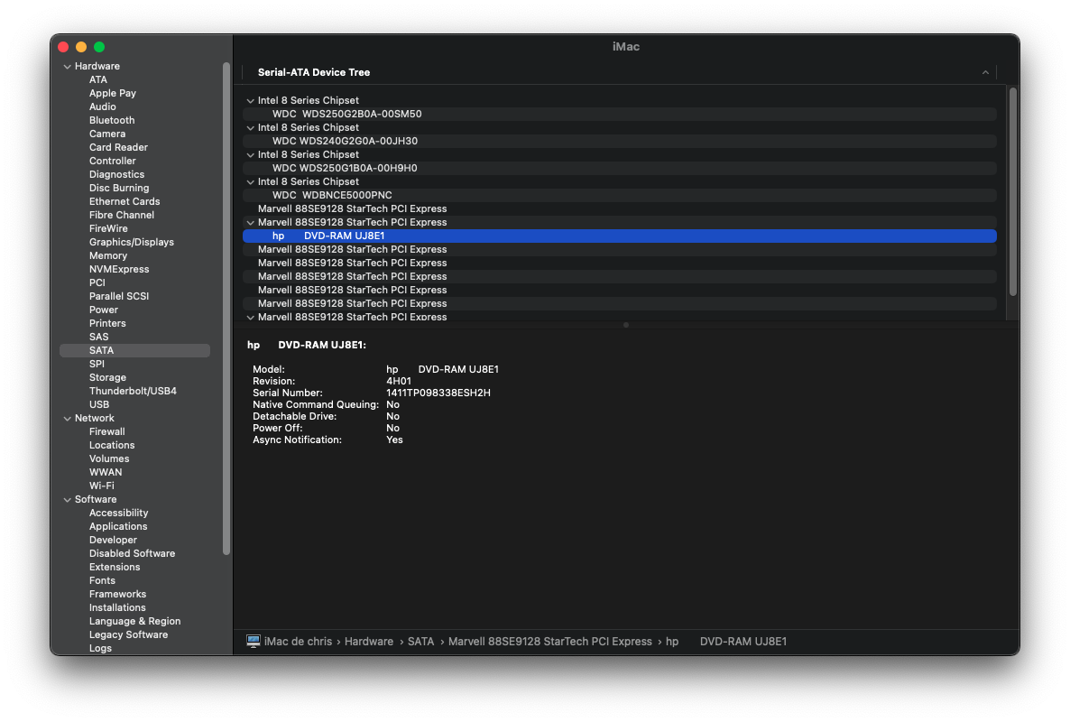

chris1111 Posted July 18, 2021 Share Posted July 18, 2021 (edited) The best choice is 4 Channel 6-Port SATA 6Gb/S PCIe RAID Host Card also I use that one StarTech.com PEXSAT32 on Monterey on my Main System works also on Big Sur and lower macOS I no longer have SY-PEX40039 it to test it, I had it a long time ago and I think it worked well in Yosemite unless I got the wrong card, I had so many and currently I have three working well Edited July 18, 2021 by chris1111 I no longer have SY-PEX40039 1 Link to comment https://www.insanelymac.com/forum/topic/348307-marvell-88se9120-and-dvd-drive/#findComment-2763156 Share on other sites More sharing options...
