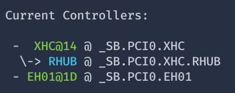

USBMap doesn't report any issues:
But when I start mapping USB ports then I have a problem with some USB 2.0 ports:
