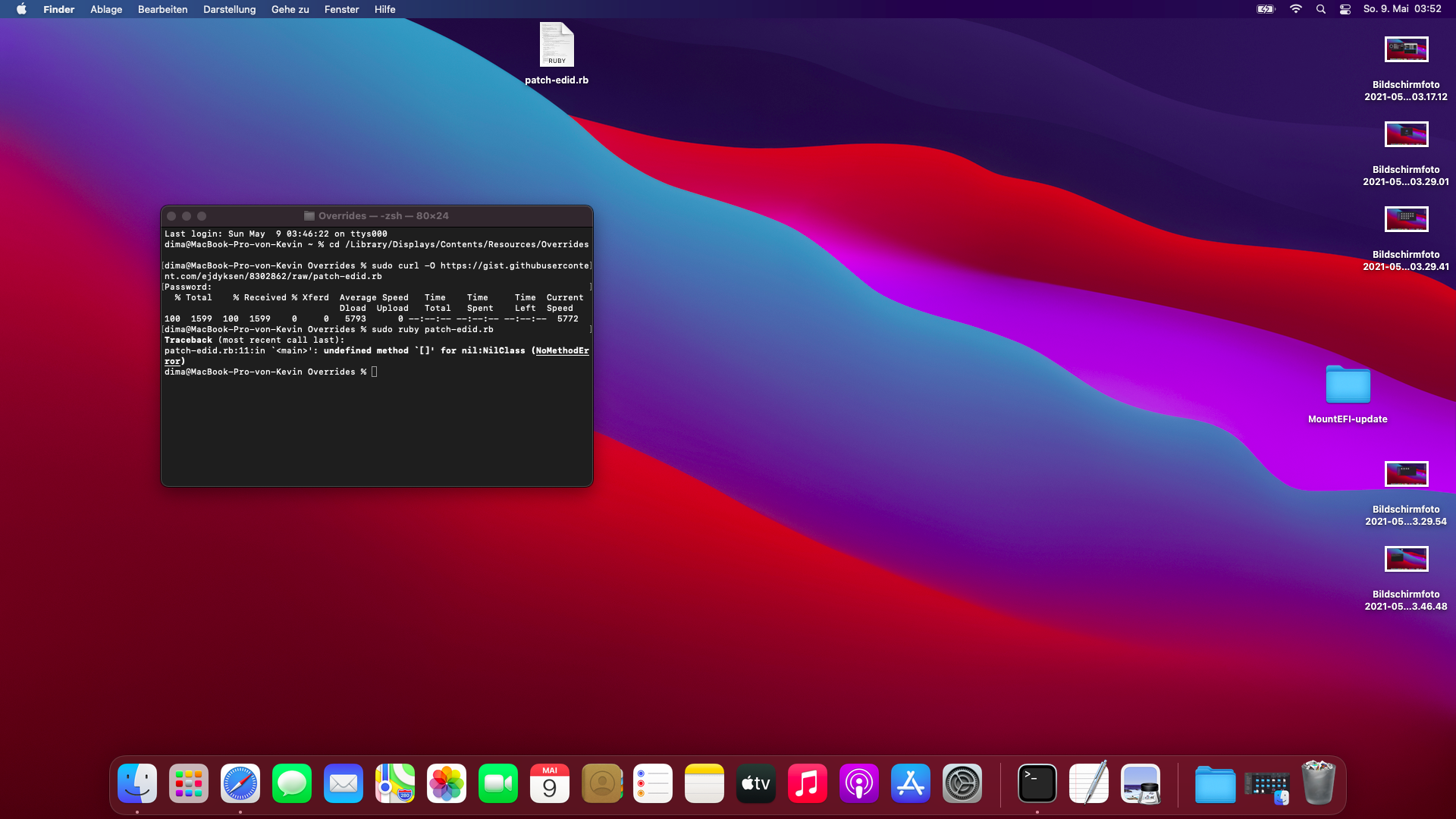

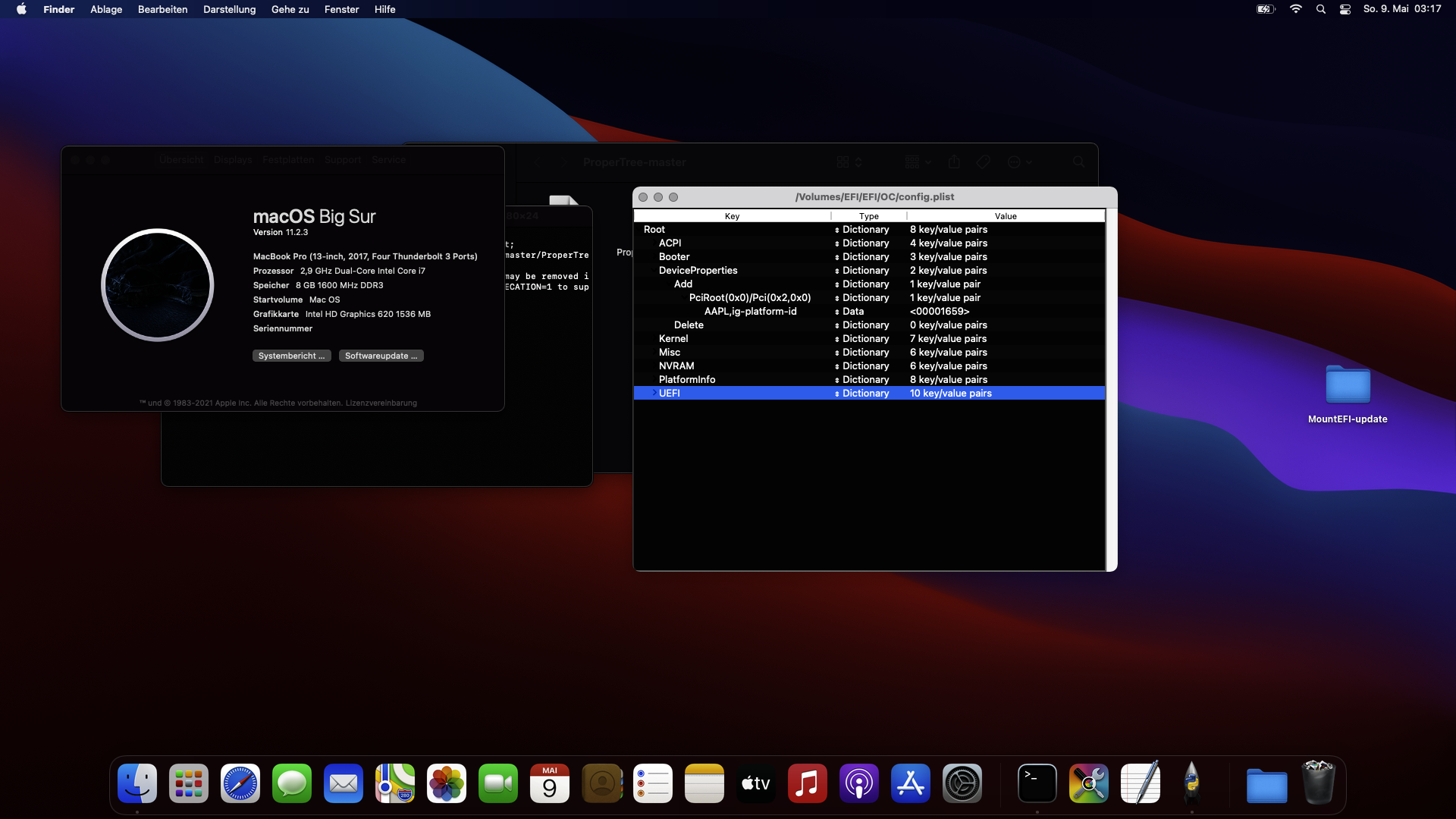

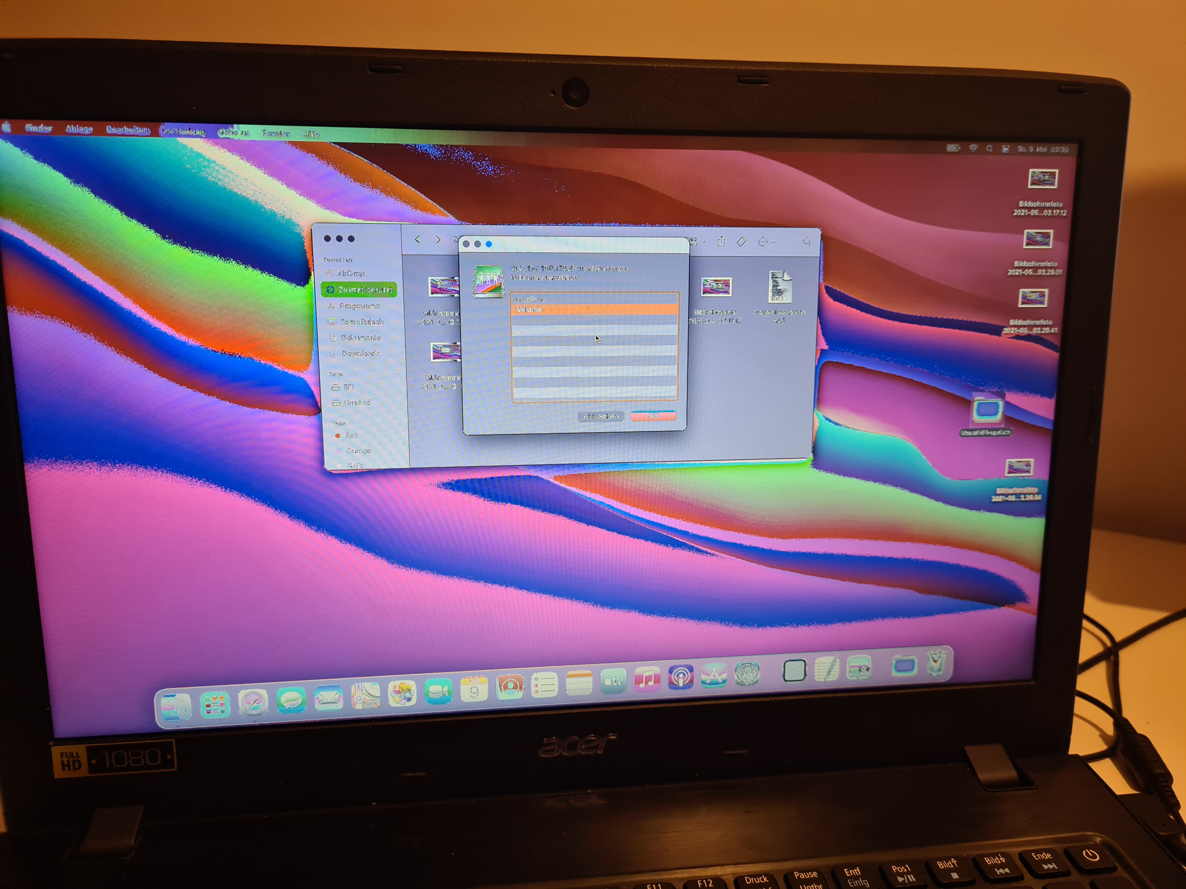

I successfully installed Mac OS 11.2.3 on an Acer Aspire E 15 E5-576-76J8. i can't look for things working and not working because i have a big issue holding me back. If i inject nothing or the wrong ig-platform everything looks usual, but my iGPU got only 7mb of VRAM and therefore i have no hardware acceleration. Now for the weird part: if i inject the right ig-platform and/or device-id and/or manage the framebuffer in the config.plist my Intel HD 620 gets 1,5GB of VRAM BUT everything looks weird. It looks like the Display outputs some resolution like 800x600 and all colors are inverted. When i screenshot and look the file on another machine everything looks great. I tried to run a script to fix the Edid of the Display because i was assuming Mac OS was not communicaing rigth with the display but i get error messages. I am tinkering for 2 weeks now. Anyone has a solution? I use the latest OpenCore Bootloader, i downloaded all Kext latest from source and i took clean Snapshots with Proper Tree. I followed the Dortania Guide for Kaby Lake Laptops.

Here is my EFI: https://drive.google.com/file/d/19gy37zIniv3mML9BwsT79JCrjX9aNmD-/view?usp=sharing
