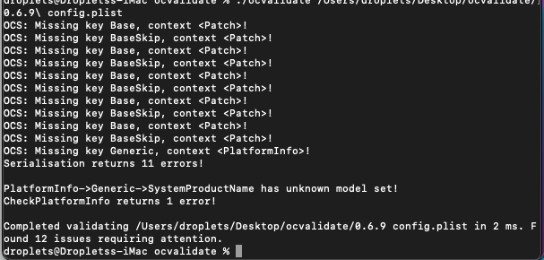

droples Posted May 7, 2021 Share Posted May 7, 2021 14 hours ago, baddles said: (Sorry for my English). So today I decided to upgrade my system from OC 0.6.6 to 0.6.9. With Picker = Builtin, the system showed the builtin picker just fine. However, with Picker = External, the system would freeze right before the picker loads. I compared to a successful External boot from another machine and blind-guessing that following these lines, GOP failed to load: OCAE: Failed to handle GOP, discovering UGA - Unsupported OCAE: Failed to get screen resolution - Unsupported Here I have uploaded the current working config.plist from both the versions for comparison. Here are my laptop specs: Dell Inspiron 7373 (i7373-7443SLV) CPU: Intel Core i7-8550u GPU: Intel UHD Graphics 620 RAM: 16GB SSD: 256GB Micron SATA SSD Currently using MacBookPro14,1 SMBios. Please help, any help is appreciated, thanks in advance 0.6.9 config.plist 38.72 kB · 2 downloads 0.6.9 log.txt 256 kB · 0 downloads 0.6.6 config.plist 36.7 kB · 0 downloads 0.6.6 log.txt 256 kB · 0 downloads 1.You need to update resources https://github.com/acidanthera/OcBinaryData/tree/master/Resources 2. Fix your config.plist Differences.pdf Sample.plist 3.And then you will see what to do. Link to comment https://www.insanelymac.com/forum/topic/347652-oc-069-failed-to-handle-gop/#findComment-2757362 Share on other sites More sharing options...
baddles Posted May 8, 2021 Author Share Posted May 8, 2021 8 hours ago, droples said: 1.You need to update resources https://github.com/acidanthera/OcBinaryData/tree/master/Resources 2. Fix your config.plist Differences.pdf 386.35 kB · 0 downloads Sample.plist 33.82 kB · 0 downloads 3.And then you will see what to do. In 0.6.9 config I did cloned master before booting. Same result tho. For the config, well I did fix those errors eventually after this topic was made, but like I said, the same issue persists. I had to move the cursor/trackpad for the GUI to update, but then the performance seems not as good as 0.6.6. Link to comment https://www.insanelymac.com/forum/topic/347652-oc-069-failed-to-handle-gop/#findComment-2757390 Share on other sites More sharing options...
