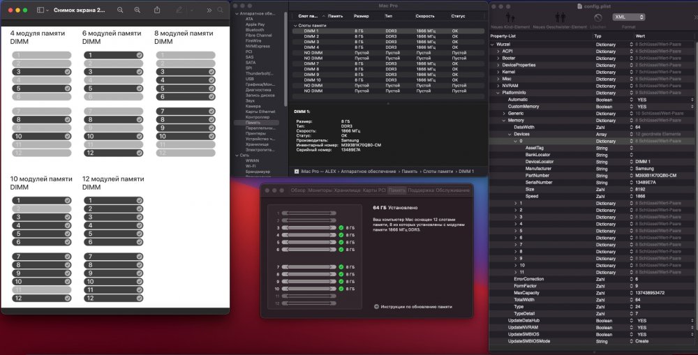

Andrey1970 Posted May 4, 2021 Share Posted May 4, 2021 (edited) From testers: Installation 4 module dimm Installation 8 module dimm Edited May 4, 2021 by Andrey1970 1 Link to comment https://www.insanelymac.com/forum/topic/347629-how-to-macpro71-smbios-opencore-069-restricteventskext/#findComment-2757146 Share on other sites More sharing options...
Andrey1970 Posted May 4, 2021 Share Posted May 4, 2021 (edited) RestrictEvents is easier to use and you will have no phantom memory-slots. Edited May 4, 2021 by Andrey1970 1 Link to comment https://www.insanelymac.com/forum/topic/347629-how-to-macpro71-smbios-opencore-069-restricteventskext/#findComment-2757151 Share on other sites More sharing options...
miliuco Posted May 4, 2021 Author Share Posted May 4, 2021 (edited) 55 minutes ago, Andrey1970 said: RestrictEvents is easier to use and you will have no phantom memory-slots. Understood. Thanks for the info. Then the question is solved: "Or the correct custom memory for MacPro7,1 or RestrictEvents, not both". In my case, as you say, RestrictEvents would be more useful because I have only 2 DIMM modules and MacPro7,1 expects there to be at least 4. Edited May 4, 2021 by miliuco Link to comment https://www.insanelymac.com/forum/topic/347629-how-to-macpro71-smbios-opencore-069-restricteventskext/#findComment-2757155 Share on other sites More sharing options...
