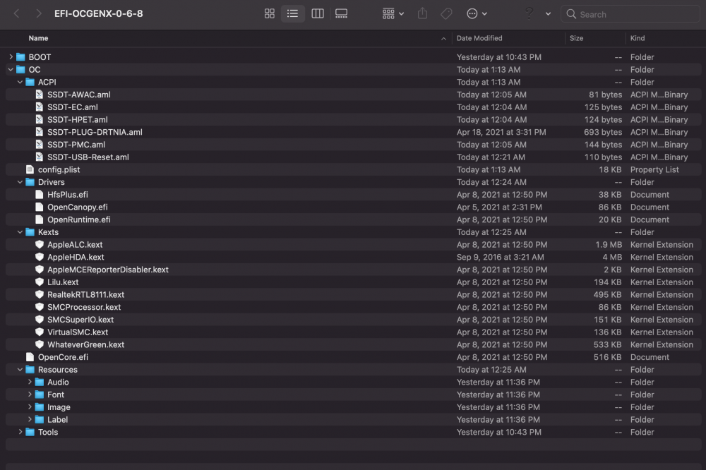

macjedi Posted April 26, 2021 Author Share Posted April 26, 2021 I used SSDT Time to create machine specific SSDTs after running on Windows10 to create a DSDT. Successfully added them to my 0.6.2 EFI. Also added them to my test 0.6.8 EFI and it goes all the way past the OpenCanopy picker and stops with a black screen. I can hear system chime if I press any key on the keyboard though. I'm quite confused as to why it won't complete the boot process in 0.6.8. Desktop: (10th Gen) Comet Lake OpenCore 0.6.8 https://dortania.github.io/OpenCore-Install-Guide/config.plist/comet-lake.html ACPI Add SSDT-AWAC.aml Make sure this file is in your OC/ACPI directory SSDT-EC.aml Make sure this file is in your OC/ACPI directory SSDT-HPET.aml Make sure this file is in your OC/ACPI directory SSDT-PMC.aml Make sure this file is in your OC/ACPI directory SSDT-USB-Reset.aml Make sure this file is in your OC/ACPI directory SSDT-PLUG-DRTNIA.aml Make sure this file is in your OC/ACPI directory Delete Patch Quirks FadtEnableReset = No NormalizeHeaders = No RebaseRegions = No ResetHwSig = No ResetLogoStatus = No Booter MmioWhitelist Patch Quirks AllowRelocationBlock = No AvoidRuntimeDefrag = Yes DevirtualiseMmio = Yes DisableSingleUser = No DisableVariableWrite = No DiscardHibernateMap = No EnableSafeModeSlide = Yes EnableWriteUnprotector = No ForceExitBootServices = No ProtectMemoryRegions = No ProtectSecureBoot = No ProtectUefiServices = Yes ProvideCustomSlide = Yes ProvideMaxSlide = 0 RebuildAppleMemoryMap = Yes SetupVirtualMap = No SignalAppleOS = No SyncRuntimePermissions = Yes ForceBooterSignature = No DeviceProperties Add Delete Kernel Add Lilu.kext make sure this Kext is in your OC/Kexts directory and the first kext listed here VirtualSMC.kext make sure this Kext is in your OC/Kexts directory SMCProcessor.kext make sure this Kext is in your OC/Kexts directory SMCSuperIO.kext make sure this Kext is in your OC/Kexts directory WhateverGreen.kext make sure this Kext is in your OC/Kexts directory AppleALC.kext make sure this Kext is in your OC/Kexts directory RealtekRTL8111.kext make sure this Kext is in your OC/Kexts directory AppleMCEReporterDisabler.kext make sure this Kext is in your OC/Kexts directory Block Emulate DummyPowerManagement = No Force Patch Quirks AppleCpuPmCfgLock = No AppleXcpmCfgLock = Yes You should disable CFG-Lock in your bios instead of using this AppleXcpmExtraMsrs = No AppleXcpmForceBoost = No CustomSMBIOSGuid = No If you have a Dell or VIAO motherboard, please enable this DisableIoMapper = Yes DisableRtcChecksum = No ExtendBTFeatureFlags = No LegacyCommpage = No ExternalDiskIcons = No ForceSecureBootScheme = No IncreasePciBarSize = No LapicKernelPanic = No If you have an HP laptop, please enable this PanicNoKextDump = Yes PowerTimeoutKernelPanic = Yes SetApfsTrimTimeout = -1 ThirdPartyDrives = No XhciPortLimit = Yes turn off after USB port mapping Scheme Misc BlessOverride Boot ConsoleAttributes = 0 PollAppleHotKeys = No ShowPicker = Yes TakeoffDelay = 0 HibernateMode = None LauncherOption = Disabled LauncherOption set correctly LauncherPath = Default PickerMode = Builtin HideAuxiliary = No PickerAttributes = 1 PickerAudioAssist = No Timeout = 5 PickerVariant = Auto Debug AppleDebug = Yes ApplePanic = Yes DisableWatchDog = Yes Target see the [Debugging Docs] for more info on debug target numbers DisplayLevel see [Debugging Docs] for more info debug display levels DisplayDelay = 0 Entries Security AllowNvramReset = Yes AllowSetDefault = Yes ApECID = 0 AuthRestart = No BlacklistAppleUpdate = Yes DmgLoading = Signed EnablePassword = No Vault = Optional SecureBootModel = Disabled SecureBootModel set correctly HaltLevel = 2147483648 ExposeSensitiveData = 6 ScanPolicy = 0 Tools You removed the tool EFIs NVRAM LegacyEnable = No LegacyOverwrite = No WriteFlash = Yes Add UIScale = 01 DefaultBackgroundColor = 00000000 boot-args = -v keepsyms=1 agpmod=pikera alcid=7 run-efi-updater = No csr-active-config = 00000000 prev-lang:kbd = 656e2d55533a30 (en-US:0) SystemAudioVolume = 46 Delete LegacySchema PlatformInfo Automatic = Yes UpdateDataHub = Yes UpdateNVRAM = Yes UpdateSMBIOS = Yes UpdateSMBIOSMode = Create If you have a Dell or VIAO motherboard, please set this to Custom CustomMemory Generic SpoofVendor = Yes AdviseWindows = No **ProcessorType** = **4105** SystemMemoryStatus = Auto MaxBIOSVersion = No SystemProductName = iMac20,2 MLB is set ROM is set SystemSerialNumber is set SystemUUID is set SMBIOS UseRawUuidEncoding UEFI ConnectDrivers = Yes Drivers HfsPlus.efi OpenRuntime.efi OpenCanopy.efi APFS EnableJumpstart = Yes GlobalConnect = No If you have an HP motherboard and can't see APFS drives in OpenCore, please enable this HideVerbose = Yes JumpstartHotPlug = No MinDate = 0 MinVersion = 0 AppleInput AppleEvent = Builtin CustomDelays = Auto KeySubsequentDelay = 5 PointerSpeedDiv = 1 PointerSpeedMul = 1 Audio AudioSupport = No AudioDevice = PciRoot(0x0)/Pci(0x1b,0x0) AudioCodec = 0 AudioOut = 0 MinimumVolume = 20 PlayChime = Auto VolumeAmplifier = 0 SetupDelay = 0 ResetTrafficClass = No Input KeyFiltering = No KeyForgetThreshold = 5 KeySupport = Yes KeySupportMode = Auto KeySwap = No PointerSupport = No PointerSupportMode = ASUS TimerResolution = 50000 Output TextRenderer = BuiltinGraphics ConsoleMode = _-blank-_ Resolution = Max ForceResolution = No ClearScreenOnModeSwitch = No IgnoreTextInGraphics = No ProvideConsoleGop = Yes DirectGopRendering = No ReconnectOnResChange = No ReplaceTabWithSpace = No SanitiseClearScreen = No UgaPassThrough = No ProtocolOverrides AppleAudio = No AppleBootPolicy = No AppleDebugLog = No AppleFramebufferInfo = No AppleImageConversion = No AppleImg4Verification = No AppleKeyMap = No AppleRtcRam = No AppleSecureBoot = No AppleSmcIo = No AppleUserInterfaceTheme = No DataHub = No DeviceProperties = No FirmwareVolume = No If you plan to use FileVault2, please enable this HashServices = No If you plan to use FileVault2, please enable this OSInfo = No UnicodeCollation = No Quirks DisableSecurityPolicy = No If you have a Microsoft Surface device, please enable this ActivateHpetSupport = No ExitBootServicesDelay = 0 IgnoreInvalidFlexRatio = No ReleaseUsbOwnership = No RequestBootVarRouting = Yes TscSyncTimeout = 0 UnblockFsConnect = No If you have an HP system, please enable this ReservedMemory Quote Link to comment https://www.insanelymac.com/forum/topic/347540-question-upgrade-to-068-fails-stable-and-happy-on-062-what-is-the-advantage-of-staying-on-the-latest-build-of-opencore/#findComment-2756506 Share on other sites More sharing options...

macjedi Posted April 26, 2021 Author Share Posted April 26, 2021 The issues resolved after I did the following: 1. Used SSDT Time to create my own machine specific SSDTs 2. Updated my BIOS to latest version for my ASUS Prime z490p motherboard 3. Used OpenCore Configurator to validate and update NVMEfix and XHCIfix drivers 4. Used the DisableRtcChecksum quirk 5. Reset NVRAM and rebooted into the new EFI/config.plist Everything works now. Quote Link to comment https://www.insanelymac.com/forum/topic/347540-question-upgrade-to-068-fails-stable-and-happy-on-062-what-is-the-advantage-of-staying-on-the-latest-build-of-opencore/#findComment-2756586 Share on other sites More sharing options...
