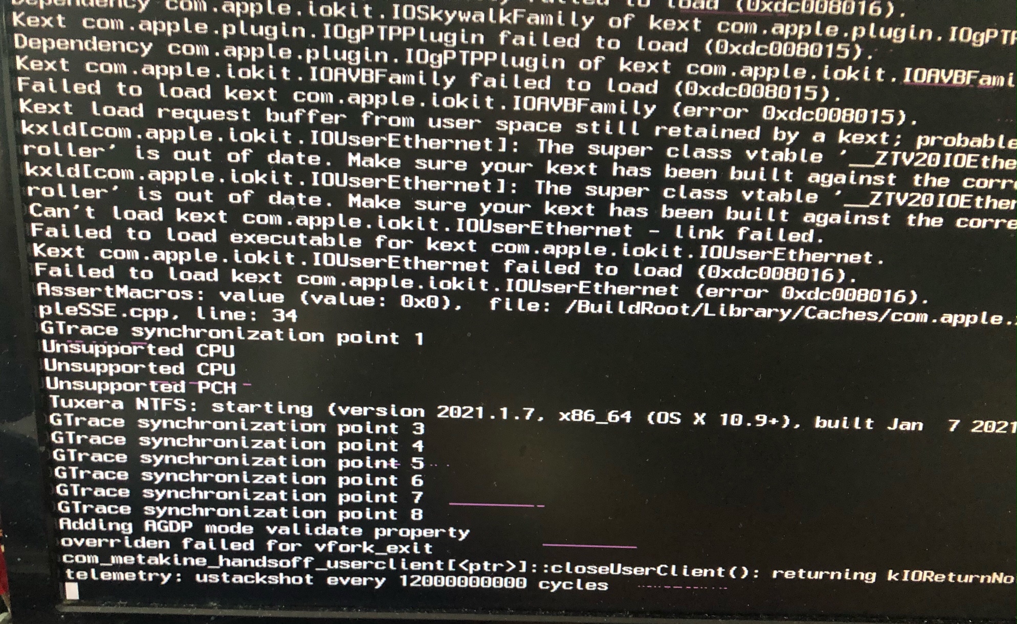

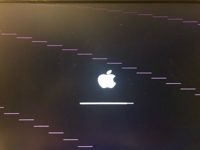

jimiz Posted April 15, 2021 Author Share Posted April 15, 2021 (edited) thanks , but no way... I just try to clean the nvram from clover (usb mojave boot) with F11....but result is always thesome !! I just try now your way... step 1 and 2... nothing to do... 3/4 of load...PURPLE line...slow loading...and black screen... really not black...you see a dark gray...you see also the cursor black... you can move, but nothing another, and few secondo later also no cursor. Il like a problem of GFX with CSM ....only I just disable from bios...and no another options. is really to cry!!! i have all my works on mojave...and now i can never start again!!! also ifI made the clone tima ago , for disasters like that...!!! bios of MB I just, cmos reset, also today out the battery... nothing change. Is only the RX580, but... can be the bios of this changed for opencore installation?!? any idea what can I try ?? Edited April 15, 2021 by jimiz Link to comment https://www.insanelymac.com/forum/topic/347430-big-crazy-mistery-about-bigsur-installation-contaminated-bios-mb/#findComment-2755695 Share on other sites More sharing options...

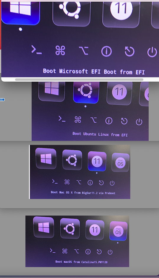

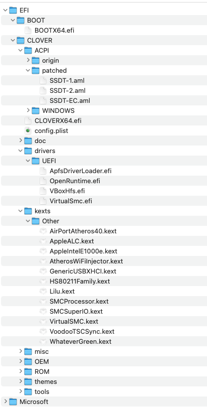

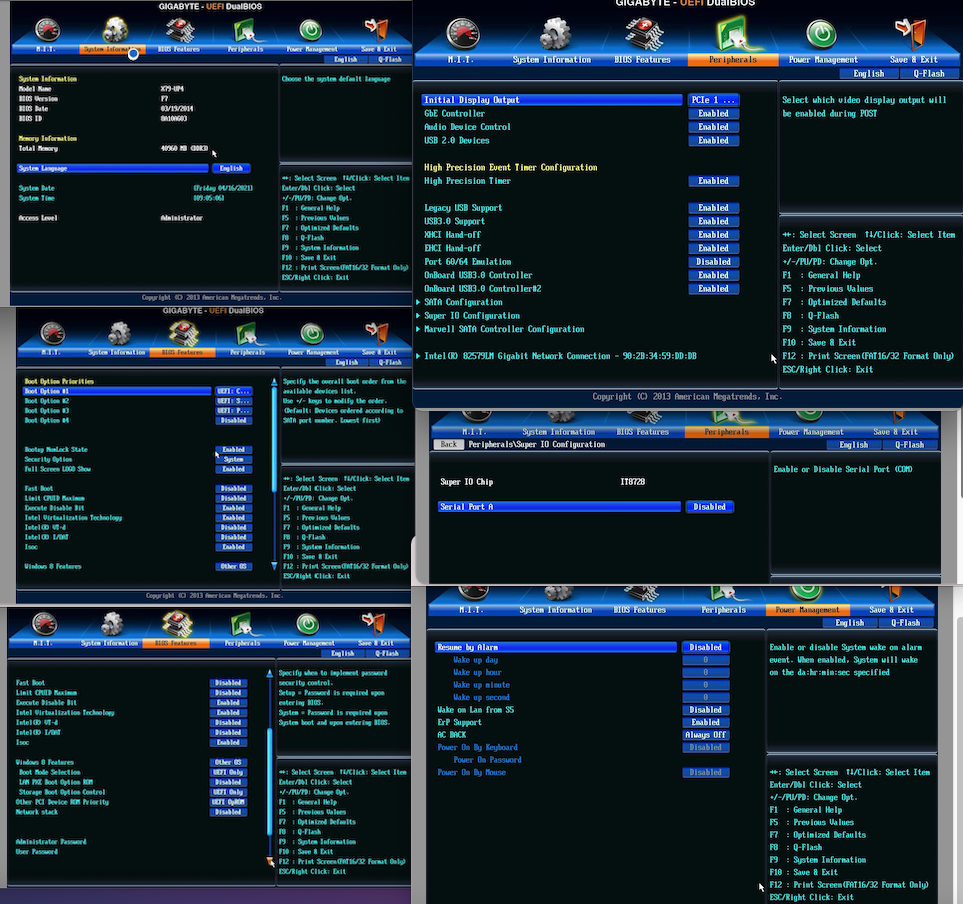

cmn699 Posted April 17, 2021 Share Posted April 17, 2021 (edited) If it can be of any help , you can compare the BIOS options, CLOVER contents (UEFI drivers, Kexts) I had used CLOVER Boot Menu Screen, and About This Mac screen shots from my system with GA-X79-UP4 . Edited April 17, 2021 by cmn699 Duplicate 1 Link to comment https://www.insanelymac.com/forum/topic/347430-big-crazy-mistery-about-bigsur-installation-contaminated-bios-mb/#findComment-2755809 Share on other sites More sharing options...
jimiz Posted April 17, 2021 Author Share Posted April 17, 2021 19 hours ago, cmn699 said: If it can be of any help , you can compare the BIOS options, CLOVER contents (UEFI drivers, Kexts) I had used CLOVER Boot Menu Screen, and About This Mac screen shots from my system with GA-X79-UP4 . CAN you post here your EFI ? I will try to start BIG SUR with your efi.... I have different chip set for LAN, but...this I can try to change... thanks!!! Link to comment https://www.insanelymac.com/forum/topic/347430-big-crazy-mistery-about-bigsur-installation-contaminated-bios-mb/#findComment-2755850 Share on other sites More sharing options...
cmn699 Posted April 18, 2021 Share Posted April 18, 2021 18 hours ago, jimiz said: CAN you post here your EFI ? I will try to start BIG SUR with your efi.... I have different chip set for LAN, but...this I can try to change... thanks!!! I wanted to upload my EFI as a zipped file. But because of the size limitation of 10MB, even when zipped, I cannot upload that here. Using the images I have posted you may be able to get all the kexts and drivers to download from public sources. You may even be lucky enough to get SSDTs for your MoBo if you look around. I am sorry I tried but unable to walk that extra mile because of road blocks. Link to comment https://www.insanelymac.com/forum/topic/347430-big-crazy-mistery-about-bigsur-installation-contaminated-bios-mb/#findComment-2755884 Share on other sites More sharing options...
cmn699 Posted April 18, 2021 Share Posted April 18, 2021 18 hours ago, jimiz said: CAN you post here your EFI ? I will try to start BIG SUR with your efi.... I have different chip set for LAN, but...this I can try to change... thanks!!! Here is an edited lean version of EFI you may try that won't have my config.plist , themes and some MISC files I use for my system EFI.zip 1 Link to comment https://www.insanelymac.com/forum/topic/347430-big-crazy-mistery-about-bigsur-installation-contaminated-bios-mb/#findComment-2755886 Share on other sites More sharing options...
