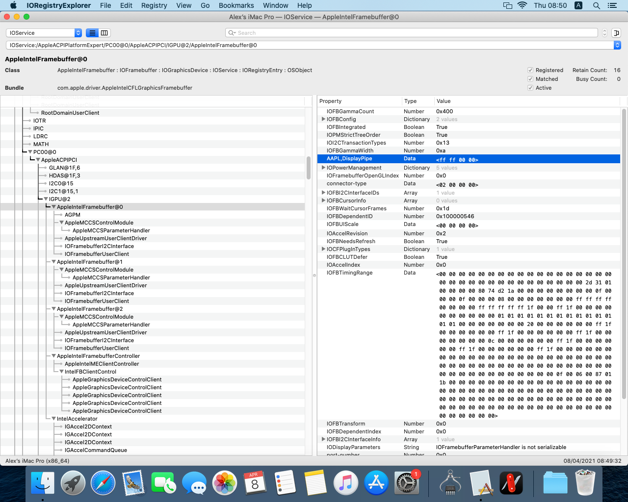

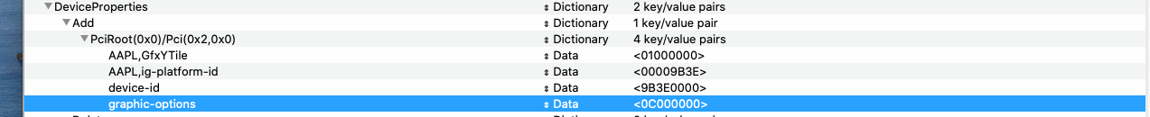

rockhard301 Posted April 7, 2021 Share Posted April 7, 2021 (edited) Hello everyone I had the bad idea to build a new system with the new z590 mobo + i5 10400 and I can't make the iGPU UHD 630 to work, I tried every device id and method know in my 8 years of hackintosh, the best I was able to do it was able to boot with display output and showing 14mb vram. The same CPU paired with an Z490 worked fine showing hardware acceleration. If I boot with the correct iGPU device injection 07009B3E and device id 9B3E0000 the system boot with a black screen and when I connect remotely I can see in the IORegistry that the iGPU didnt recognized the display and the display pipe is show zero. My build: Asus Z490M Prime-Plus, i5 10400, 8 GB DDR3 3200Mhz, it has 3 video output : DP,HDMI and DVI and I am using Open Core. I attached my IOReg and ACPI dump. Maybe someone have an idea how to patch this new mobo and make the iGPU output to work. ACPI.zip Edited April 7, 2021 by rockhard301 Typo Quote Link to comment https://www.insanelymac.com/forum/topic/347322-new-asus-z590-prime-plus-uhd-630-no-igpu-output/ Share on other sites More sharing options...
miliuco Posted April 7, 2021 Share Posted April 7, 2021 (edited) 39 minutes ago, rockhard301 said: Hello everyone I had the bad idea to build a new system with the new z590 mobo + i5 10400 and I can't make the iGPU UHD 630 to work, I tried every device id and method know in my 8 years of hackintosh, the best I was able to do it was able to boot with display output and showing 14mb vram. The same CPU paired with an Z490 worked fine showing hardware acceleration. If I boot with the correct iGPU device injection 07003E9B and device id 9B3E0000 the system boot with a black screen and when I connect remotely I can see in the IORegistry that the iGPU didnt recognized the display and the display pipe is show zero. My build: Asus Z490M Prime-Plus, i5 10400, 8 GB DDR3 3200Mhz, it has 3 video output : DP,HDMI and DVI and I am using Open Core... Please complete your signature (user profile) with the data of your machine. You say "iGPU device injection 07003E9B" but it isn't 07009B3E instead of 07003E9B as AAPL,ig-platform-id? I think device-id is not necessary, I'm not sure. Do you have you framebuffer-patch-enable Data 01000000 and framebuffer-stolenmem Data 00003001 in config.plist? Edited April 7, 2021 by miliuco Quote Link to comment https://www.insanelymac.com/forum/topic/347322-new-asus-z590-prime-plus-uhd-630-no-igpu-output/#findComment-2754914 Share on other sites More sharing options...
rockhard301 Posted April 7, 2021 Author Share Posted April 7, 2021 (edited) 2 hours ago, miliuco said: Please complete your signature (user profile) with the data of your machine. You say "iGPU device injection 07003E9B" but it isn't 07009B3E instead of 07003E9B as AAPL,ig-platform-id? I think device-id is not necessary, I'm not sure. Do you have you framebuffer-patch-enable Data 01000000 and framebuffer-stolenmem Data 00003001 in config.plist? Thank you very much for the reply. It was a typo... and Yes I tried different patches from whatevergreen documentation and also using headless injection. AAPL,ig-platform-id tried: 07009B3E, 00009B3E, 0000923E,0000A53E. The same ones works on my old Z490 but not on the new Z590. I think there's work to be done mapping the connectors. There's an app called Hackintool that does it easily but no luck. I can remotely connect to the mac because the video output is not working. If I remove the device properties injection it boots with video output but without hardware acceleration and 14 mb vram. Edited April 7, 2021 by rockhard301 Typo 1 Quote Link to comment https://www.insanelymac.com/forum/topic/347322-new-asus-z590-prime-plus-uhd-630-no-igpu-output/#findComment-2754940 Share on other sites More sharing options...

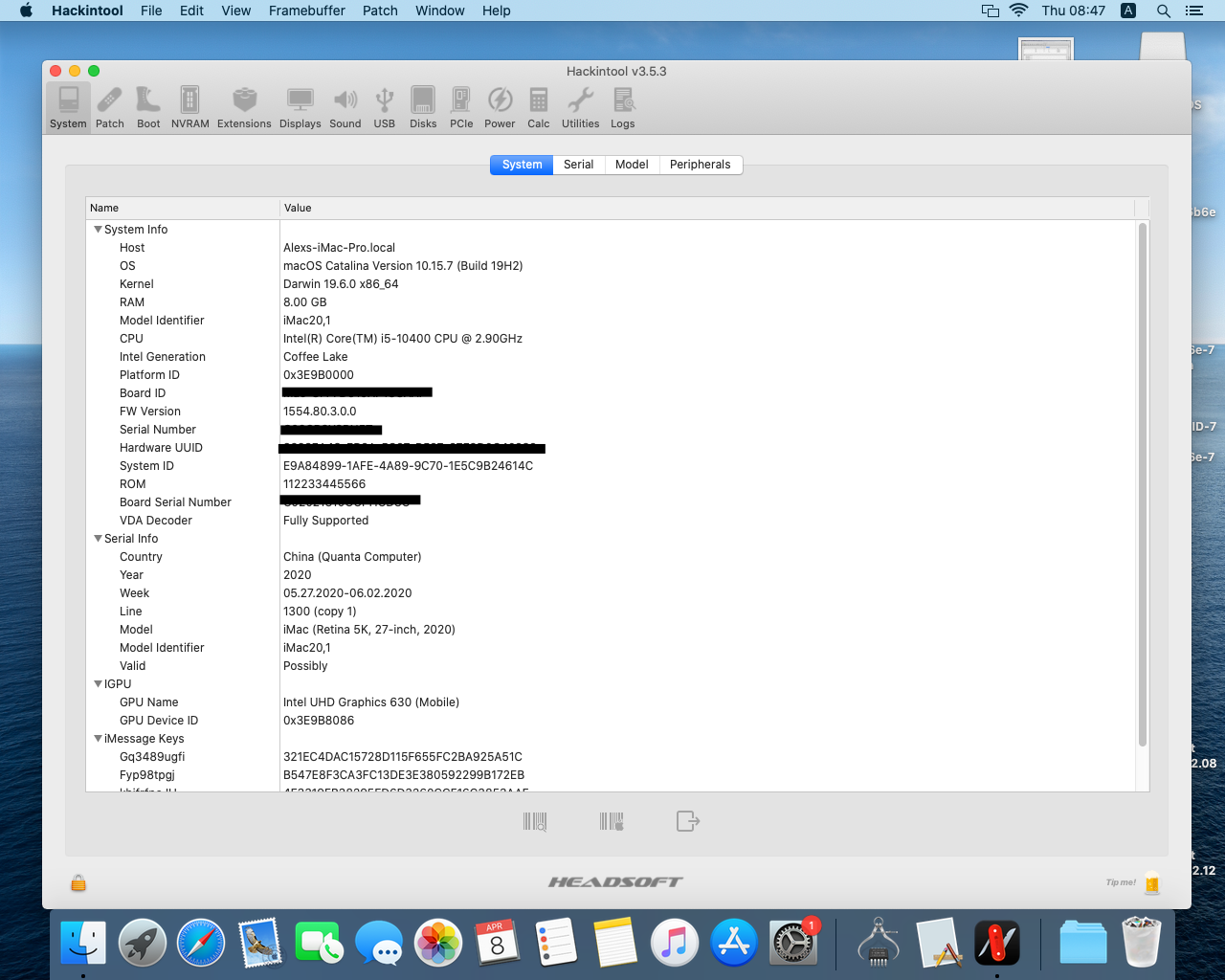

rockhard301 Posted April 8, 2021 Author Share Posted April 8, 2021 (edited) I updated the motherboard with a new bios and OpenCore to 0.6.8 and the same situation. Using screen sharing I can see that the video decoder is fully supported. No luck with other ids from that link. . Edited April 8, 2021 by rockhard301 typo 1 Quote Link to comment https://www.insanelymac.com/forum/topic/347322-new-asus-z590-prime-plus-uhd-630-no-igpu-output/#findComment-2754964 Share on other sites More sharing options...
