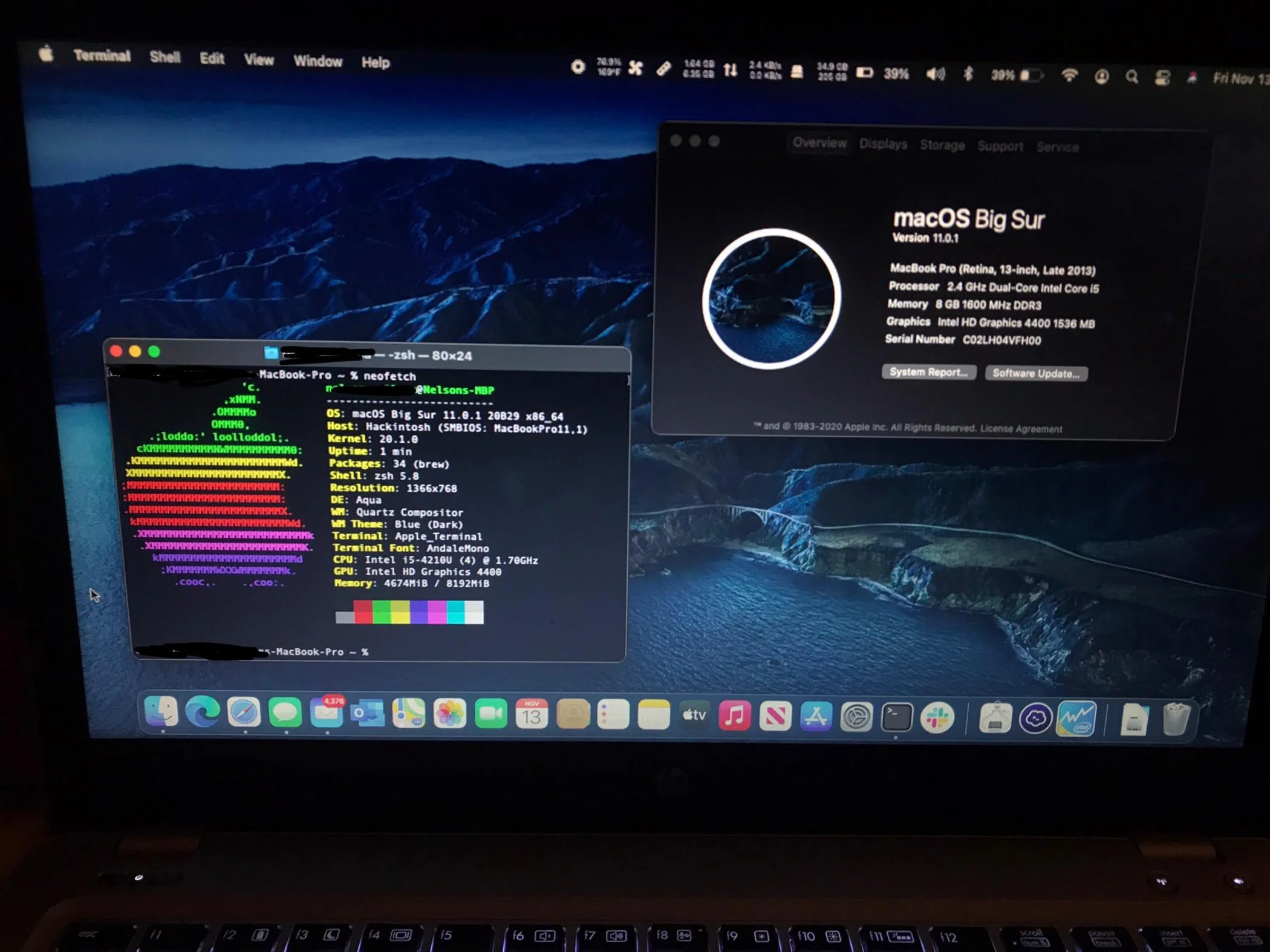

Hinata Posted April 5, 2021 Share Posted April 5, 2021 (edited) Hello everyone,, Decided to just toss my Catalina EFI onto a OC 0.6.3 + Big Sur USB and it booted right up!(OC GUI and Chime!) Will admit though, I installed on a different SSD incase things hadn't worked https://mobdro.bio/ https://kodi.bio/. CPU: Intel i5-4210U GPU: Intel HD Graphics 4400 RAM: 8GB 1600Mhz DDR3 Audio Codec: ALC280 Make and Model: HP EliteBook Folio 9480m Ethernet Card: Intel I218LM PCI Express Gigabit Ethernet Wifi/BT card: AC7260 TouchPad: Synaptics PS/2 Touchpad/TouchStyk Guide used: OpenCore Vanilla Guide(Laptop[Haswell]) Working: - iServices - DRM - Wifi AND BT - battery stats - Keyboard and touchpad(as mouse) - USB ports -brightness control/audio -restart and shutdown correctly -Camera/Mic - Everything else I forgot Not working: - Intel Power Gadget. Complains about MacOS behaving badly but fix doesn't work. Any help on this would be greatly appreciated! Edited April 6, 2021 by Hinata Quote Link to comment https://www.insanelymac.com/forum/topic/347281-successful-upgrade-from-catalina-to-big-surclean-install-on-a-hp-elitebook-9480m/ Share on other sites More sharing options...
