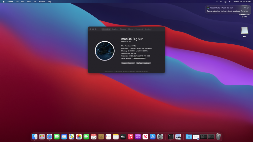

osx151212 Posted March 26, 2021 Share Posted March 26, 2021 (edited) Hello, 'Big Sur' successfully installed on a computer of following configuration Computer: ----------------------- MB: P7H55M-LX CPU: X3470 (Nehalem) VC: NVidia Geforce GTX760 2GB RAM: 8GB HDD: ST3500414SC (500GB) OpenCore: 0.6.7 SMBIOS: MacPro6,1 SMBIOS was generated with GenSMBIOS and result integrated into config.plist file ####################################################### # MacPro6,1 SMBIOS Info # ####################################################### Type: MacPro6,1 Serial: F5KSH3Y7F9VM Board Serial: F5K640403GUFHDDA8 SmUUID: 1C789E6A-8E4D-49D1-957E-04F7AD1D4000 Please generate a new serial number and integrate into config.plist file or manually or with an assistance of ProperTree. File config.plist has NVRAM msu-product-url data integrated in for installation partition, which should be modified to match with yours partition UUID, please see attached perl script uuid_disk.pl to recreate value for your system. It should be sufficient to drop EFI folder in proper location of your USB/HDD boot drive (for a test start from USB drive and once confirmed copy to HDD). EFI folder for this configuration is attached to the post. NOTE: CPU x3470 (Nehalem) lacks support for RDRAND command, due this reason a driver OpenHfsPlus.efi was replaced with HfsPlusLegacy.efi NOTE: Currently sound (VT1708s) does not work in Big Sur with VoodooHDA.kext from Catalina - the issue is under investigation. NOTE:uuid_disk.pl script can be run in any of following forms uuid_disk.pl -h uuid_disk.pl -m uuid_disk.pl -u A6F75FD3-9288-485F-B13F-F3BDD465C65F uuid_disk.pl -v 'Big Sur' uuid_disk.pl -m '/Volumes/Big Sur' uuid_disk.pl -i disk1s7 uuid_disk.pl -n /dev/disk1s7 osx151212 EFI.zip GenSMBIOS-master.zip uuid_disk.pl Edited March 26, 2021 by osx151212 3 Link to comment https://www.insanelymac.com/forum/topic/347166-p7h55m-lx-big-sur-installation-opencore/ Share on other sites More sharing options...
