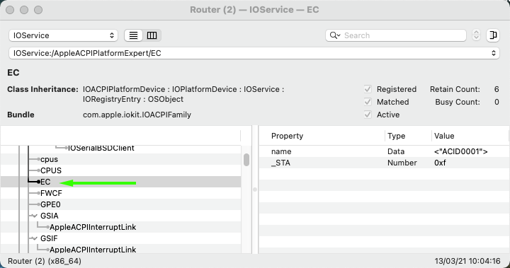

EC device is injected properly:
Spoiler

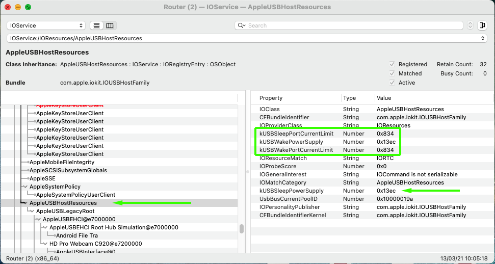

I can see the usb properties injected in AppleUSBHostResources:
Spoiler

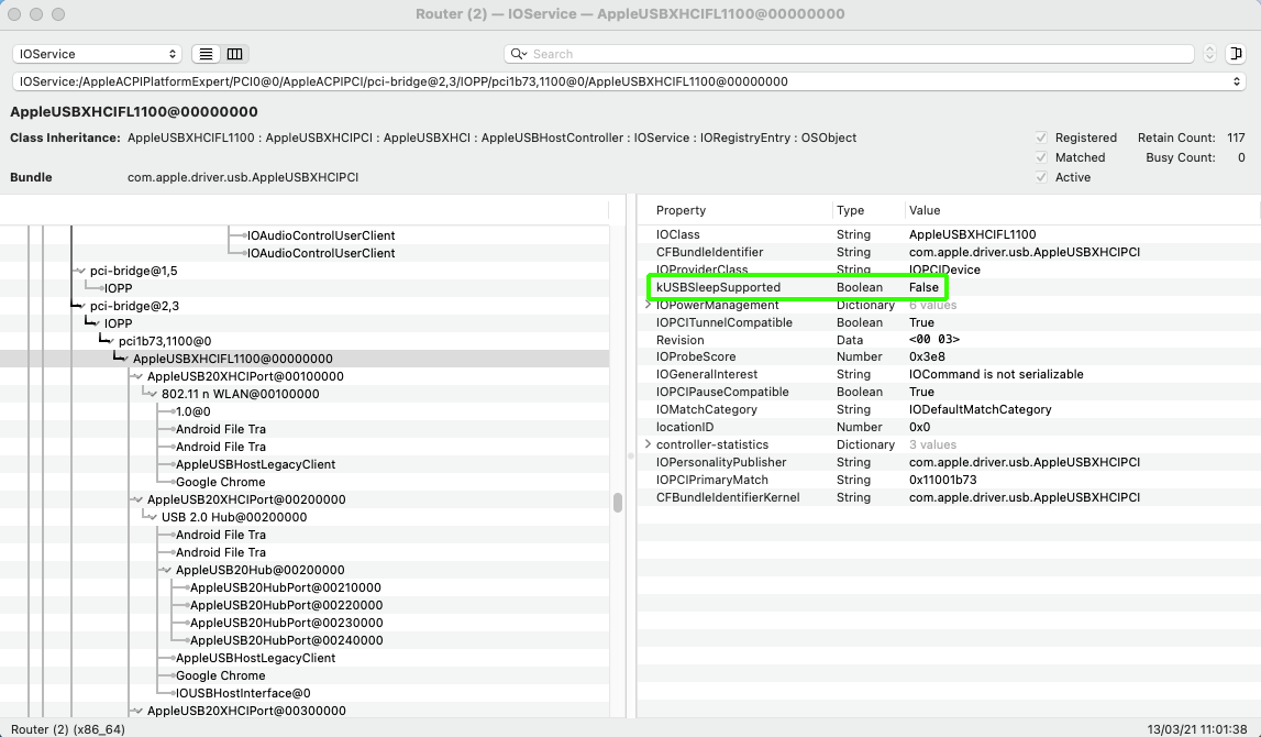

Now, if I look at the ioregistry tree for the fresco logic, first thing that doesn't looks good is kUSBSleepSupported=false:
Spoiler

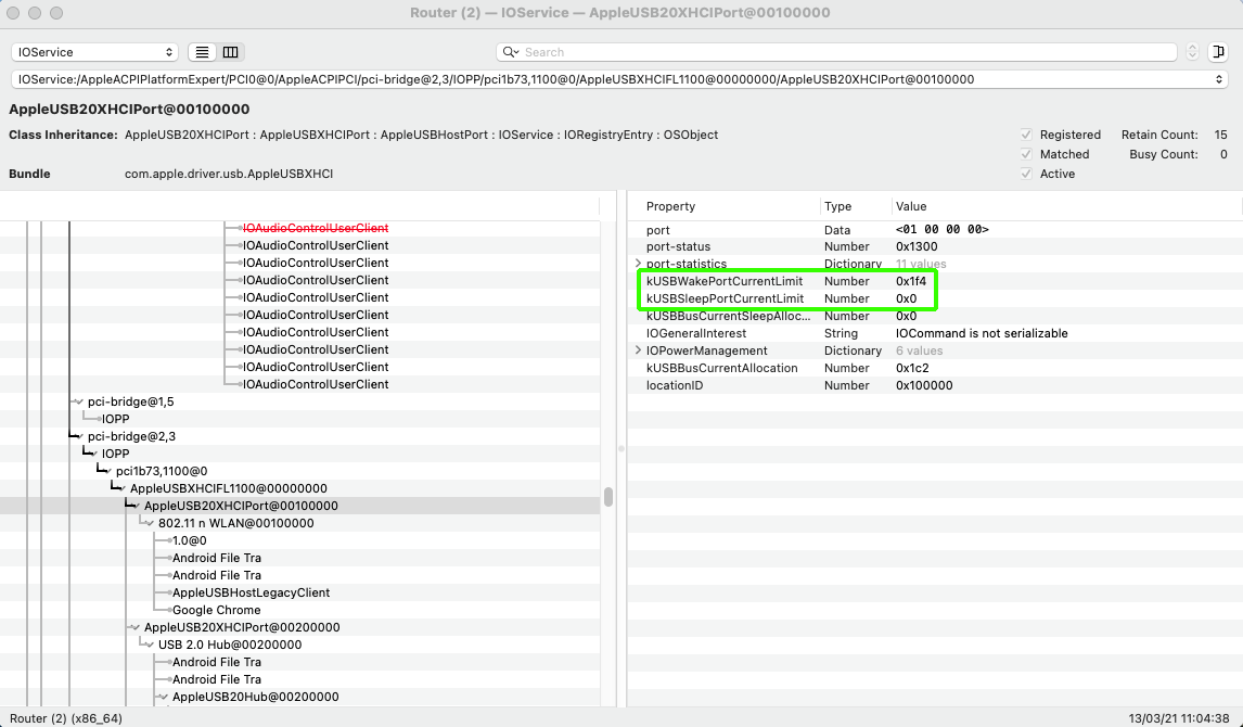

Moreover the usb properties here don't look correct...:
Spoiler
Anybody knows what's wrong here?
Thank you for your attention.

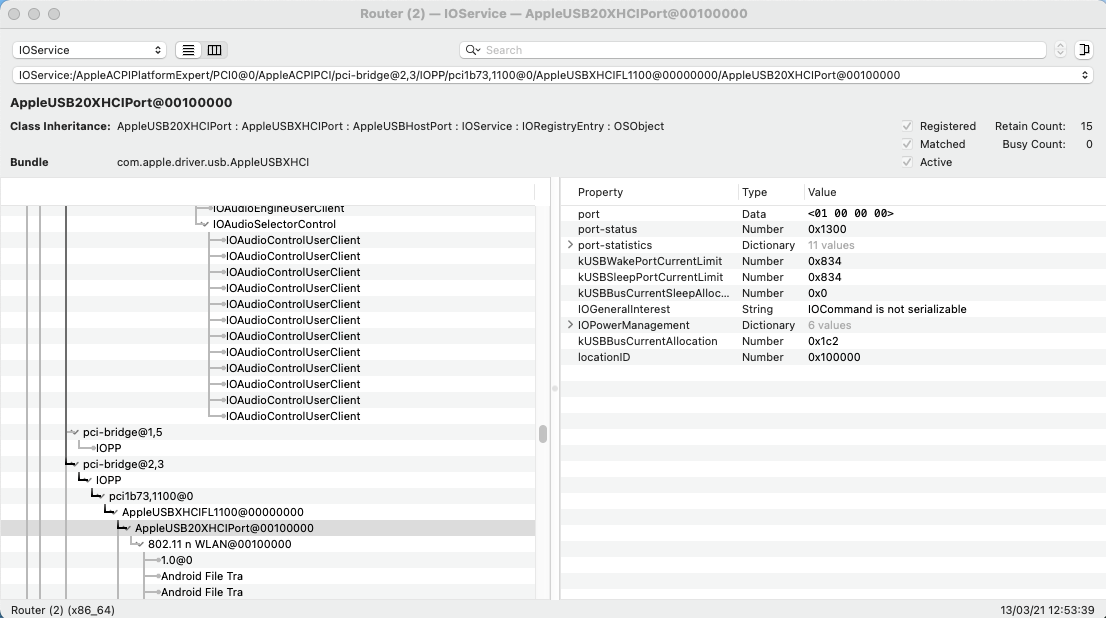

EDIT: ok, I think I fixed the issue with an injector kext, including all controllers, now:
Spoiler
Attached also the injector kext for my Fresco only as an example.
Hope is all good now..
