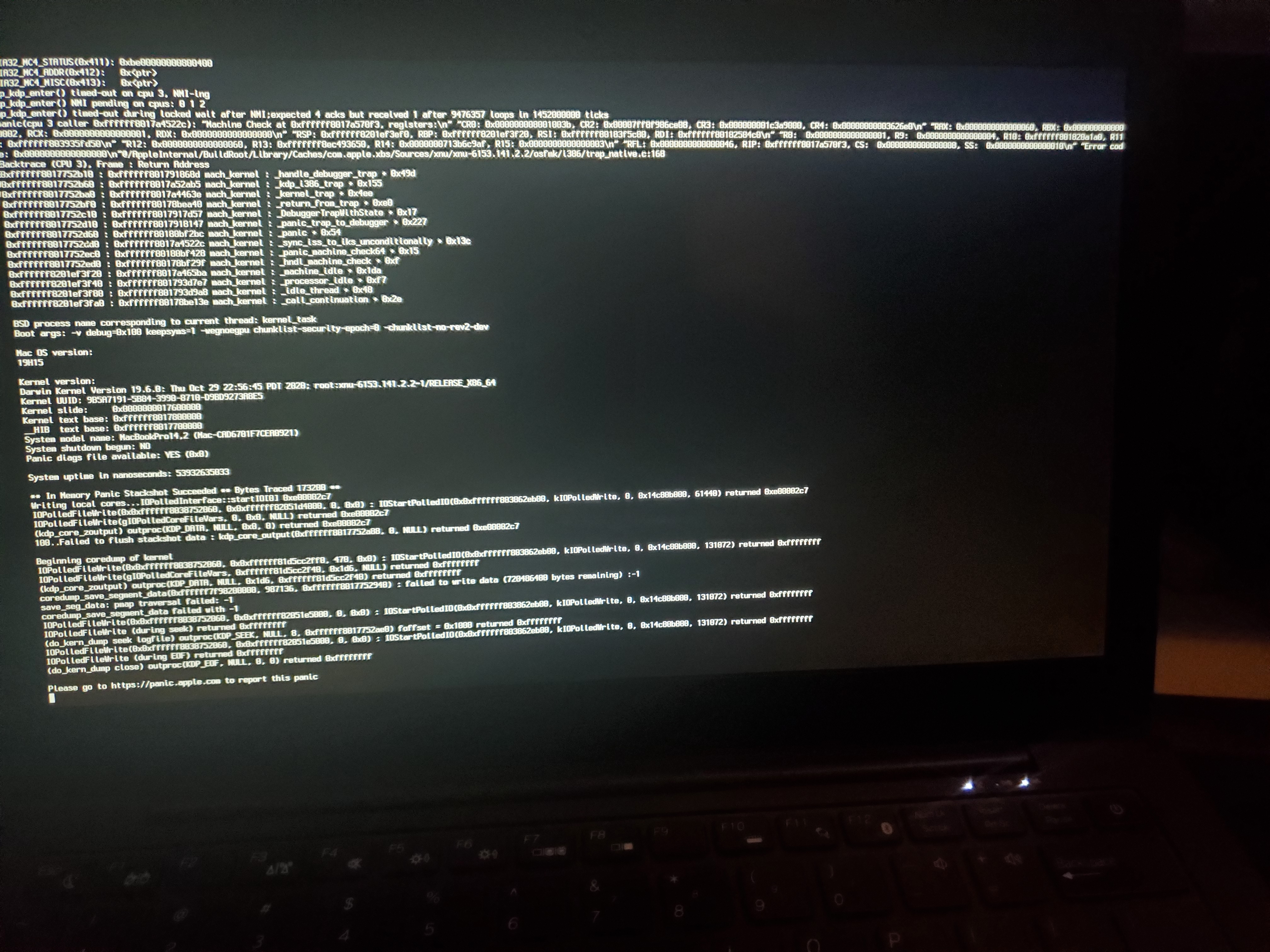

Minist3r Posted March 14, 2021 Share Posted March 14, 2021 Processor: Intel Core i7 6500U (Skylake) Intel HD Graphics 620 Can anyone help me with this issue I was able to boot into installer fine but once I tried booting the OS Catalina it panics. Quote Link to comment https://www.insanelymac.com/forum/topic/347020-purism-librem-13-laptop-opencore-kernel-panic-help/ Share on other sites More sharing options...

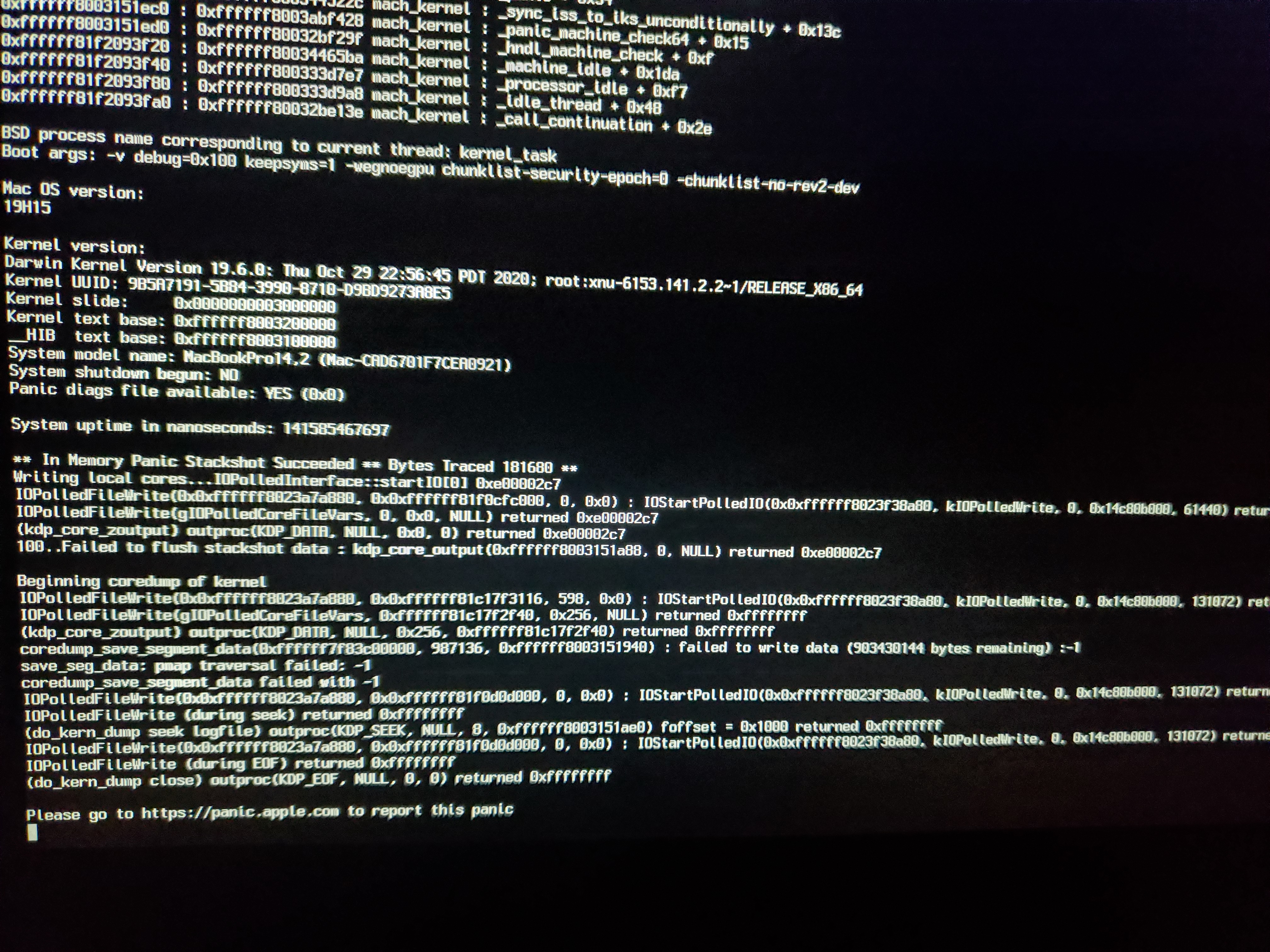

Avery B Posted March 14, 2021 Share Posted March 14, 2021 Can you show the entire screen? Specifically the stacktrace and everything above it. I'm guessing it's a duplicated kext possibly, but it's nearly impossible to tell without knowing where you are in the boot process. Quote Link to comment https://www.insanelymac.com/forum/topic/347020-purism-librem-13-laptop-opencore-kernel-panic-help/#findComment-2753075 Share on other sites More sharing options...

Avery B Posted March 15, 2021 Share Posted March 15, 2021 From what I've seen (talking with some other people as well), NMI is usually related to hardware - especially RAM. Could not like the timings or something weird (I've found macOS to be more sensitive to slightly unstable RAM) Could also try CpuTSCSync.kext I've also seen the panic when messing with ACPI, though it was on an old Core 2 system and I forgot what I did that caused it. It could honestly be a lot of things unfortunately, and this error is one I haven't really seen much before. Quote Link to comment https://www.insanelymac.com/forum/topic/347020-purism-librem-13-laptop-opencore-kernel-panic-help/#findComment-2753125 Share on other sites More sharing options...
