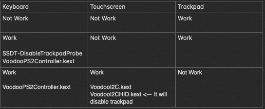

kaleaves Posted March 12, 2021 Author Share Posted March 12, 2021 Let me state more clear. I've tried different combination and turn out the following result. Photo 1 Also below is my laptop input spec ubuntu@ubuntu:~$ dmesg |grep -i 'input' [ 0.617790] input: Lid Switch as /devices/LNXSYSTM:00/LNXSYBUS:00/PNP0C0D:00/input/input0 [ 0.617868] input: Power Button as /devices/LNXSYSTM:00/LNXSYBUS:00/PNP0C0C:00/input/input1 [ 0.617918] input: Sleep Button as /devices/LNXSYSTM:00/LNXSYBUS:00/PNP0C0E:00/input/input2 [ 0.617959] input: Power Button as /devices/LNXSYSTM:00/LNXPWRBN:00/input/input3 [ 0.713073] input: AT Translated Set 2 keyboard as /devices/platform/i8042/serio0/input/input4 [ 1.149910] input: Video Bus as /devices/LNXSYSTM:00/LNXSYBUS:00/PNP0A08:00/LNXVIDEO:00/input/input5 [ 1.457642] input: WCOM484D:00 056A:484D Touchscreen as /devices/pci0000:00/0000:00:15.1/i2c_designware.1/i2c-5/i2c-WCOM484D:00/0018:056A:484D.0001/input/input6 [ 1.459203] input: WCOM484D:00 056A:484D as /devices/pci0000:00/0000:00:15.1/i2c_designware.1/i2c-5/i2c-WCOM484D:00/0018:056A:484D.0001/input/input7 [ 1.460933] input: WCOM484D:00 056A:484D as /devices/pci0000:00/0000:00:15.1/i2c_designware.1/i2c-5/i2c-WCOM484D:00/0018:056A:484D.0001/input/input8 [ 1.461329] input: WCOM484D:00 056A:484D as /devices/pci0000:00/0000:00:15.1/i2c_designware.1/i2c-5/i2c-WCOM484D:00/0018:056A:484D.0001/input/input9 [ 1.461721] input: WCOM484D:00 056A:484D Mouse as /devices/pci0000:00/0000:00:15.1/i2c_designware.1/i2c-5/i2c-WCOM484D:00/0018:056A:484D.0001/input/input10 [ 1.462152] hid-generic 0018:056A:484D.0001: input,hidraw0: I2C HID v1.00 Mouse [WCOM484D:00 056A:484D] on i2c-WCOM484D:00 [ 1.694046] input: Wacom HID 484D Pen as /devices/pci0000:00/0000:00:15.1/i2c_designware.1/i2c-5/i2c-WCOM484D:00/0018:056A:484D.0001/input/input11 [ 1.694353] input: Wacom HID 484D Finger as /devices/pci0000:00/0000:00:15.1/i2c_designware.1/i2c-5/i2c-WCOM484D:00/0018:056A:484D.0001/input/input12 [ 1.872555] input: Alps Alps Touchpad Mouse as /devices/pci0000:00/0000:00:14.0/usb1/1-2/1-2:1.0/0003:044E:1218.0002/input/input14 [ 1.872954] input: Alps Alps Touchpad as /devices/pci0000:00/0000:00:14.0/usb1/1-2/1-2:1.0/0003:044E:1218.0002/input/input15 [ 1.873320] input: Alps Alps Touchpad as /devices/pci0000:00/0000:00:14.0/usb1/1-2/1-2:1.0/0003:044E:1218.0002/input/input16 [ 1.873726] hid-generic 0003:044E:1218.0002: input,hiddev0,hidraw1: USB HID v1.11 Mouse [Alps Alps Touchpad] on usb-0000:00:14.0-2/input0 [ 187.570485] input: Intel HID events as /devices/platform/INT33D5:00/input/input17 [ 187.571836] input: Intel HID 5 button array as /devices/platform/INT33D5:00/input/input18 [ 187.655238] input: Intel Virtual Button driver as /devices/pci0000:00/0000:00:1f.0/PNP0C09:00/INT33D6:00/input/input19 [ 188.023990] input: Alps Alps Touchpad Mouse as /devices/pci0000:00/0000:00:14.0/usb1/1-2/1-2:1.0/0003:044E:1218.0002/input/input20 [ 188.027023] input: Alps Alps Touchpad as /devices/pci0000:00/0000:00:14.0/usb1/1-2/1-2:1.0/0003:044E:1218.0002/input/input21 [ 188.027095] input: Alps Alps Touchpad UNKNOWN as /devices/pci0000:00/0000:00:14.0/usb1/1-2/1-2:1.0/0003:044E:1218.0002/input/input22 [ 188.027172] hid-multitouch 0003:044E:1218.0002: input,hiddev0,hidraw1: USB HID v1.11 Mouse [Alps Alps Touchpad] on usb-0000:00:14.0-2/input0 [ 188.049974] input: Dell WMI hotkeys as /devices/platform/PNP0C14:00/wmi_bus/wmi_bus-PNP0C14:00/9DBB5994-A997-11DA-B012-B622A1EF5492/input/input23 [ 188.545103] snd_hda_codec_realtek hdaudioC0D0: inputs: [ 188.613622] input: HDA Intel PCH Headphone as /devices/pci0000:00/0000:00:1f.3/sound/card0/input24 [ 188.613664] input: HDA Intel PCH HDMI/DP,pcm=3 as /devices/pci0000:00/0000:00:1f.3/sound/card0/input25 [ 188.613693] input: HDA Intel PCH HDMI/DP,pcm=7 as /devices/pci0000:00/0000:00:1f.3/sound/card0/input26 [ 188.613729] input: HDA Intel PCH HDMI/DP,pcm=8 as /devices/pci0000:00/0000:00:1f.3/sound/card0/input27 [ 188.613766] input: HDA Intel PCH HDMI/DP,pcm=9 as /devices/pci0000:00/0000:00:1f.3/sound/card0/input28 [ 188.613802] input: HDA Intel PCH HDMI/DP,pcm=10 as /devices/pci0000:00/0000:00:1f.3/sound/card0/input29 [ 352.502585] rfkill: input handler disabled Btw I tried your method still not work. thx for your reply Quote Link to comment https://www.insanelymac.com/forum/topic/346924-i-can-only-use-either-trackpad-or-touchscreen-in-opencore/#findComment-2752996 Share on other sites More sharing options...
Avery B Posted March 12, 2021 Share Posted March 12, 2021 (edited) Ah This is indeed a really weird combination. Interesting that it works over PS2. What attaches when using VoodooPS2? VoodooPS2Mouse/VoodooPS2TrackpadSynaptics/Alps/Elans? This may honestly be a question for the people at the VoodooI2C gitter to see if they can do anything about it. Another option could be to try and edit VoodooI2CHID.kext/Contents/Info.plist to see if you can get it to not attach - I'm fairly certain you'd want to get rid of "IOKitPersonalities->VoodooI2CHIDDevice Touchscreen HID Event Driver", though there is a lot of personalities listed and I'm honestly not sure what pairs to what functionality. Edit: You could take a look at this repo as well, it may work with your trackpad: https://github.com/blankmac/AlpsT4USB Edited March 12, 2021 by 1Revenger1 Quote Link to comment https://www.insanelymac.com/forum/topic/346924-i-can-only-use-either-trackpad-or-touchscreen-in-opencore/#findComment-2753003 Share on other sites More sharing options...

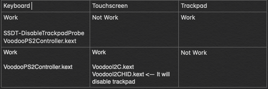

kaleaves Posted March 13, 2021 Author Share Posted March 13, 2021 Sorry table should be like this Quote Link to comment https://www.insanelymac.com/forum/topic/346924-i-can-only-use-either-trackpad-or-touchscreen-in-opencore/#findComment-2753018 Share on other sites More sharing options...
