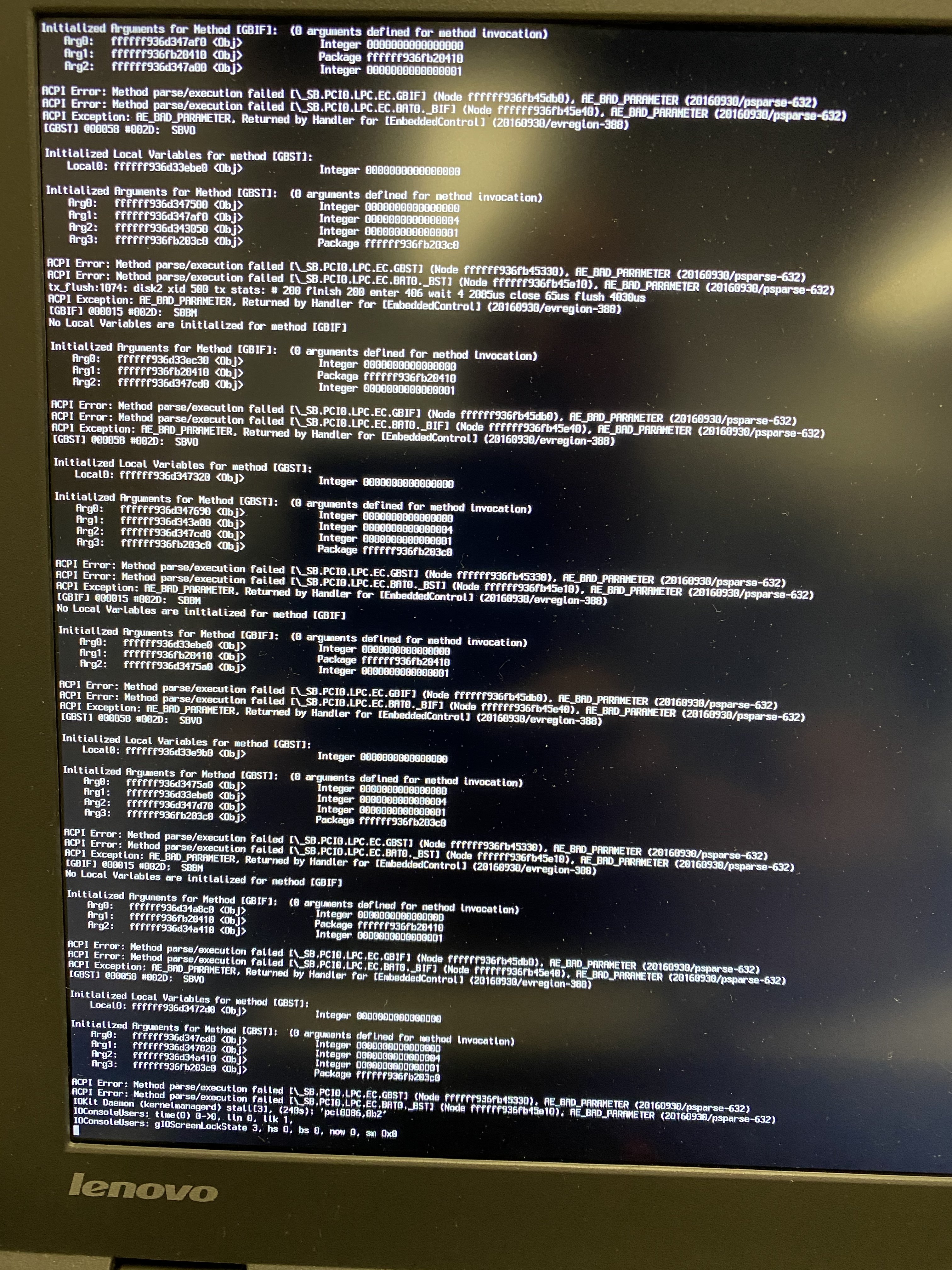

I am trying to install Big Sur on my thinkpad W541 the installation gets past the initial install page and stops at this error I am attaching a screen shot
any help would be greatly appreciated.
Almost there! The last line is normally followed by the OS X graphical boot.
You need to explain which bootloader you're using and how you've configured it.

Thanks for the reply etorix, I am using latest opencore and followed opencore settings via their website I will attach my efi and another
screen shot, I reinstalled again to see if it would load to Os screen left it overnight and found it hanging again.

Thank you both for your replies, so I should use a patched  SSDT-XOSI file in the ACPI
No, there should be a patch in the ACPI>Patch section of OpenCore config.plist so that all OS calls to _OSI() are redirected to XOSI() in the SSDT.

This section allows us to dynamically modify parts of the ACPI (DSDT, SSDT, etc.) via OpenCore. For us, we'll need the following:
  • OSI rename
    • This is required when using SSDT-XOSI as we redirect all OSI calls to this SSDT, this is not needed if you're using SSDT-GPIO
Comment String Change _OSI to XOSI
Enabled Boolean YES
Count Number 0
Limit Number 0
Find Data 5f4f5349
Replace Data 584f5349
The alternative is to use SSDT-GPIO together with VoodooI2C kext, and then not to use SSDT-XOSI. But this probably requires a trip to Linux or Windows in order to precisely identify the trackpad and identify which of the many Voodoo kexts are required.
