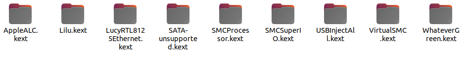

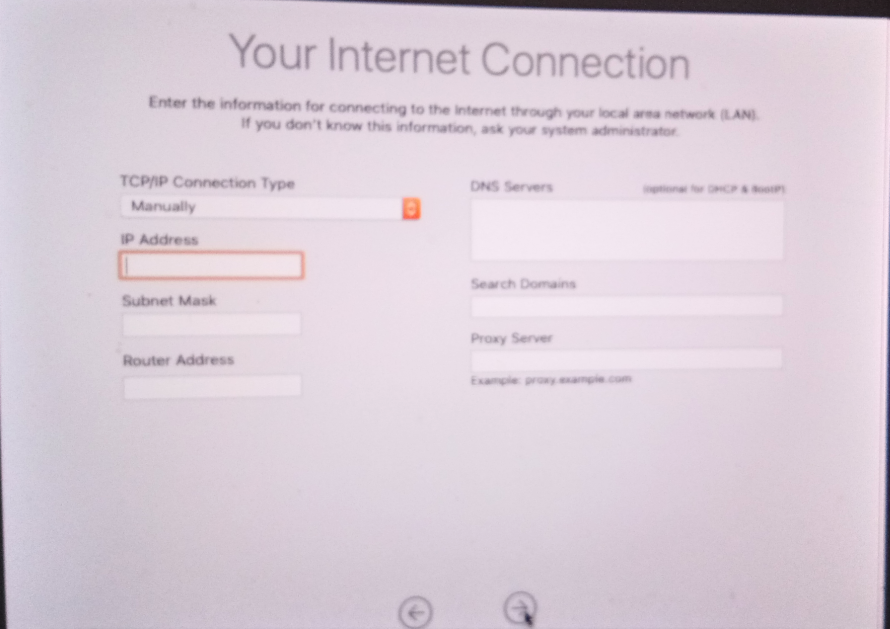

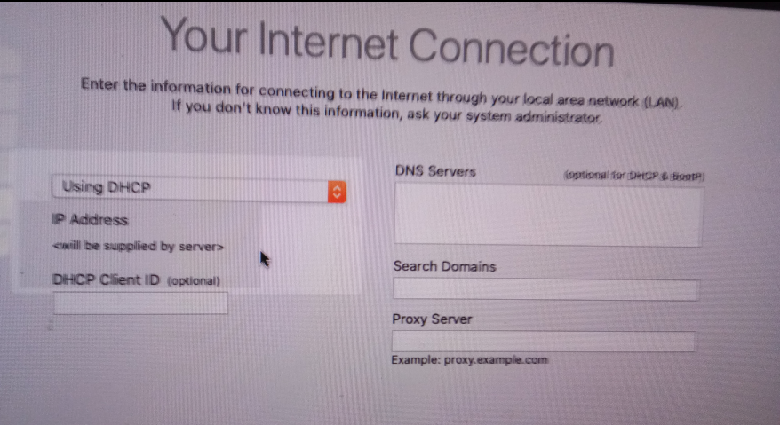

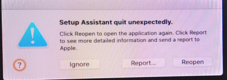

HHDDD Posted February 20, 2021 Share Posted February 20, 2021 i3 10100 Gigabyte H410H M Realtek® GbE LAN chip (1000 Mbit/100 Mbit) getting suck at Your Internet Connection .. given option Manually NOT using DHCP when i attempt to change "Manually" to "using DHCP" then opencore 0.6.5 macOS catalina hangs here are some of the images of the error and plist ..please help Quote Link to comment https://www.insanelymac.com/forum/topic/346763-opencore-macos-catalina-installation-stuck-at-your-internet-connection/ Share on other sites More sharing options...
T0pol Posted February 23, 2021 Share Posted February 23, 2021 LucyRTL8215.kext is for Realtek 2,5 Gbs Ethernet Controller Maybe you'll have more results if you use RealtekRTL8111.kext for 100/1000 Mbit Ethernet Controller Quote Link to comment https://www.insanelymac.com/forum/topic/346763-opencore-macos-catalina-installation-stuck-at-your-internet-connection/#findComment-2751722 Share on other sites More sharing options...
