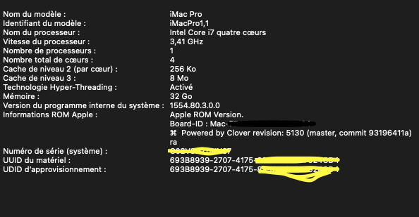

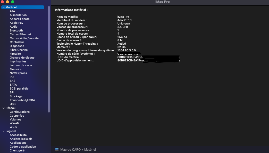

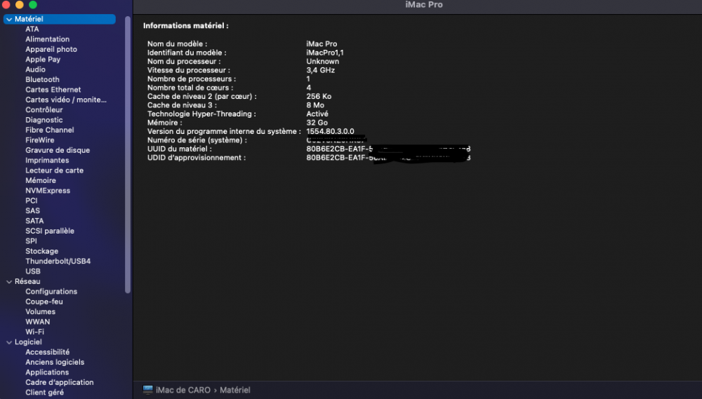

under a 17.1 smbios i had no problem matching the same smbios and its numbers in opencore 0.6.6 and clover 5130.
to solve a DRM problem I switched to iMacPro1,1, and there I cannot match the 2 config.plist, there is a UUID problem.
for me the problem comes from "hardware UUID" it never changes in opencore, even if I renew the smbios with master genSmbios, even when I place the UUID by hand in the open core plist config. when I reboot it displays another uuid while with propertree I see that the change has been saved in the config.plist
everything is equal in the 2 config.plist
serial number
Card number
smUUID
the only thing that changes is this UUID hardware
I have checked in ioreg I am iMacPro 1.1
the thing is, having the same data makes it easier to switch from one bootloader to another, Apple account etc ...
If you have an idea?

ok i found, you have to remove all the things in RtVariables, in clover config.plist, then with the same serial, board serial and UUID, you can switch from one bootloader from an other without icloud activation every time.
