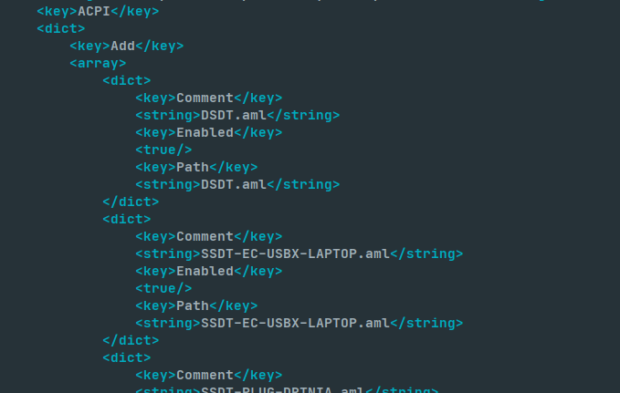

tgbaodeeptry Posted February 4, 2021 Author Share Posted February 4, 2021 23 hours ago, etorix said: No, the laptop knows its DSDT there's no need to add it. Copy it to the computer you work on, open the DSDT with MaciASl and, for each SSDT that your plateform requires, follow the instructions in Dortania's Guide along "The Long Way" to make custom SSDTs for the laptop, with the proper pathing for each ressource. Sorry guy ..., I don't know if what I did is what you wanted. I did: - Firstly, I have followed this video - Then, I copied saved DSDT.aml to ACPI folder - Next, I added DSDT to ACPI/Add in config.plist like this: But it still not working Quote Link to comment https://www.insanelymac.com/forum/topic/346561-cant-boot-into-mojave-because-of-acpi-error-ae_not_exist/#findComment-2750263 Share on other sites More sharing options...
etorix Posted February 4, 2021 Share Posted February 4, 2021 No that's totally useless. And the guide explicitly says NOT to do that. The DSDT describes your hardware. It is used to check how your hardware is presented to the OS, and then make patches (SSDT) to ensure that the hardware is presented in a manner which makes sense for what OS X expects. The default SSDTs try to do that with various common syntaxes, but if your laptop has a quircky DSDT, the required option may not be present in the defaults and you need to make your own SSDTs. If you can't find your way through Dortania's ACPI guides, post the DSDT. 1 Quote Link to comment https://www.insanelymac.com/forum/topic/346561-cant-boot-into-mojave-because-of-acpi-error-ae_not_exist/#findComment-2750270 Share on other sites More sharing options...

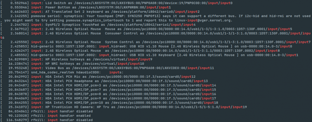

etorix Posted February 5, 2021 Share Posted February 5, 2021 Thanks. Trying to hack a laptop is an interesting experience for me. So from the DSDT the default SSDTs for GPI0 (SBRG=GPEN=One), PLNF (_SB.PCI0.GFX0), PLUG (_PR.PR00) and even SBUS-MCHC (_SB.PCI0.SBUS) should work. The laptop has two Embedded Controllers: _SB.PCI0.LPCB.EC0 (no _STA), _SB.SB.PCI0.LPCB.H_EC (_STA, _HID and _CRS but no _GPE property). In a desktop, both should go. In a laptop I'm unsure if one or both should stay. I'm also unsure about trackpad support. The recommended SSDT is SSDT-GPI0 with VooddoI2C.kext, which has many different plugins and requires detailed hardware specs. Quote To figure out what kind of keyboard and trackpad you have, check Device Manager in Windows or dmesg | grep input in Linux The screenshot in the first post shows a Synaptics TouchPad. Does Windows or Linux reports more details about the protocol it uses? You have used VoodooPS2Controller and the alternative SSDT-XOSI but have not defined the corresponding patchin config.plist—maybe that's just THE issue. 1 Quote Link to comment https://www.insanelymac.com/forum/topic/346561-cant-boot-into-mojave-because-of-acpi-error-ae_not_exist/#findComment-2750358 Share on other sites More sharing options...
tgbaodeeptry Posted February 6, 2021 Author Share Posted February 6, 2021 This is the result after i run this command: sudo dmesg | grep "PS/2" If i run this command: sudo dmesg | grep input This is the result: So I think my keyboard, trackpad, mine are PS/2 devices Quote Link to comment https://www.insanelymac.com/forum/topic/346561-cant-boot-into-mojave-because-of-acpi-error-ae_not_exist/#findComment-2750381 Share on other sites More sharing options...
