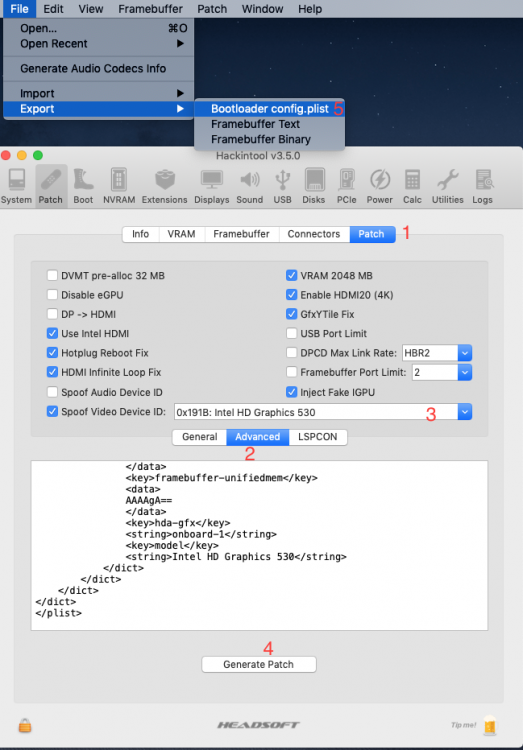

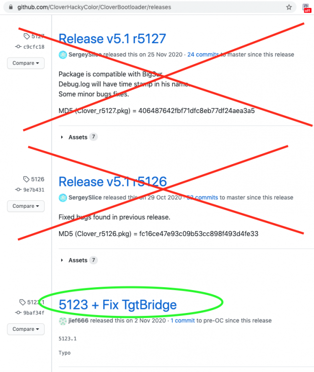

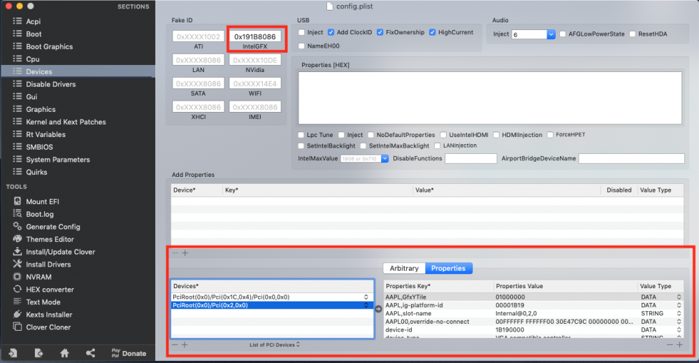

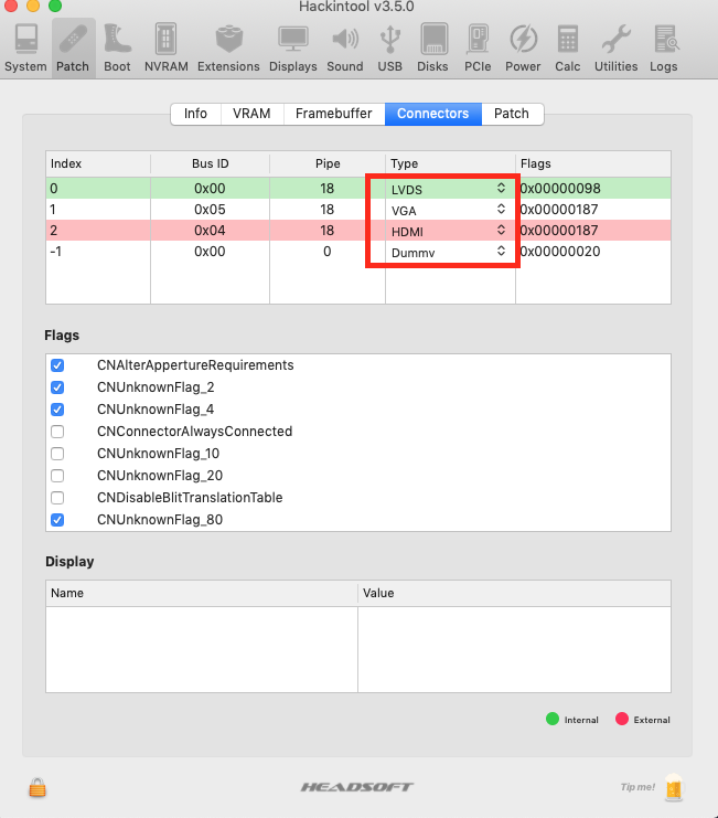

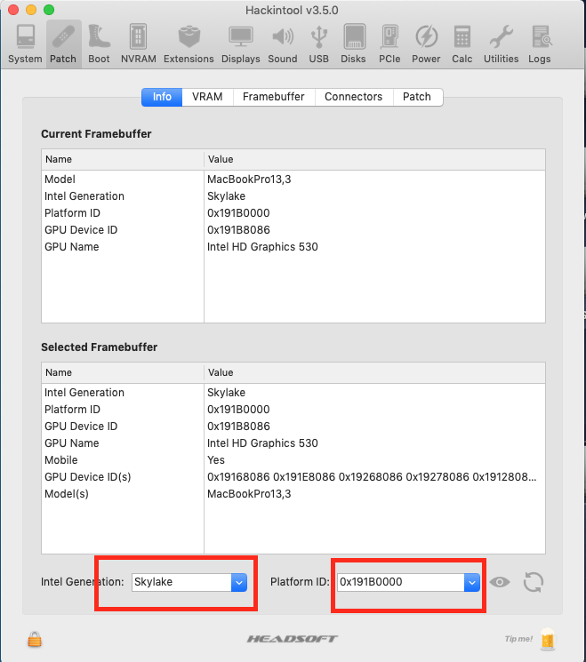

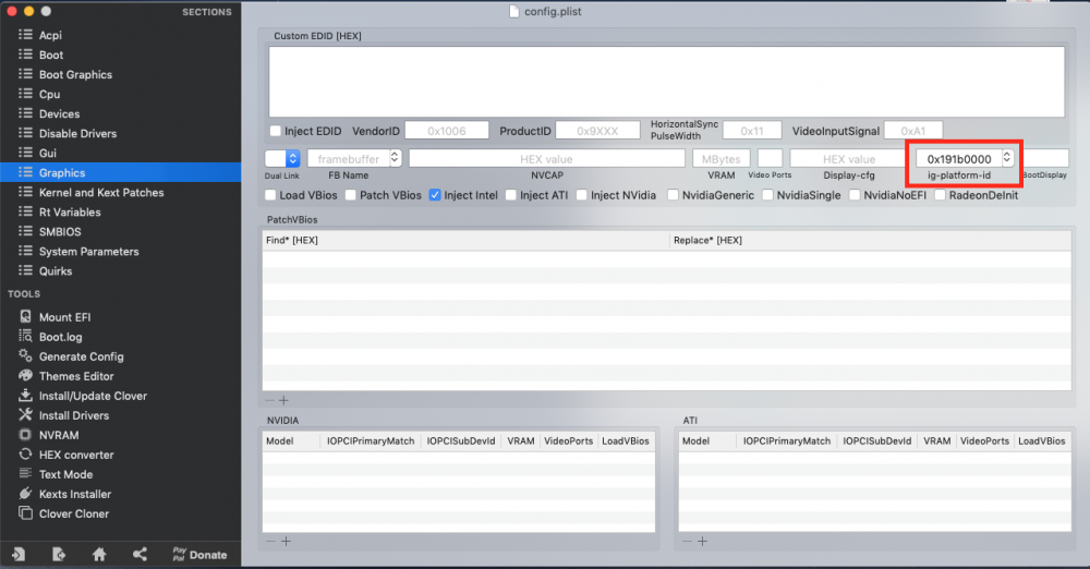

lazzy Posted January 30, 2021 Share Posted January 30, 2021 (edited) CPU: skylake Intel Core i7-6700HQ 2.6-3.5 GHz Model: Gigabyte P15FV5 Memory 16 GB (2 x 8 GB) DDR3-1600 Memory Video Card: Intel HD530 + NVIDIA GTX 950M Dual boot Microsoft Windows 10 Pro Working Battery Sleep QE/CI Keyboard Display Internal, and work with HDMI and VGA monitor external USB 2.0/3.0 Speakers and internal mic (ALC296 Layout id 6) WebCam HDMI Ethernet Bluetooth iMessage, FaceTime, etc.. Not Working Wifi (Realtek RTL8723BE) replace with Boardcom - BCM4532 SD Card Reader sometime awake doesn't work Create USB with CloverBootloader version < 5123. It doesnt work with Opencore or CloverBootloader version >= 5124 ('cos CloverBootloader integrated OpenCore) https://github.com/CloverHackyColor/CloverBootloader/releases Press F4 When boot clover to get ACPI / origin. https://www.tonymacx86.com/threads/guide-patching-laptop-dsdt-ssdts.152573/ convert to dsl and keep this file DSDT.dsl SSDT-2-GBTUACPI.dsl SSDT-5-GBTUACPI.dsl SSDT-0-GBTUACPI.dsl SSDT-1-GBTUACPI.dsl SSDT-3-GBTUACPI.dsl SSDT-4-GBTUACPI.dsl SSDT-UIAC.dsl another files you can remove. Open MaciASL to Patch and apply the following patches [syn] Rename _DSM methods to XDSM [sys] Fix _WAK Arg0 v2 [sys] Fix _WAK IAOE [sys] Fix Mutex with non-zero SyncLevel [sys] Fix PNOT/PPNT [sys] IRQ Fix [sys] OS Check Fix (Windows 8) [sys] SMBUS Fix [sys] Skylake LPC [usb] USB3_PRW 0x0D Skylake (instant wake) Click Compile and if you have any errors (warnings don’t matter) clear them by using the patching guide above. Save the file as: DSDT.aml and file format: ACPI Machine Language Binary. Use Clover Configurator to download kext to /EFI/CLOVER/kexts/Other FakePCIID_Intel_HDMI_Audio.kext AppleALC.kext FakeSMC.kext ApplePS2SmartTouchPad.kext Lilu.kext RealtekRTL8111.kext USBInjectAll.kext WhateverGreen.kext If you use BCM4532 so you can add kext AirportBrcmFixup.kext BrcmBluetoothInjector.kext FakePCIID_Broadcom_WiFi.kext BrcmFirmwareData.kext FakePCIID.kext download kext to /EFI/CLOVER/kexts/10.15 BrcmPatchRAM3.kext remark: don't download VirtualSMC.kext it doesn't work I don't know why Use Hackintool version 3.5.0 to generate patch to config.plist (I have no idea why newer version 3.5.1 - 3.5.3 doesn't work when we want generate patch ) check config.plist with clover configurator. You can just keep PciRoot(0x0)/Pci(0x2,0x0) In Devices* another lines we can remove SMBIOS get profile of MacBookPro13,3 You can download My EFI (I removed folder theme) EFI Gigabyte P15fv5.zip Edited January 30, 2021 by lazzy Link to comment Share on other sites More sharing options...

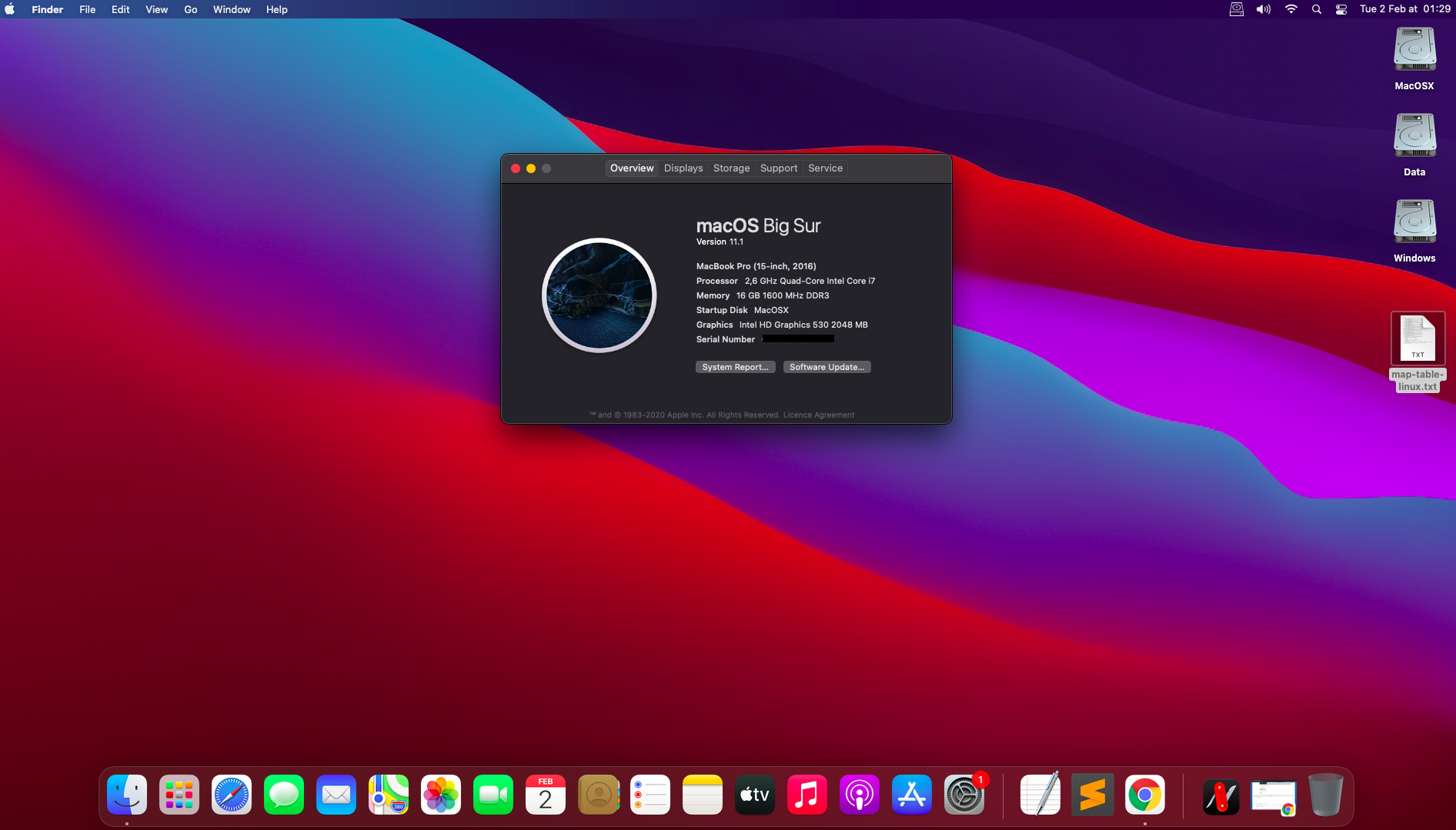

lazzy Posted February 2, 2021 Author Share Posted February 2, 2021 (edited) Big sur + Opencore I find this combo more stable than the catalina + cloverbootloader elan mouse is not working in boot loader hotkey Fn +F8, Fn+F9 for control brightness doesn't work tested 2days it works stable i'm so happy Here is my efi opencore 0.6.6 (you must copy Ressources into EFI>OC>. I removed 'cos it's so heavy for upload here) EFI Opencore Gigabyte P15FV5.zip Edited February 24, 2021 by lazzy update opencore 0.6.6 Link to comment Share on other sites More sharing options...
