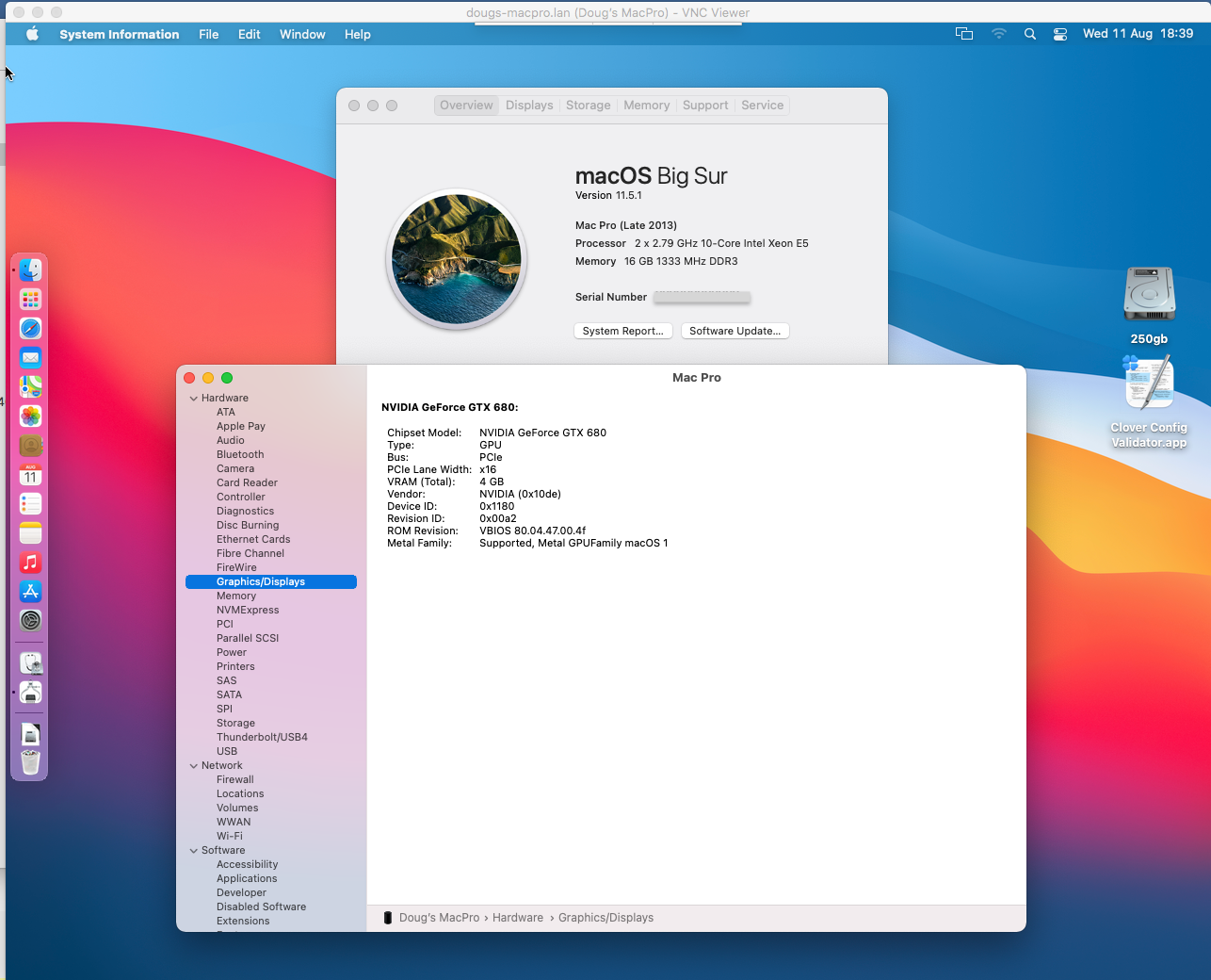

I put an amd W5000 card in to try it in vesa mode, it boots the the login screen ok and completed the upgrade install/reboot cycles. Once stable I configured remote desktop access and put the gtx 680 back in.
Here's a screen grab from the remote session, I've tried both DVI outputs, one a dual link to a 30" apple cinema display and the other dvi with analog vga monitor. Not tried the hdmi yet.

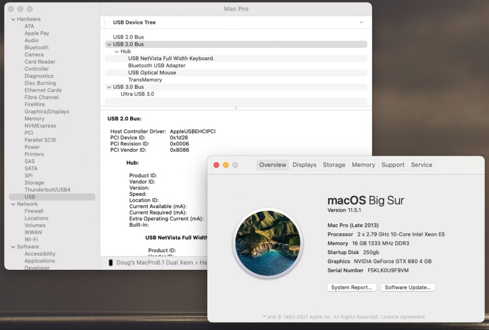

I changed SMBIOS from 6.1 to 3.1 and the GTX 680 card is back to fully supported but the USB ports are not working...
Update:
The built-in USB ports don't work but my Inatech PCIe add-in FL1100 based USB3 card is, supported oob.
Edited by dougthomson
update
5 hours ago, Hervé said:
You need to remap your USB ports after the SMBIOS change.
T'as raison!
I changed back to using USBInjectAll.kext (I had been using the USB export feature in hackintool).
Now running with smbios macpro 5.1 and built-in USB back. Nickel :)

Some progress on the issue with my GTX 680 (flashed with mac bios). I'll add a build thread for the Clover v5138 based Big Sur install on the Dell T6510.
I was checking my BIOS settings on the Dell T6510 and noticed it was set to mixed legacy/UEFI mode and that the UEFI Dell logo doesn't show at power on.
I set it to UEFI only (no legacy mode).
On power on the Dell logo showed as usual on my Apple 30" Cinema Display (dual link DVI 2560x1600 res)
I changed the SMBIOS back to 6.1  as both the real macpro 6.1 and the dell use the Intel c602 chipset. It booted up to the Big Sur desktop successfully :)
I also added my mapped usb kext and aml files from hackintool back to clover too, all working well.
