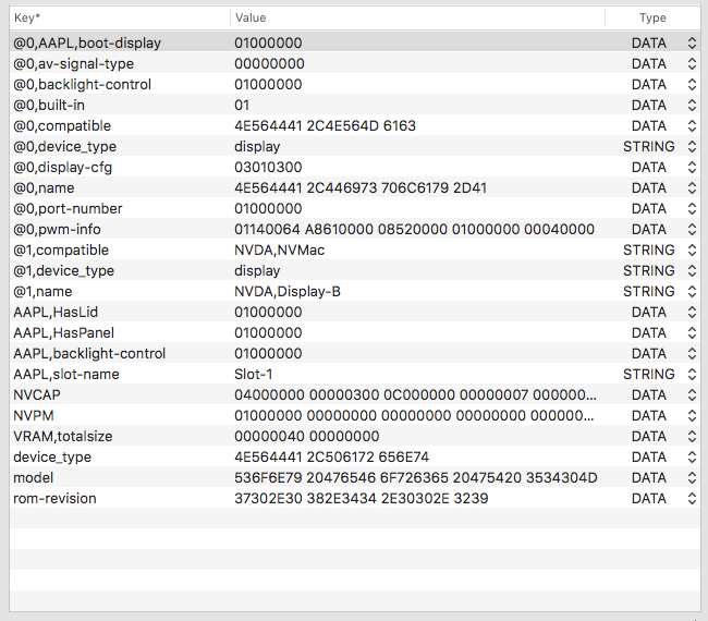

On 1/11/2021 at 3:13 AM, Cerbereus said:
My device is not optimus. single gpu.

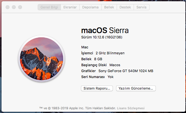

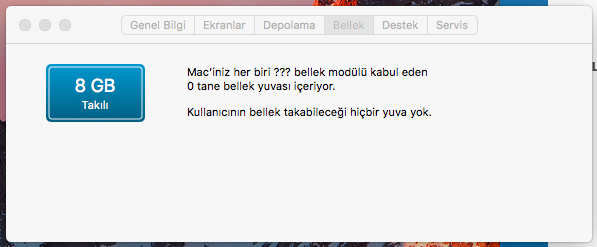

I solved the nvidia problem by looking at the reg file I received from clover, adding to the opencore device property. there is currently no problem with the image. It works including the hdmi port.
but now there is a problem like the device does not see smbios and memory. I tried many smbios but didn't get any results.
How should I go about it?
Thank you.
Where did you get the value of GT 540M in device properties?
