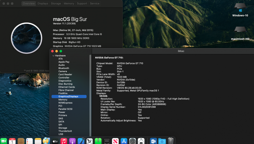

chris1111 5,157 Posted January 2 Share Posted January 2 40 minutes ago, lolwatpear said: I'm having issues with this GPU. I had no issue switching a 5700 xt out for it with Catalina. I didn't even change any boot args, kexts, or anything. With Big Sur, I just get 'no signal' when trying to use the card. I tried messing with the boot args bit , system ID, etc., but nothing. Does anyone know why this would be happening? It boots with nv_disable=1 , but disables acceleration obviously. I have two machine with this card working OOB in Big Sur Link to post Share on other sites

chris1111 5,157 Posted January 2 Share Posted January 2 12 minutes ago, lolwatpear said: I know, so it makes absolutely no sense why it isn't It worked fine under catalina for me. It work OOB from Sierra 10.12 to Big Sur 11 Link to post Share on other sites
