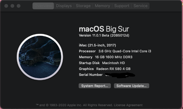

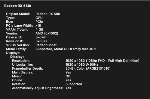

Install macOS Big Sur on H310sd3 Board
My PC spec
motherboard :ONDA h310sd3
CPU : intel i3 9100f
DGPU: AMD :RX580 4G
SMBIOS:iMac 19,1
342279721_ScreenShot2020-11-12at10_04_31PM.png.019546e701e155a8998ccad8ec3f8598.png1703257411_ScreenShot2020-11-12at10_11_12PM.png.f6e8e4bcb9dfb861a2b8ab6ebb0404e7.png
https://github.com/linlinger/ONDA-H310SD3-OC-hackintosh
This is my EFI files. It's not a perfect one.
You can have a look there.
This is the end of sharing part.
