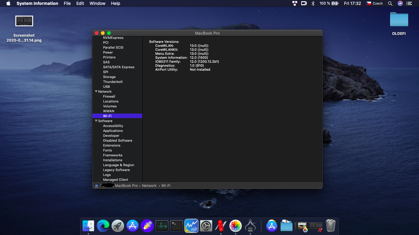

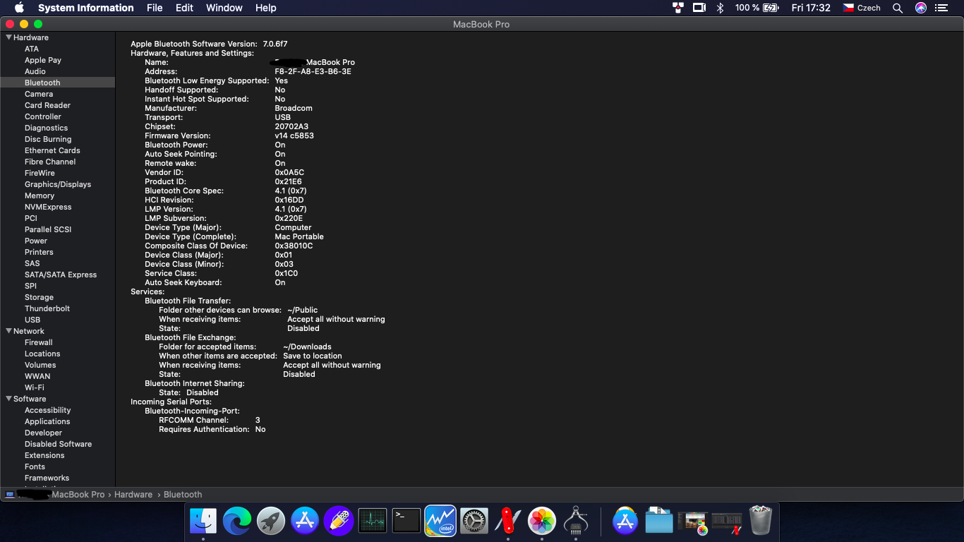

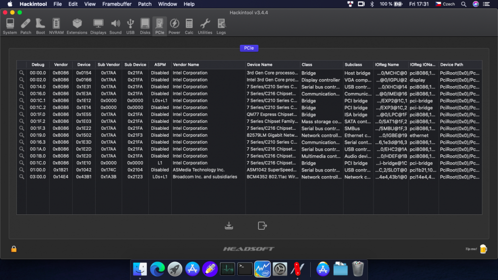

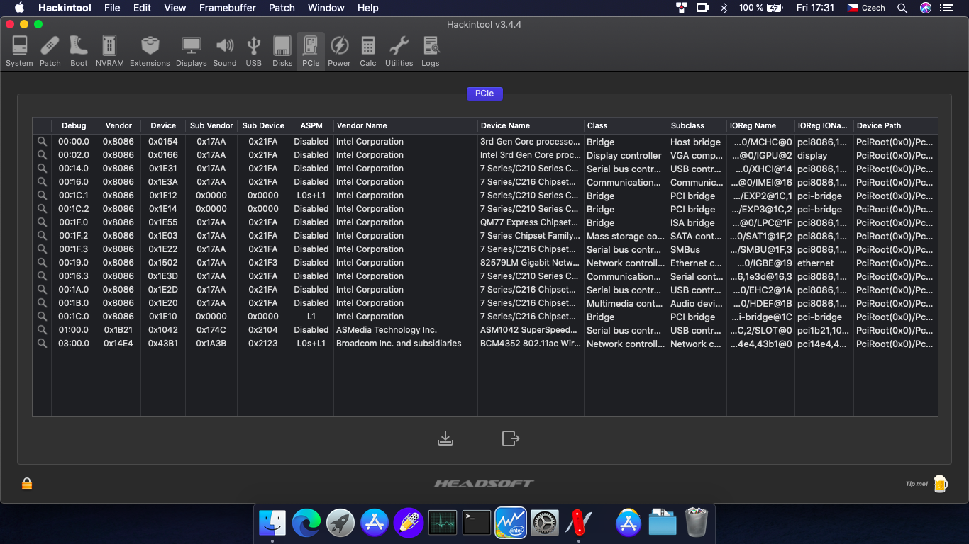

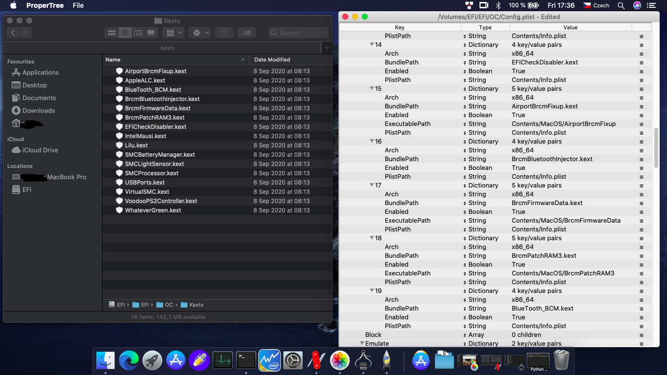

dustojnikhummer Posted September 25, 2020 Share Posted September 25, 2020 (edited) Lenovo Thinkpad X230 Unlocked advanced BIOS (WIFI Whitelist removed) Catalina 10.15.7 i5 3320m Azurewave CE-123H / BCM4352 / BCM94352HMB (Aliexpress link to what I bought) I'm trying to get my Azurwave card working, but can't do it. Bluetooth does work, but the AirportBrcmFixup doesn't seem to do anything. Card properly detected in Hackintool. I even tried using the IO80211 kext from Mojave, which did nothing, though a user on OSXLatitude forums said his card worked again after Catalina 10.15.5 Edited September 25, 2020 by dustojnikhummer Link to comment Share on other sites More sharing options...

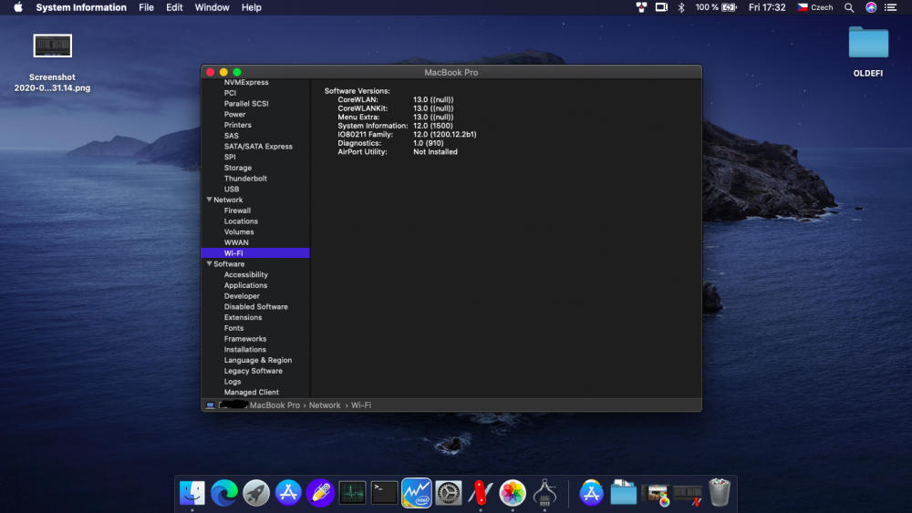

dustojnikhummer Posted September 25, 2020 Author Share Posted September 25, 2020 Alright, sitrep. By doing a OC Clean Snapshot, wifi shows up... but it refuses to take any passwords, even a direct share from my iPad and constantly jumps between "On" and "Looking for networks" Link to comment Share on other sites More sharing options...
dustojnikhummer Posted September 25, 2020 Author Share Posted September 25, 2020 (edited) Okay, I switched SMBios to MacBookAir5,2. What else do I need to do? WiFi still won't connect even to a network with no password. MAC Address is FF:FF:FF:FF:FF:11 and there seems to be no way to change that Edited September 25, 2020 by dustojnikhummer Link to comment Share on other sites More sharing options...
