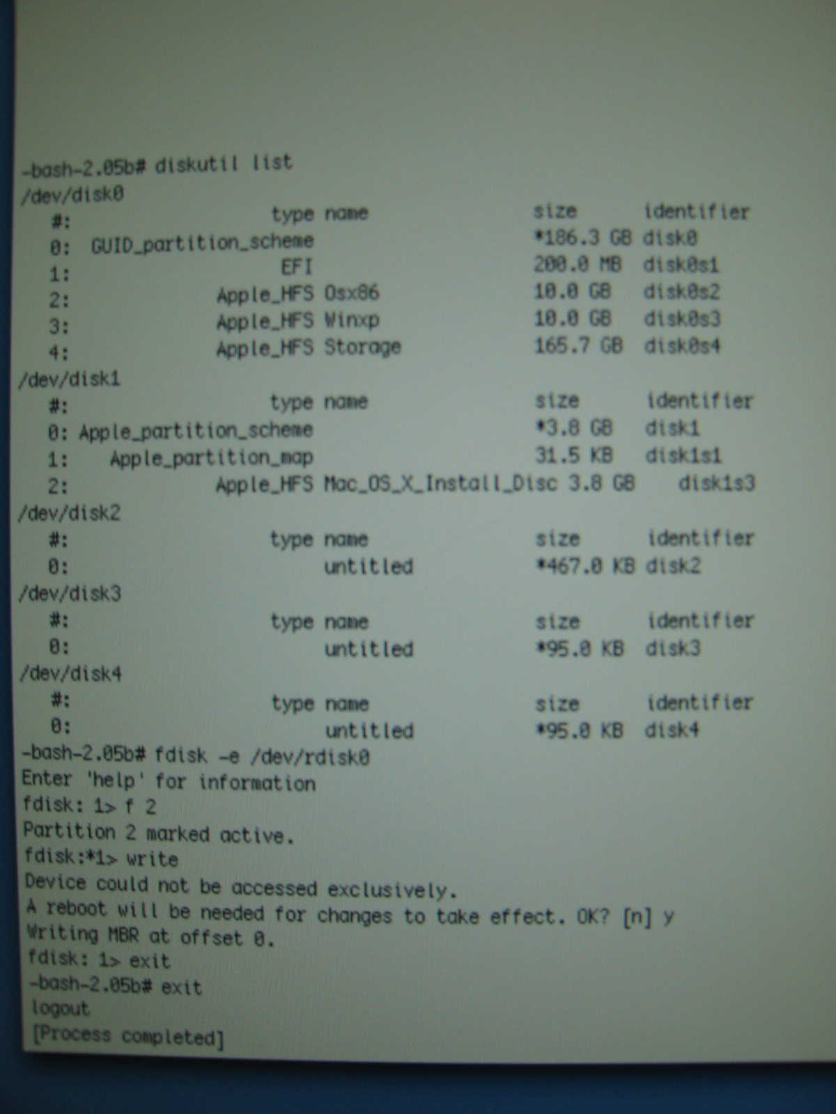

Pharmer1 Posted November 29, 2006 Share Posted November 29, 2006 I've recently installed OsX86 (This version to be specific: MacOSX_10.4.8DVD AMD SSE3 TEST 1). I started with a fresh install, using the osx disk utility to format and partition the drive. Installaion went smoothly with no error messages. However, when I turn my computer on, it does the POST (count's ram etc) then it boots to a black screen with a flashing cursor in the upper left hand corner. There are no error messages and the computer is unresponsive. I have tried using the terminal to change the active partition to disk 0 partition 2 (As outlined here: http://wiki.osx86project.org/wiki/index.ph...mple_Dual_Boot) and it didn't change anything. Now I'm stumped. Any feedback would be much appreciated. TIA Mac Nube, Curt System Specs: MOBO: asus a8v-mx (via K8M800 chipset) CPU: athlon 64 3500+ (s939) RAM: 2 gigs ddr VIDEO: Asus V7100 geforec 2 mx HD: 200 gig seagate barracuda (ide) AUDIO: SB audigy Link to comment https://www.insanelymac.com/forum/topic/34500-black-screen-of-death/ Share on other sites More sharing options...

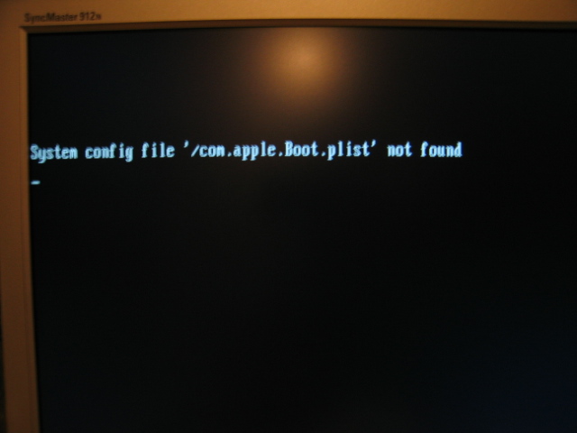

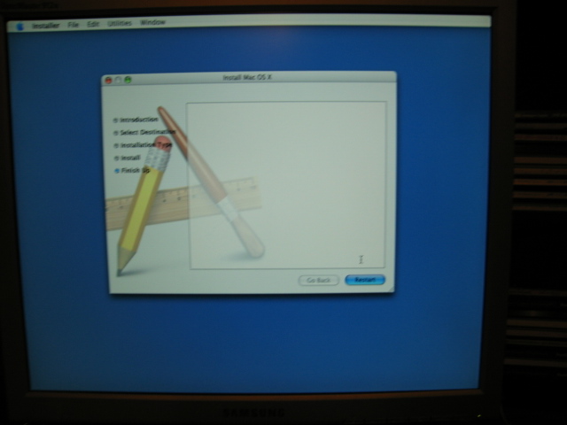

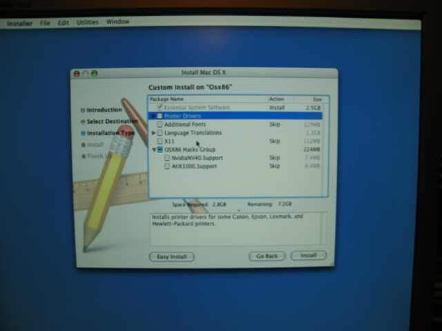

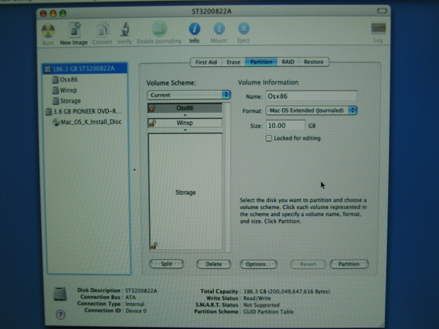

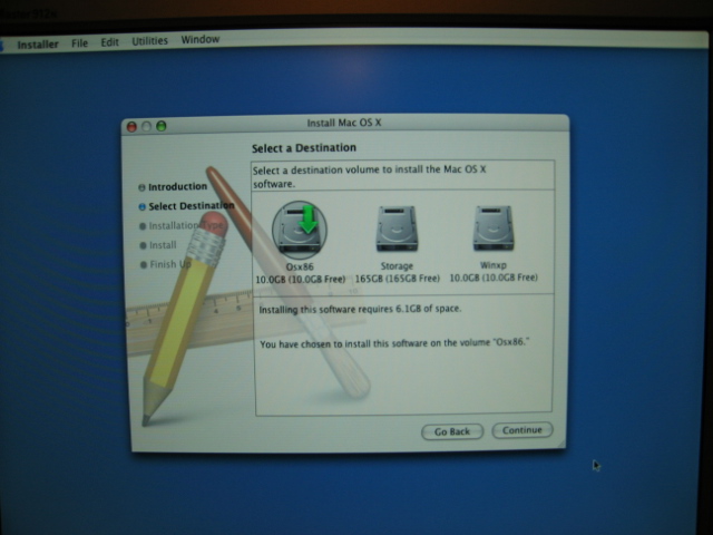

Pharmer1 Posted November 30, 2006 Author Share Posted November 30, 2006 I just performed a fresh install and took some photos of the process. Maybe someone can point out a mistake I'm making. This time I got an error message when booting which says: "system config file ' /com.apple.boot.plist' not found" . I noticed other people with a similar problem bet there is no difinitive answer on how to solve the problem. TIA, Curt Link to comment https://www.insanelymac.com/forum/topic/34500-black-screen-of-death/#findComment-244577 Share on other sites More sharing options...

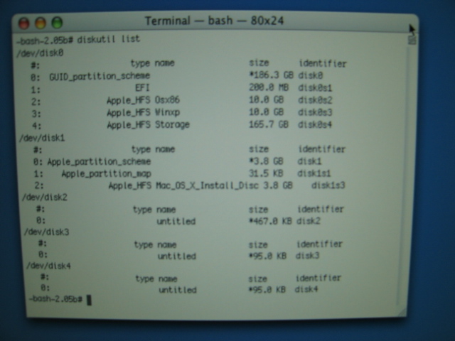

Rammjet Posted November 30, 2006 Share Posted November 30, 2006 In the first picture, see the Options button near the bottom? Click it and select MBR. Link to comment https://www.insanelymac.com/forum/topic/34500-black-screen-of-death/#findComment-244594 Share on other sites More sharing options...

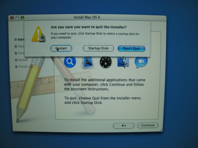

Pharmer1 Posted November 30, 2006 Author Share Posted November 30, 2006 "In the first picture, see the Options button near the bottom? Click it and select MBR." Thanks, I'll give that a try. Here are a few more pics of me attempting to change the active boot partition. Take a look and let me know if you see any mistakes. Thanks, Curt Link to comment https://www.insanelymac.com/forum/topic/34500-black-screen-of-death/#findComment-244604 Share on other sites More sharing options...
Pharmer1 Posted November 30, 2006 Author Share Posted November 30, 2006 "In the first picture, see the Options button near the bottom? Click it and select MBR." Awesome, that worked. I'm posting from my new hackintosh. Thanks, Curt Link to comment https://www.insanelymac.com/forum/topic/34500-black-screen-of-death/#findComment-244660 Share on other sites More sharing options...
