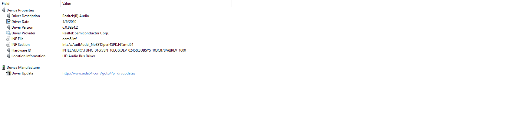

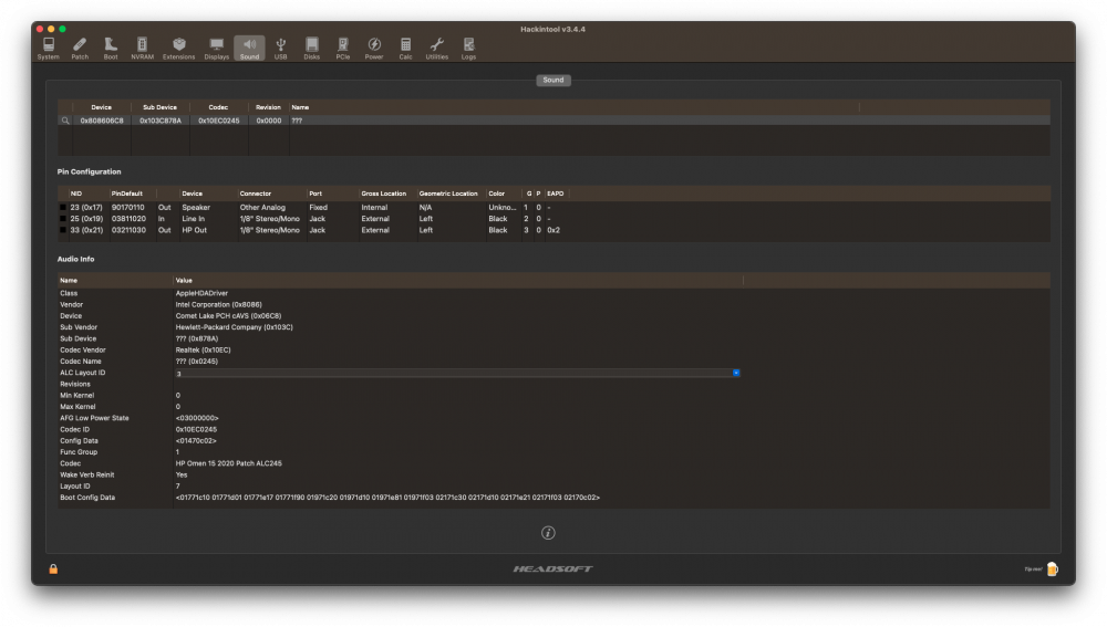

Linus_06 Posted August 19, 2020 Share Posted August 19, 2020 (edited) Hello everyone! I need some help in trying to fix sound on my HP Omen As you can see, I injected pin configuration and pathmap and both IORegistryExplorer(in the attachment) and Hackintool can detect it but there is no audio device detected by macOS ALC245 in Aida64 Any help would be appreciated, thanks! Codec file dumped from Ubuntu: codec#0.txt Codec pathmap generated from Ubuntu: codec#0.svg My EFI folder: EFI.7z Lilu and plugins logs: Lilu_1.4.7_20.0.txt Opencore logs: opencore-2020-08-19-014901.txt IOReg dump: Linus's MacBook Pro.ioreg.zip Edited August 19, 2020 by Linus_06 Link to comment https://www.insanelymac.com/forum/topic/344883-alc245-on-hp-omen-15-2020-not-working-with-applealc/ Share on other sites More sharing options...
leonurdo Posted September 12, 2020 Share Posted September 12, 2020 hi try the newest release Apple ALC 1.5.2 and layout 13 for omen AppleALC 1.5.2 I have the same system, the only things are video outputs (HDMI and dMini Display) and microphone dont work with this Lunjielee's EFI for HP OMEN 15 Link to comment https://www.insanelymac.com/forum/topic/344883-alc245-on-hp-omen-15-2020-not-working-with-applealc/#findComment-2737191 Share on other sites More sharing options...
