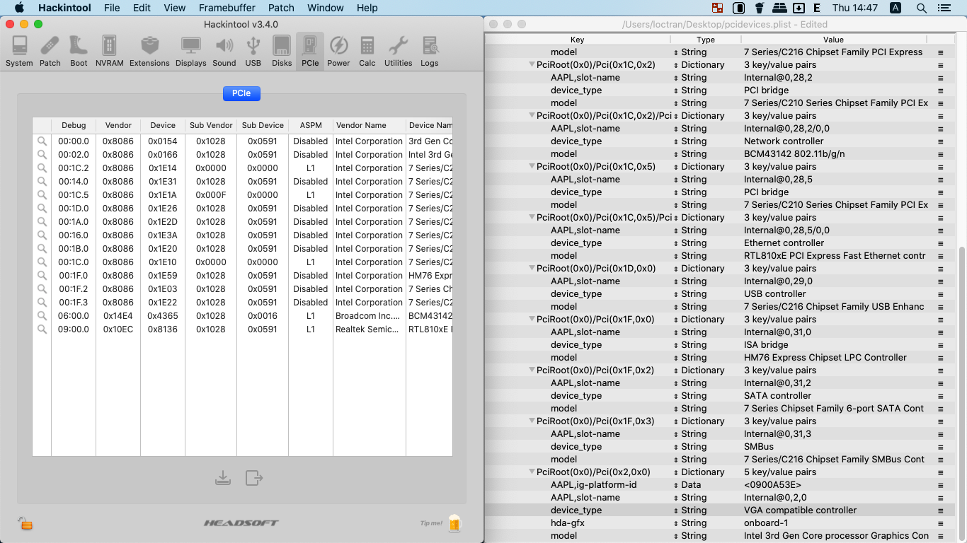

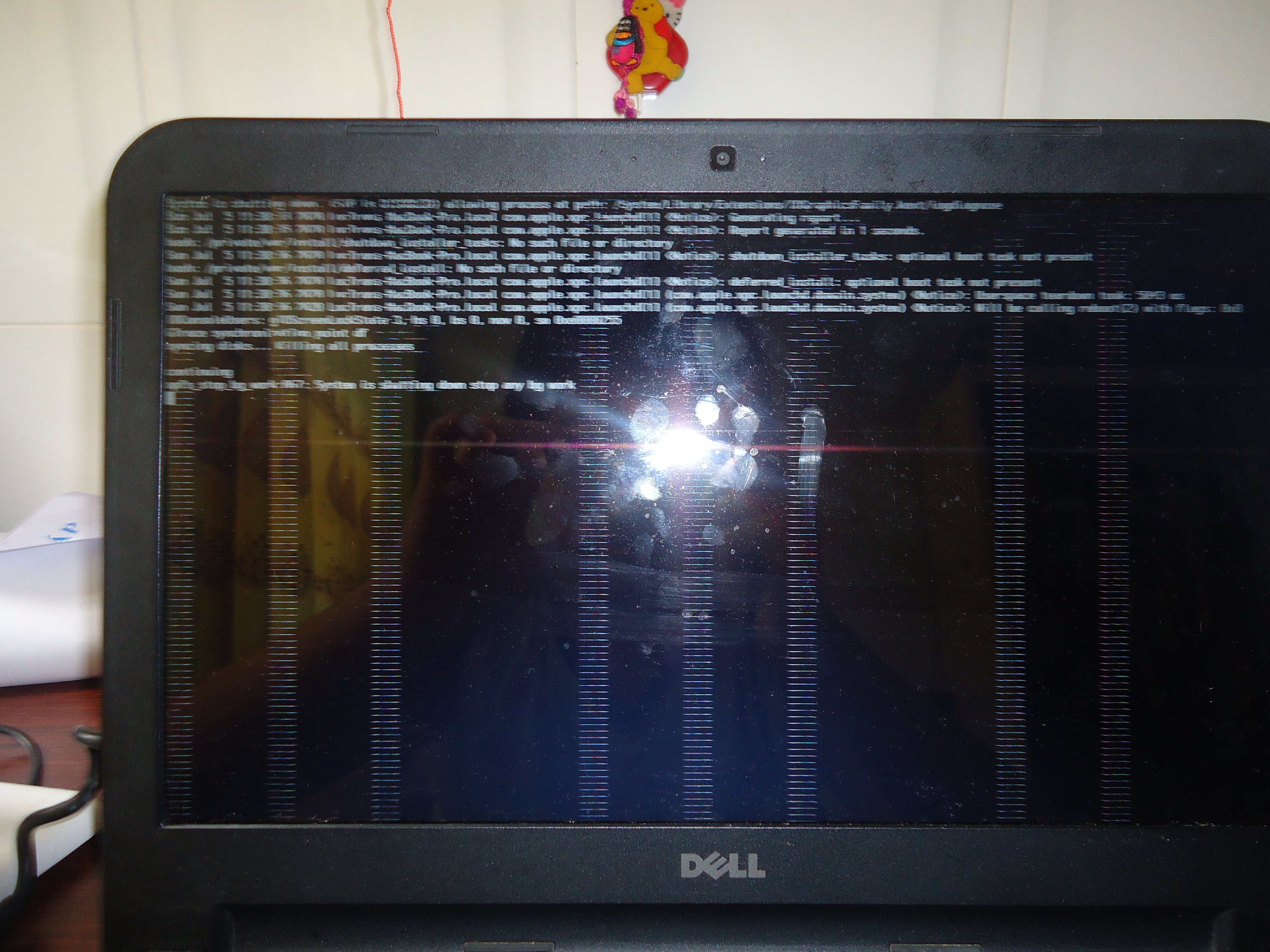

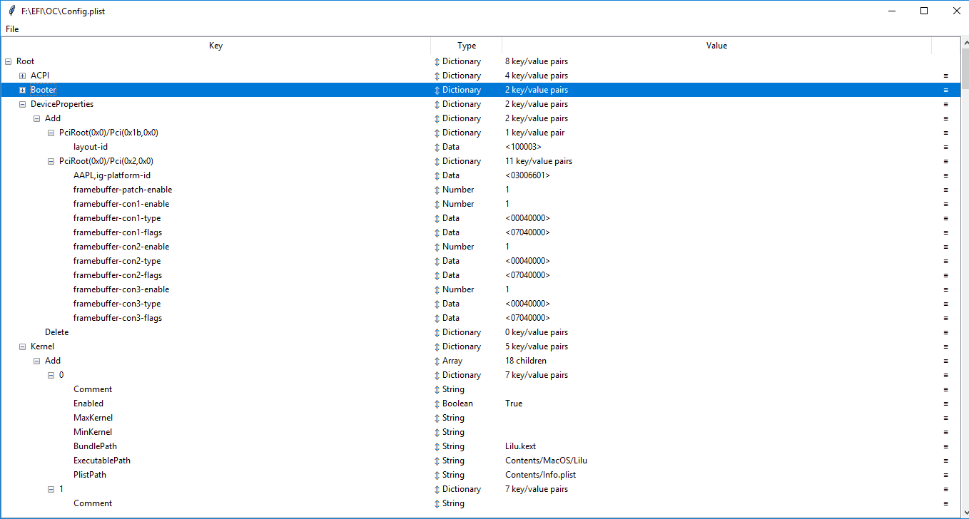

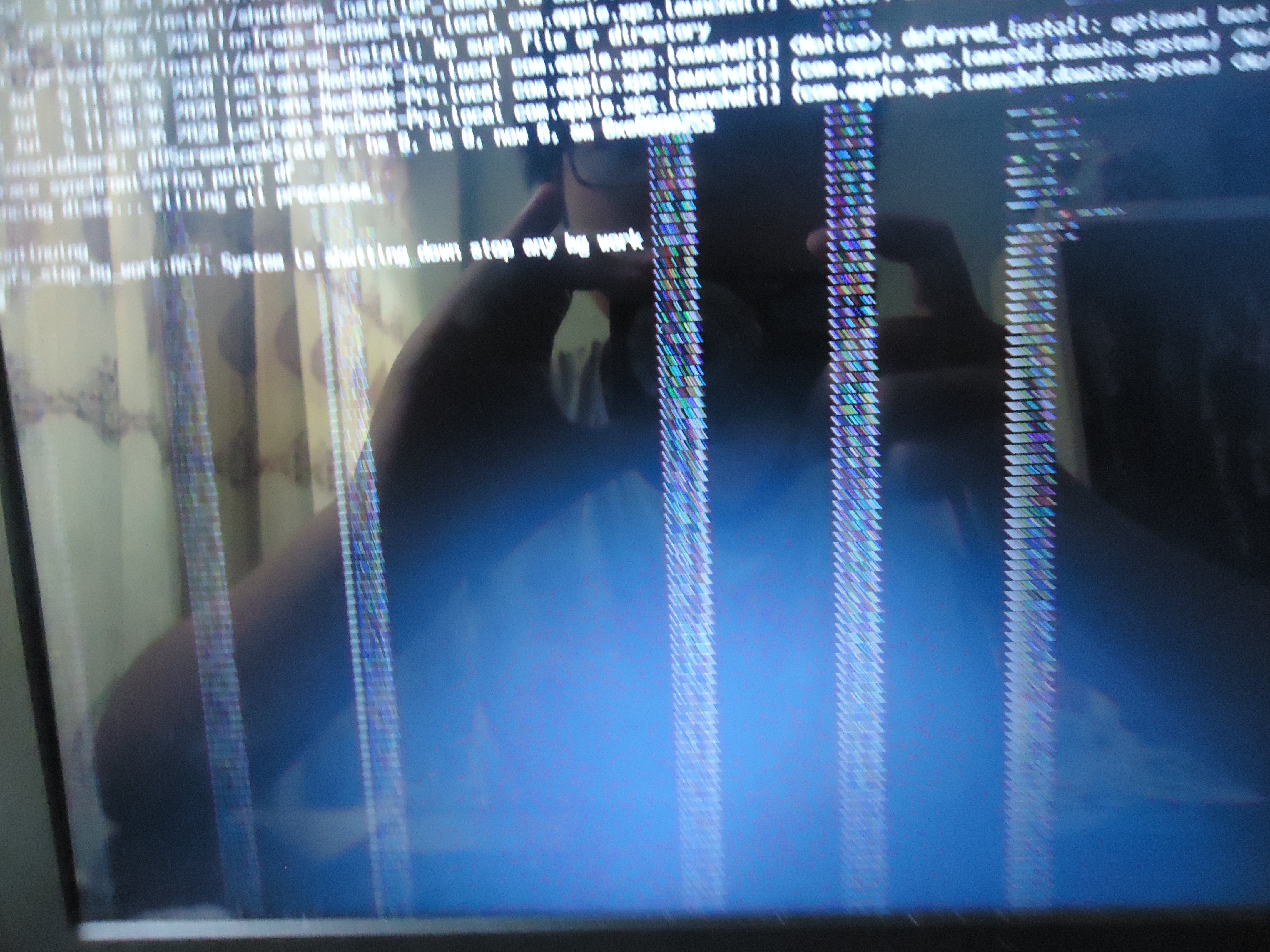

LarryTran016 Posted July 9, 2020 Share Posted July 9, 2020 Excuse me, guy. I'm using OC 0.5.9 for installing hackintosh in my DELL INSPIRON 3421. Is there any way to fix this.Although the VRAM=1536mb and the display is default for scaled, it still happen. I've try several ways before asking here for your helps. Those ways are: 1/Turn on/off CSM (reset NVRAM before the changing) 2/I also reinstall the hackintosh when the CSM where installed This is my iGPU patching and some videos, pictures about it and my specs. When shutdown, the last words shown is that CPU halted Although I've patch almost everything (I only need to patch Battery Status now) MOV04351.mp4 MOV04350.mp4 Link to comment https://www.insanelymac.com/forum/topic/344448-about-stripe-in-macos-10155-install-with-oc-059-debug/ Share on other sites More sharing options...

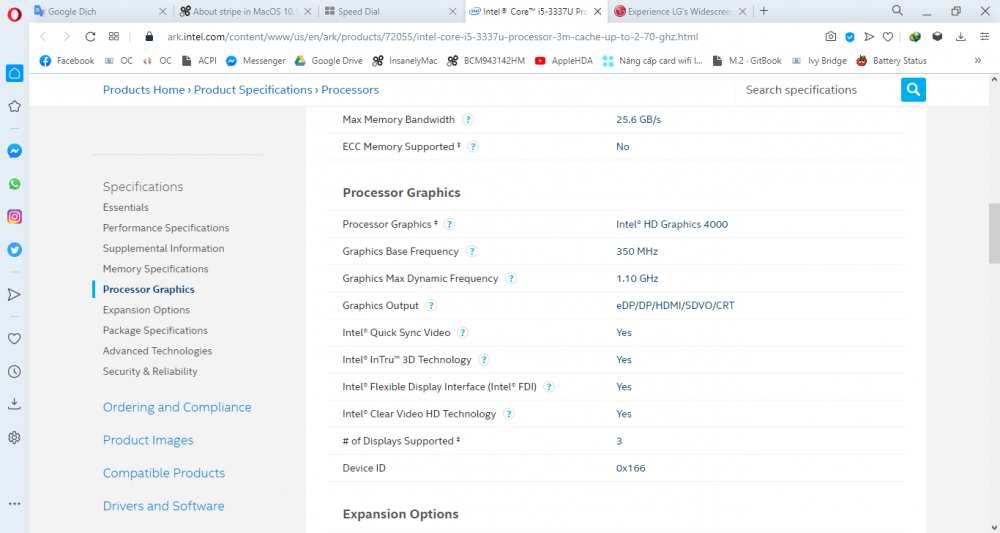

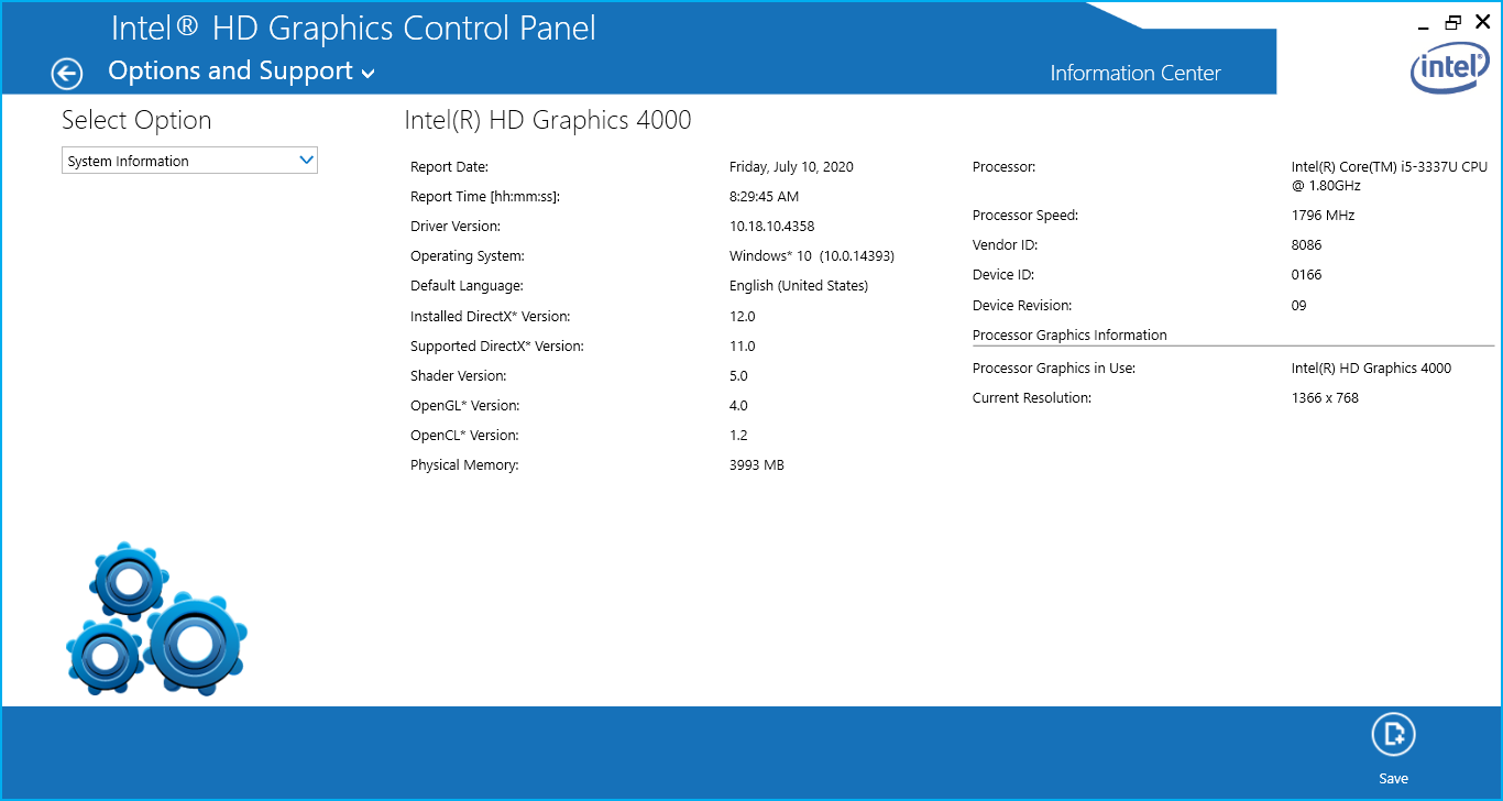

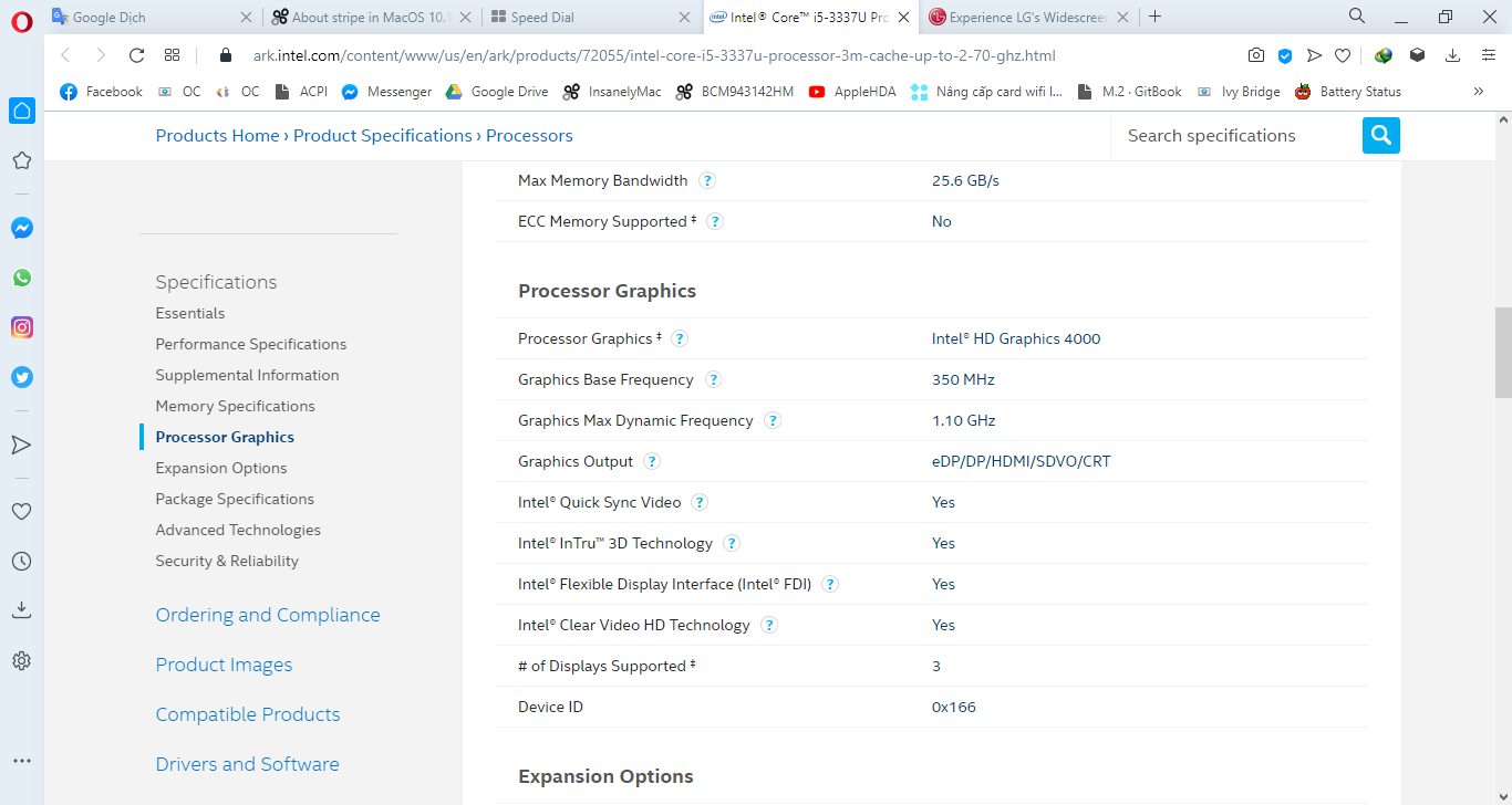

LarryTran016 Posted July 9, 2020 Author Share Posted July 9, 2020 And if you need my monitor name, it's LG Philips LP140WH2 (Dell MV65P) [14" LCD]. And does the second picture mean that my laptop (DELL INSPIRON 3421) have a built-in VGA iGPU connector, but when searching on ark.intel.com (https://ark.intel.com/content/www/us/en/ark/products/72055/intel-core-i5-3337u-processor-3m-cache-up-to-2-70-ghz.html) it shown that the iGPU doesn't have the VGA connector. Again, thanks for your time and your patience. pcidevices.plist Link to comment https://www.insanelymac.com/forum/topic/344448-about-stripe-in-macos-10155-install-with-oc-059-debug/#findComment-2729529 Share on other sites More sharing options...

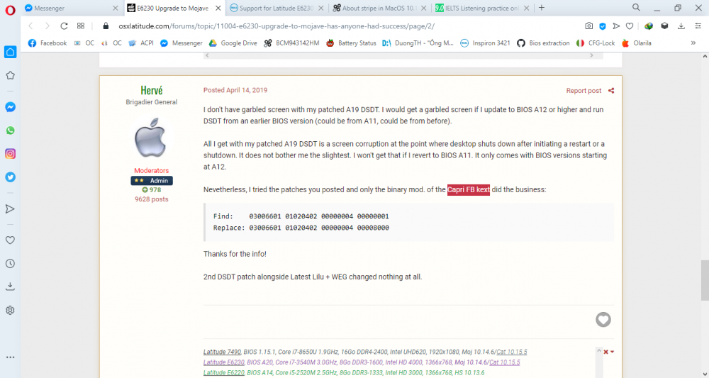

LarryTran016 Posted July 10, 2020 Author Share Posted July 10, 2020 21 hours ago, Hervé said: https://osxlatitude.com/forums/topic/8883-dell-latitude-e6230-with-i5-3340mi7-3540m-hd4000-and-1366x768-lcd-el-capitansierrahigh-sierramojavecatalina/?do=findComment&comment=90029 I've gone everywhere on the internet, that forum is dead or that kind of things. So is there any helps with this. Thanks a lot for helping me Link to comment https://www.insanelymac.com/forum/topic/344448-about-stripe-in-macos-10155-install-with-oc-059-debug/#findComment-2729584 Share on other sites More sharing options...

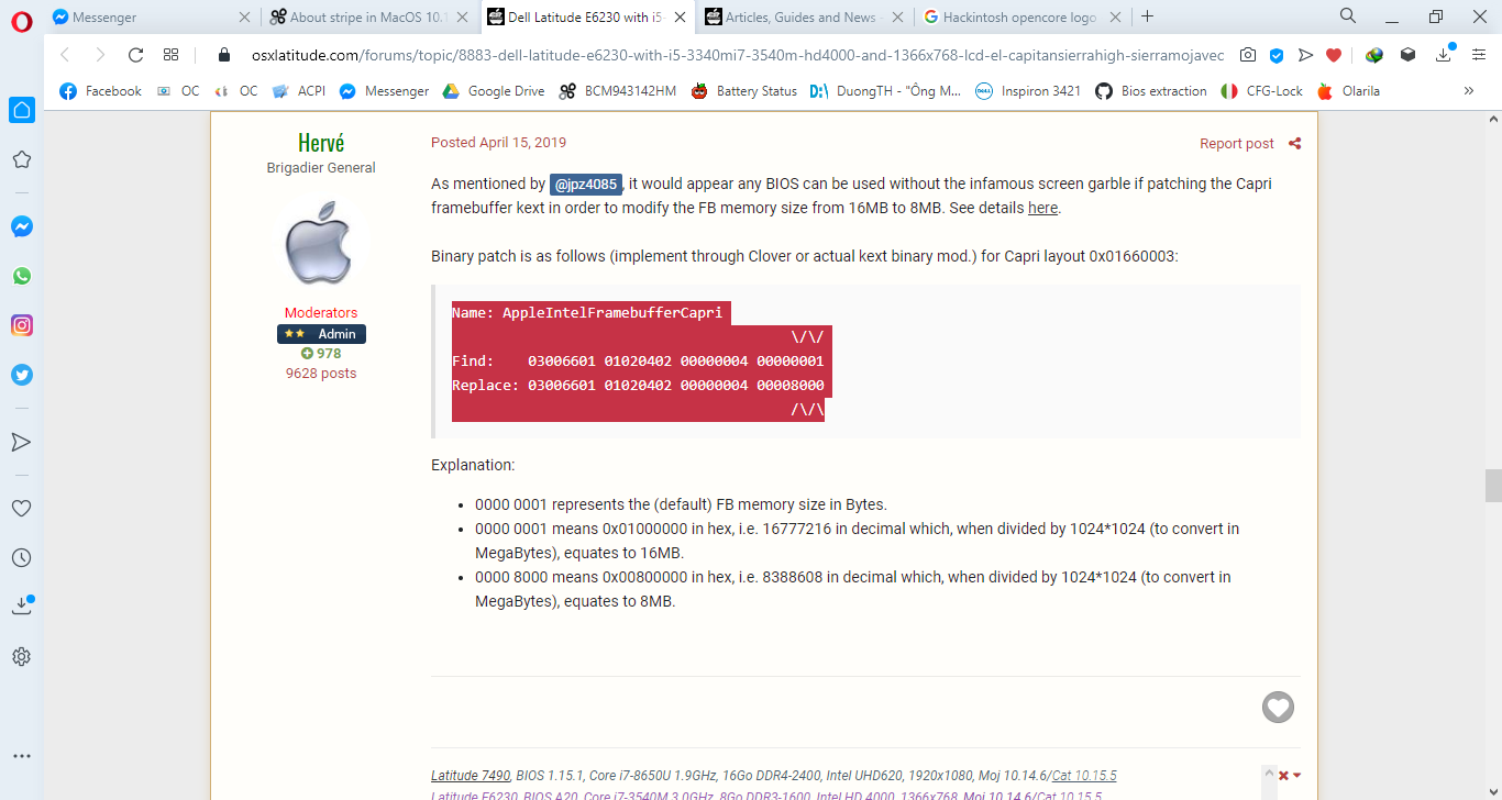

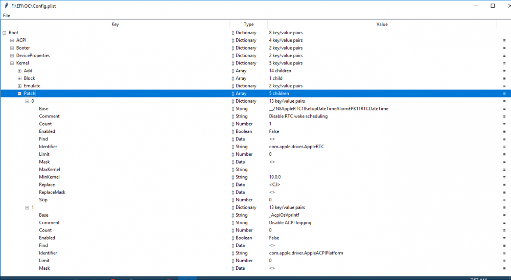

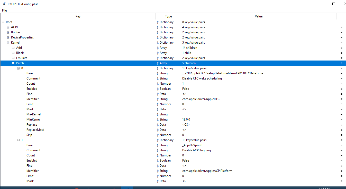

LarryTran016 Posted July 10, 2020 Author Share Posted July 10, 2020 Good to see that (I've just though about changing the VPN may help but when open the website, it work). But there is only 1 issues left:where should I put these in Opencore config.plist (Is it in the ACPI->Patch): Name: AppleIntelFramebufferCapri \/\/ Find: 03006601 01020402 00000004 00000001 Replace: 03006601 01020402 00000004 00008000 /\/\ Link to comment https://www.insanelymac.com/forum/topic/344448-about-stripe-in-macos-10155-install-with-oc-059-debug/#findComment-2729633 Share on other sites More sharing options...

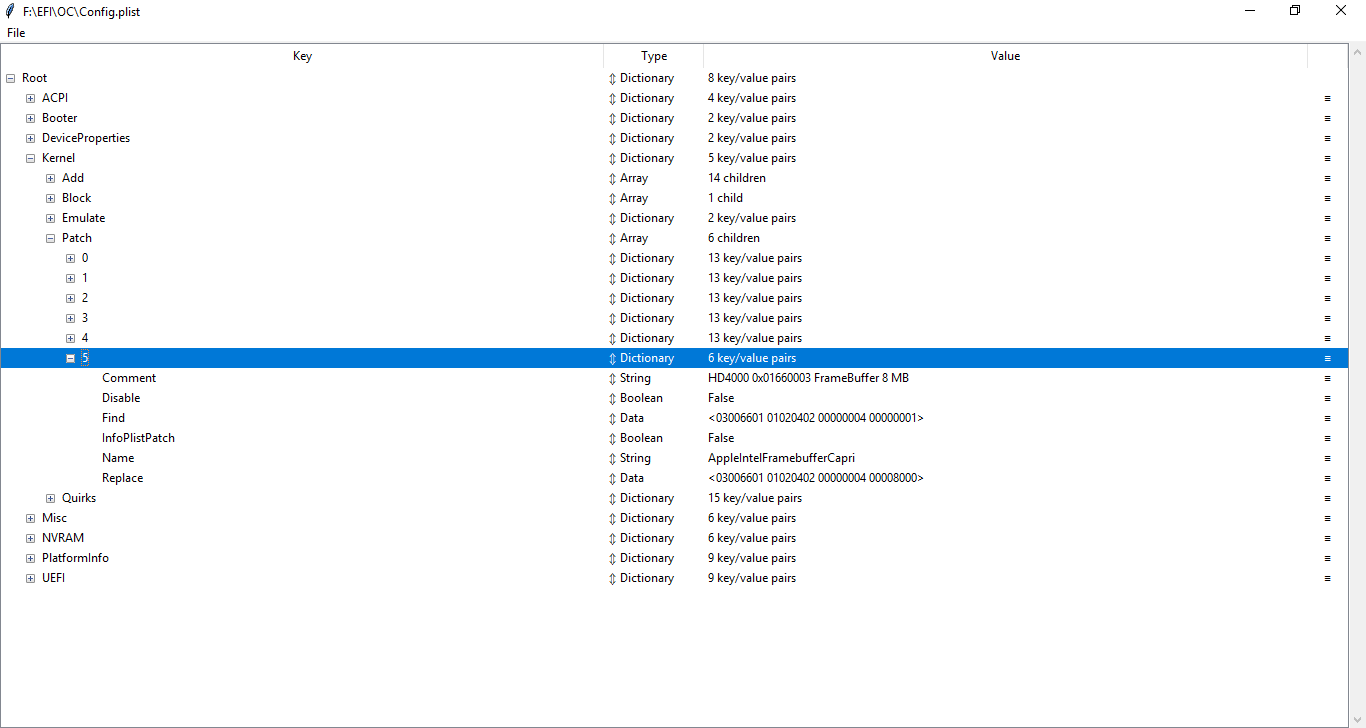

LarryTran016 Posted July 10, 2020 Author Share Posted July 10, 2020 Oh, I've finally found it, I think that I've to put that guy in the Kernel->Patch. Thanks a lot for your help Link to comment https://www.insanelymac.com/forum/topic/344448-about-stripe-in-macos-10155-install-with-oc-059-debug/#findComment-2729634 Share on other sites More sharing options...

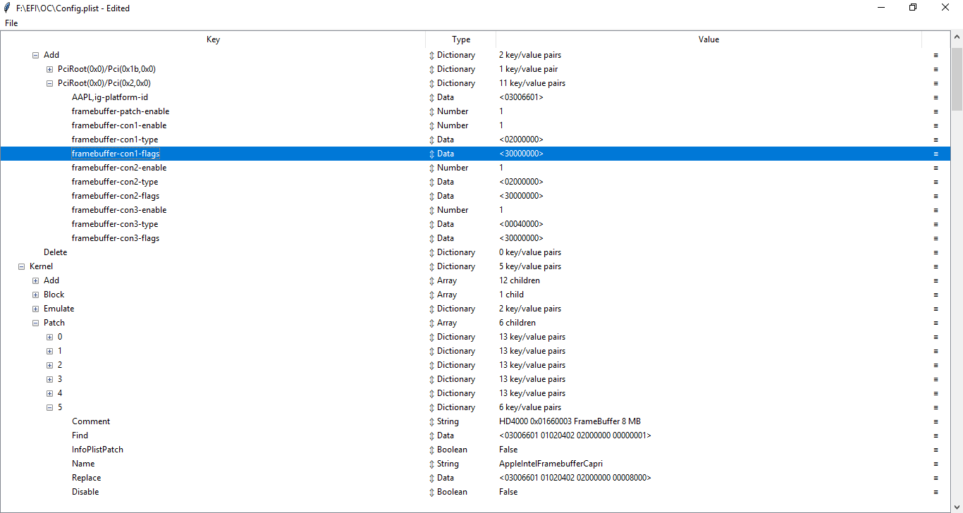

LarryTran016 Posted July 10, 2020 Author Share Posted July 10, 2020 (edited) Finally, it's LVDS connector and is this "kexttopatch" OK, and I though that you've mentioned the Capri FB kext. Edited July 10, 2020 by LarryTran016 Found more information online Link to comment https://www.insanelymac.com/forum/topic/344448-about-stripe-in-macos-10155-install-with-oc-059-debug/#findComment-2729638 Share on other sites More sharing options...
LarryTran016 Posted July 10, 2020 Author Share Posted July 10, 2020 (edited) Because of the changing of the connectors, I've change something in the DeviceProperties->Add->PciRoot(0x0)/Pci(0x2,0x0) and in the Kernel->Patch, but it didn't work. Here is a picture, too. It didn't work, when shutdown and login it still have some noise, vertical stripes or that kind of things. Edited July 11, 2020 by LarryTran016 Found on the internet that the kext is built-in macOS 10.15.5 Link to comment https://www.insanelymac.com/forum/topic/344448-about-stripe-in-macos-10155-install-with-oc-059-debug/#findComment-2729643 Share on other sites More sharing options...

LarryTran016 Posted July 11, 2020 Author Share Posted July 11, 2020 Here is my plist as well (sorry for absent of Platforminfo because of some rules here and if you want, I can send you my full plist in your message). Thanks a lot for helping me over time. Config.plist Link to comment https://www.insanelymac.com/forum/topic/344448-about-stripe-in-macos-10155-install-with-oc-059-debug/#findComment-2729812 Share on other sites More sharing options...
LarryTran016 Posted July 11, 2020 Author Share Posted July 11, 2020 On 7/10/2020 at 5:51 AM, Hervé said: Kext? What kext??? No kext to add... OSXL site was off some time yesterday but is fully active again. VGA is totally unsupported out of HD4000. Nothing you can do about it. The only other output you may use would be DP, DVI or HDMI depending on what your laptop offers. But forget about VGA output. Does using the same platformid but change kind connectors (along with flag and some others things) because finally, I've found that my screen is using LVDS connector Link to comment https://www.insanelymac.com/forum/topic/344448-about-stripe-in-macos-10155-install-with-oc-059-debug/#findComment-2729864 Share on other sites More sharing options...
