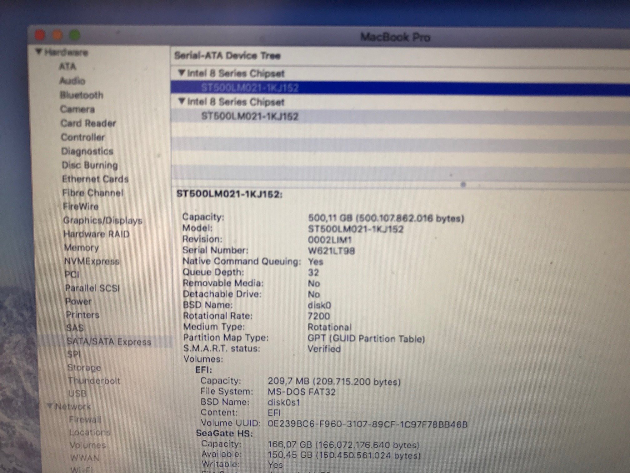

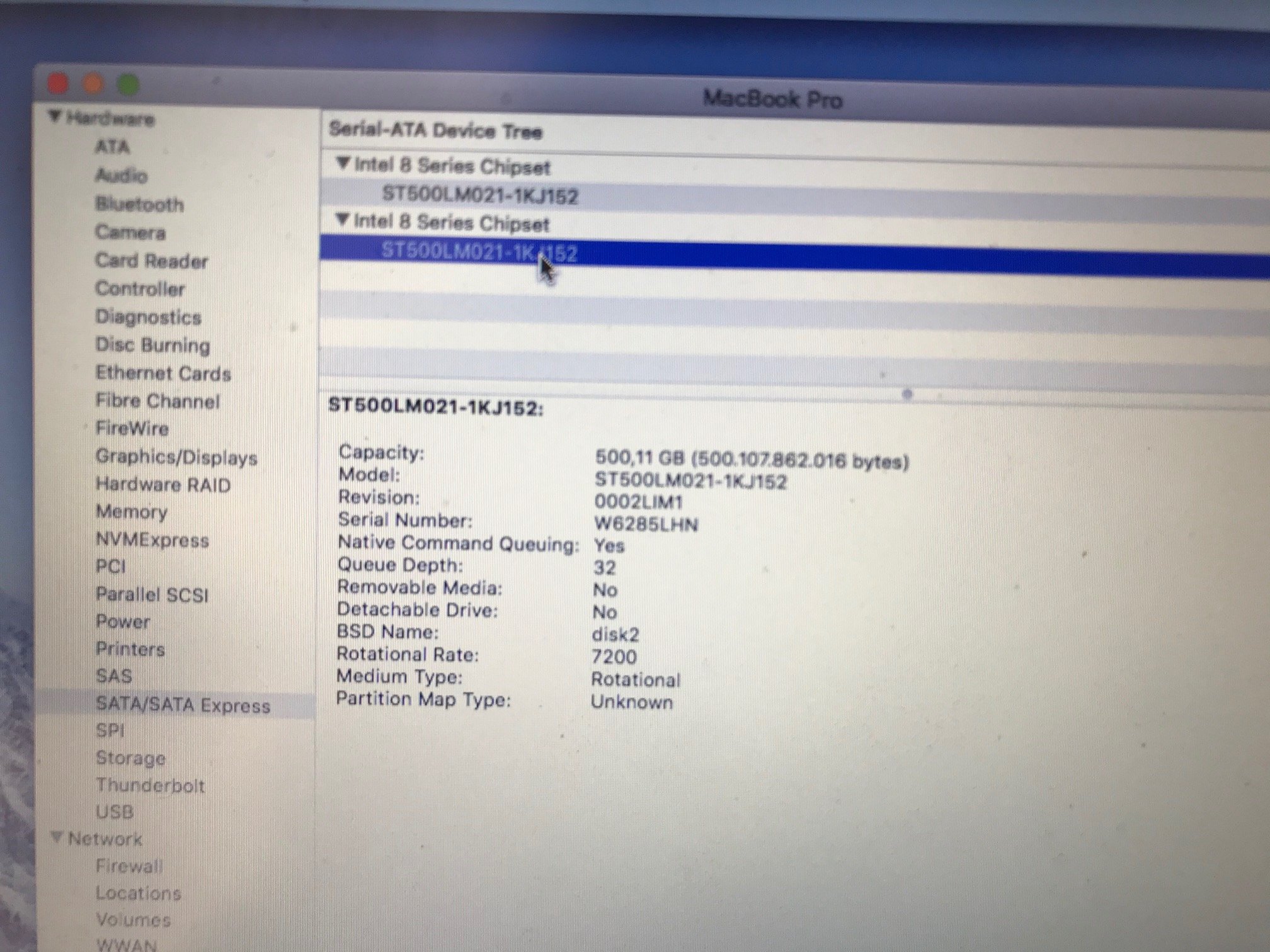

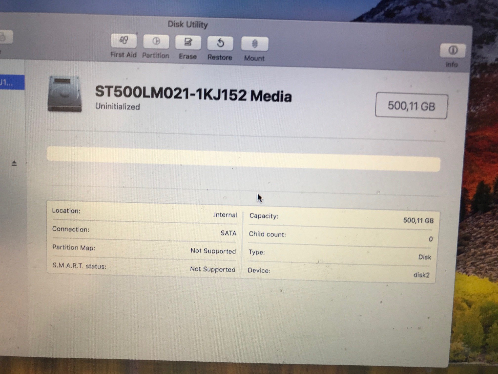

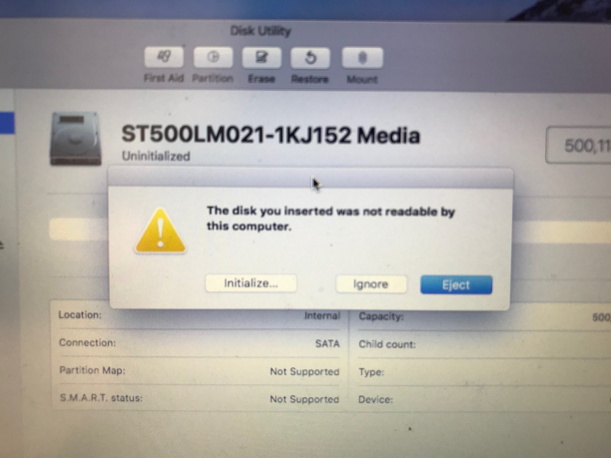

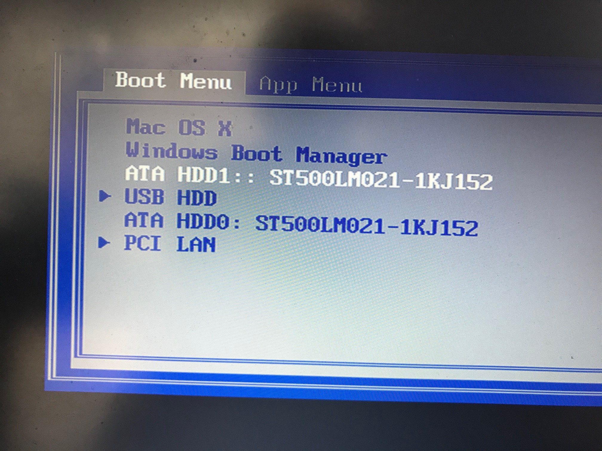

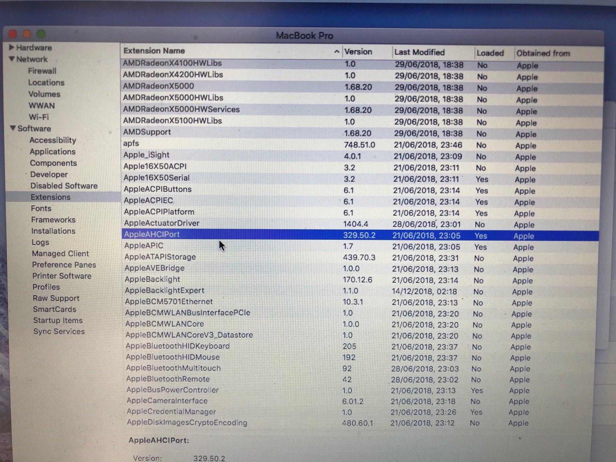

siachori Posted May 17, 2020 Share Posted May 17, 2020 I have this problem on ultrabay hdd on instalation and post instalation on High Sierra, Movaje and CatalinaI tryied explain in other posts but I know my english is not good. Now I trying with pictures I think is clear nowHELP PLEASE. Meabe incorrect AppleAHCIPort.kext?TEST:0- removing AppleAHCIPort.kext and replacing with sata-unsupported.kext1- Copyed AppleAHCIPort version 328 on /kext/other2- Installed v328 with [url="http://www.insanelymac.com/forum/topic/279450-why-insanelymac-does-not-support-tonymacx86/"]#####[/url]. AppleAHCIPort on /L/E (with sudo kextcache -i /).3- Updating config.plistPD: hard disk both are tested one by one and ok. Only problmes with ultrabay.PD2: tested with Seagate, WD and HGST disks, always ultrabay problem. AppleAHCIPort.kext.zip Link to comment https://www.insanelymac.com/forum/topic/343871-ultrabay-hdd-always-disk-was-not-readable-by-this-computer/ Share on other sites More sharing options...
siachori Posted May 17, 2020 Author Share Posted May 17, 2020 SOLVED with this solution on High Sierra: <<UltraBay HDD When using HDD in Ultrabay (instead of optical drive): install AHCIPortInjector.kext and AppleAHCIPort.kext in /Library/Extensions. AHCIPortInjector.kext fixes the Disk not initialized issue (disk cannot be read). AppleAHCIPort.kext fixes the disk being detected as an external drive (instead of internal).>> Thanks for all friends Link to comment https://www.insanelymac.com/forum/topic/343871-ultrabay-hdd-always-disk-was-not-readable-by-this-computer/#findComment-2722757 Share on other sites More sharing options...
