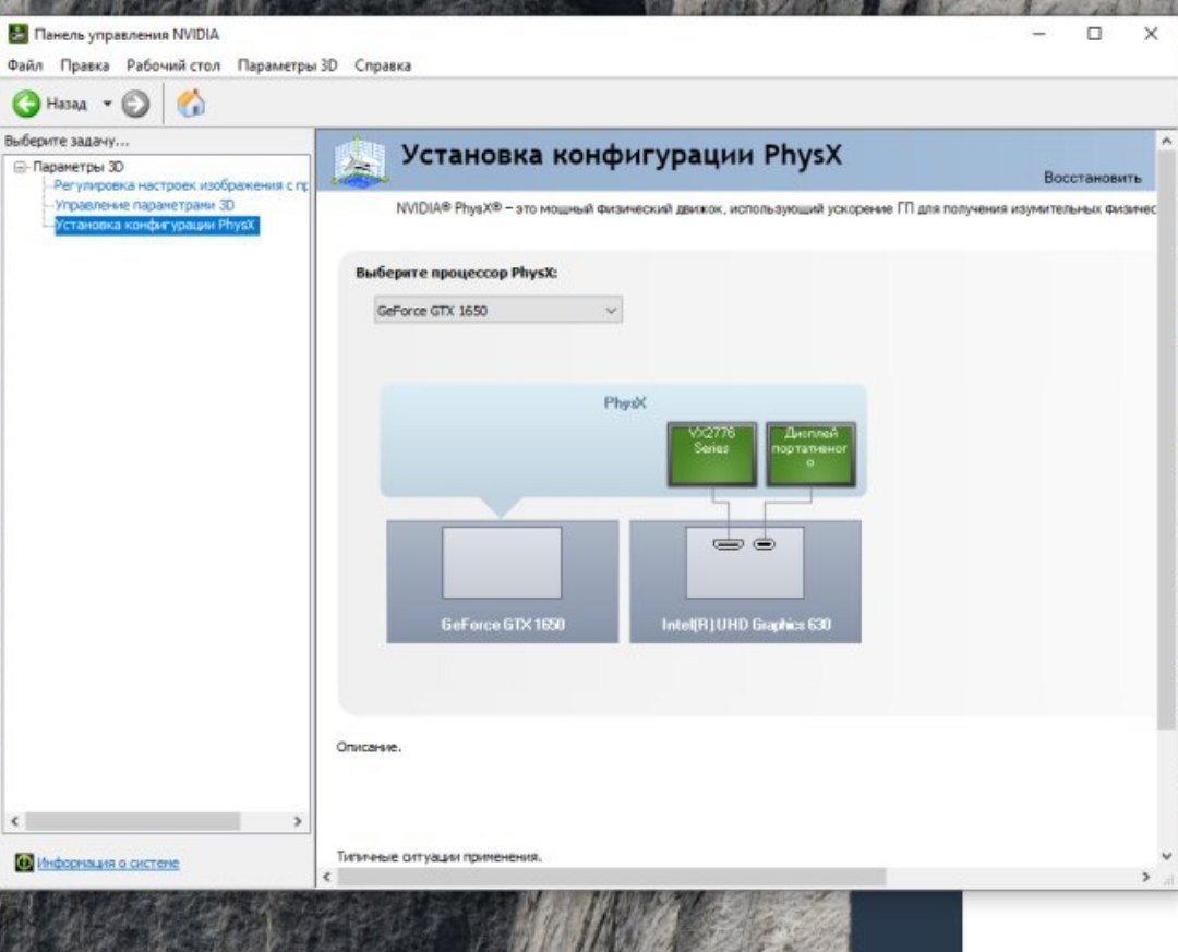

snitron Posted May 3, 2020 Author Share Posted May 3, 2020 13 hours ago, Hervé said: Using IORegistryExplorer, observe your iGPU/UHD 630 output ports when you hook your HDMI display to your Hack. If you do not see anything, this could mean that the HDMI output is actually wired to the Turing dGPU, in which case you're most likely screwed. If you see some changes under the output ports, you may simply need to patch your corresponding CFL framebuffer port for HDMI output. Thank you for your response! I have already checked in Windows: my external and internal monitors are connected to iGPU. Could you explain to me, how exactly I should check in IORegistryExplorer and pacth? With WEG? I'm a beginner in framebuffer patching... Link to comment https://www.insanelymac.com/forum/topic/343664-dual-monitor-on-intel-uhd-630-on-laptop-asus-vivobook-x571gt-bq037/#findComment-2720656 Share on other sites More sharing options...

snitron Posted May 3, 2020 Author Share Posted May 3, 2020 14 minutes ago, Hervé said: Possibly, I could not possibly guarantee it. You should try and pop the question of output ports individual connectivity to Asus support if there is such a thing. And this tool shows that hdmi connected ti iGPU (likely) Link to comment https://www.insanelymac.com/forum/topic/343664-dual-monitor-on-intel-uhd-630-on-laptop-asus-vivobook-x571gt-bq037/#findComment-2720750 Share on other sites More sharing options...
