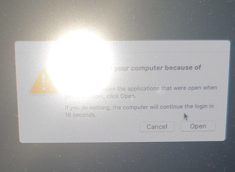

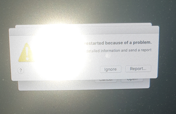

fgxr8 Posted April 18, 2020 Author Share Posted April 18, 2020 ok I have managed to get catalina up and running with a a bunch of different efi and modificaitosn from various places but i now have 2 issues when i first login display is to one half od my monitor before it goes back to full screen then get this error every time i log in (apologies for the flash) it says the computer restared incorrectly and bunch of apps say they clsoed unexpectedly even though i pressed shut down? see efi and pics EFI.zip Link to comment https://www.insanelymac.com/forum/topic/343468-strix-390-f-and-9600k-build-efi-request/#findComment-2718014 Share on other sites More sharing options...
fgxr8 Posted April 19, 2020 Author Share Posted April 19, 2020 (edited) panic(cpu 3 caller 0xffffff800f0652fa): Kernel trap at 0xffffff800ef73e2b, type 14=page fault, registers: CR0: 0x0000000080010033, CR2: 0x0000000000000060, CR3: 0x000000084c18805f, CR4: 0x00000000003626e0 RAX: 0x0000000000000060, RBX: 0xffffff8060fa1a40, RCX: 0x0000000000000000, RDX: 0xffffff800f8a1e00 RSP: 0xffffff83b97c3bb0, RBP: 0xffffff83b97c3bf0, RSI: 0xffffff800fa3c2a0, RDI: 0x0000000000000000 R8: 0x0000000000000000, R9: 0x0000000000000003, R10: 0x0000000000060200, R11: 0x0000000140000100 R12: 0xffffff805f341301, R13: 0xffffff805f341308, R14: 0xffffff805f341360, R15: 0xffffff83b97c3bc0 RFL: 0x0000000000010246, RIP: 0xffffff800ef73e2b, CS: 0x0000000000000008, SS: 0x0000000000000010 Fault CR2: 0x0000000000000060, Error code: 0x0000000000000002, Fault CPU: 0x3, PL: 0, VF: 0 Backtrace (CPU 3), Frame : Return Address 0xffffff83b97c3610 : 0xffffff800ef3bb2b 0xffffff83b97c3660 : 0xffffff800f0734d5 0xffffff83b97c36a0 : 0xffffff800f064f4e 0xffffff83b97c36f0 : 0xffffff800eee2a40 0xffffff83b97c3710 : 0xffffff800ef3b217 0xffffff83b97c3810 : 0xffffff800ef3b5fb 0xffffff83b97c3860 : 0xffffff800f6d2aa9 0xffffff83b97c38d0 : 0xffffff800f0652fa 0xffffff83b97c3a50 : 0xffffff800f064ff8 0xffffff83b97c3aa0 : 0xffffff800eee2a40 0xffffff83b97c3ac0 : 0xffffff800ef73e2b 0xffffff83b97c3bf0 : 0xffffff800ef73663 0xffffff83b97c3c10 : 0xffffff800ef13be8 0xffffff83b97c3c80 : 0xffffff800ef1365d 0xffffff83b97c3ce0 : 0xffffff800ef12e6b 0xffffff83b97c3d00 : 0xffffff800ef2a057 0xffffff83b97c3d60 : 0xffffff800ef29e7a 0xffffff83b97c3d90 : 0xffffff800ef7a724 0xffffff83b97c3de0 : 0xffffff800f439e21 0xffffff83b97c3e40 : 0xffffff800f439750 0xffffff83b97c3eb0 : 0xffffff800f43d65e 0xffffff83b97c3f40 : 0xffffff800f59b08a 0xffffff83b97c3fa0 : 0xffffff800eee3206 BSD process name corresponding to current thread: com.apple.audio. Mac OS version: 19D76 Kernel version: Darwin Kernel Version 19.3.0: Thu Jan 9 20:58:23 PST 2020; root:xnu-6153.81.5~1/RELEASE_X86_64 Kernel UUID: A8DDE75C-CD97-3C37-B35D-1070CC50D2CE Kernel slide: 0x000000000ec00000 Kernel text base: 0xffffff800ee00000 __HIB text base: 0xffffff800ed00000 System model name: iMac19,1 (Mac-AA95B1DDAB278B95) System shutdown begun: NO Panic diags file available: YES (0x0) System uptime in nanoseconds: 14372805165 last loaded kext at 14348421293: >!AGraphicsDevicePolicy 4.7.2 (addr 0xffffff7f902df000, size 86016) loaded kexts: com.intel.driver.EnergyDriver 3.6.1 com.symantec.ips.kext 14.2.1f98 com.symantec.nfm.kext 14.2.1f98 com.symantec.internetSecurity.kext 14.2.1f98 at.obdev.nke.LittleSnitch 5430 com.metakine.handsoff.driver 4.4.1 ru.joedm.SMCSuperIO 1.1.2 as.acidanthera.mieze.!IMausi 1.0.2 as.vit9696.SMCProcessor 1.1.2 as.lvs1974.AirportBrcmFixup 2.0.6 as.vit9696.!AALC 1.4.8 as.acidanthera.BrcmFirmwareStore 2.5.2 ru.usrsse2.SMCBatteryManager 1 ru.usrsse2.SMCLightSensor 1 as.vit9696.VirtualSMC 1.1.2 com.rehabman.driver.USBInjectAll 0.7.5 as.vit9696.WhateverGreen 1.3.9 as.vit9696.Lilu 1.4.4 com.symantec.SymXIPS 8.2.2 >!AGraphicsDevicePolicy 4.7.2 @AGDCPluginDisplayMetrics 4.7.2 >AudioAUUC 1.70 @private.KextAudit 1.0 >!AHV 1 |IOUserEthernet 1.0.1 |IO!BSerialManager 7.0.3f5 >pmtelemetry 1 >!A!IPCHPMC 2.0.1 @Dont_Steal_Mac_OS_X 7.0.0 >!AGFXHDA 100.1.424 >!AFIVRDriver 4.1.0 >!A!ISlowAdaptiveClocking 4.0.0 |SCSITaskUserClient 422.0.2 |IO!BUSBDFU 7.0.3f5 >!AFileSystemDriver 3.0.1 >!AVirtIO 1.0 @filesystems.hfs.kext 522.0.9 @!AFSCompression.!AFSCompressionTypeDataless 1.0.0d1 @BootCache 40 @!AFSCompression.!AFSCompressionTypeZlib 1.0.0 @filesystems.apfs 1412.81.1 >AirPort.BrcmNIC 1400.1.1 >!AAHCIPort 341.0.2 >!AACPIButtons 6.1 >!ARTC 2.0 >!AHPET 1.8 >!AACPIEC 6.1 >!ASMBIOS 2.1 >!AAPIC 1.7 $!AImage4 1 @nke.applicationfirewall 303 $TMSafetyNet 8 @!ASystemPolicy 2.0.0 |EndpointSecurity 1 >!AGraphicsControl 4.7.2 |IOAVB!F 800.17 >!ASSE 1.0 >IOPlatformPlugin!F 6.0.0d8 >!AHDA!C 283.15 |IOHDA!F 283.15 @!AGPUWrangler 4.7.2 >!ASMBusPCI 1.0.14d1 |IONDRVSupport 569.4 @kext.AMDSupport 3.0.5 @!AGraphicsDeviceControl 4.7.2 |IOGraphics!F 569.4 |IOSlowAdaptiveClocking!F 1.0.0 @plugin.IOgPTPPlugin 810.1 |IOEthernetAVB!C 1.1.0 |Broadcom!BHost!CUSBTransport 7.0.3f5 |IO!BHost!CUSBTransport 7.0.3f5 |IO!BHost!CTransport 7.0.3f5 |IO!B!F 7.0.3f5 |IO!BPacketLogger 7.0.3f5 >usb.IOUSBHostHIDDevice 1.2 >!UAudio 320.49 >usb.cdc 5.0.0 >usb.networking 5.0.0 >usb.!UHostCompositeDevice 1.2 >usb.!UHub 1.2 |IOAudio!F 300.2 @vecLib.kext 1.2.0 |IOSerial!F 11 |IOSurface 269.6 @filesystems.hfs.encodings.kext 1 |IOAHCIBlock!S 316.80.1 >usb.!UHostPacketFilter 1.0 |IOUSB!F 900.4.2 >!AXsanScheme 3 |IO80211!F 1200.12.2b1 >mDNSOffloadUserClient 1.0.1b8 >corecapture 1.0.4 |IOSkywalk!F 1 |IOAHCI!F 290.0.1 |IONVMe!F 2.1.0 >!AEFINVRAM 2.1 >usb.!UXHCIPCI 1.2 >usb.!UXHCI 1.2 >!ASMCRTC 1.0 >!AEFIRuntime 2.1 |IOHID!F 2.0.0 $quarantine 4 $sandbox 300.0 @kext.!AMatch 1.0.0d1 |IOSMBus!F 1.1 >DiskImages 493.0.0 >!AFDEKeyStore 28.30 >!AEffaceable!S 1.0 >!AKeyStore 2 >!UTDM 489.80.2 |IOSCSIBlockCommandsDevice 422.0.2 >!ACredentialManager 1.0 >KernelRelayHost 1 >!ASEPManager 1.0.1 >IOSlaveProcessor 1 |IOUSBMass!SDriver 157.40.7 |IOSCSIArchitectureModel!F 422.0.2 |IO!S!F 2.1 |IOUSBHost!F 1.2 >!UHostMergeProperties 1.2 >usb.!UCommon 1.0 >!ABusPower!C 1.0 |CoreAnalytics!F 1 >!AMobileFileIntegrity 1.0.5 @kext.CoreTrust 1 |IOTimeSync!F 810.1 |IONetworking!F 3.4 |IOReport!F 47 >!AACPIPlatform 6.1 >!ASMC 3.1.9 >watchdog 1 |IOPCI!F 2.9 |IOACPI!F 1.4 @kec.pthread 1 @kec.corecrypto 1.0 @kec.Libm 1 thats the error message when i click on report config.plist Edited April 19, 2020 by fgxr8 Link to comment https://www.insanelymac.com/forum/topic/343468-strix-390-f-and-9600k-build-efi-request/#findComment-2718147 Share on other sites More sharing options...
flamedodger Posted April 23, 2020 Share Posted April 23, 2020 In your drivers setup, you have EMUVariableUEFI.efi which is only needed if you are going to emulate nvram. NVRAM emulation is no longer needed using Z390 mainboards. You can remove it, but you will need to add SSDT-PMC.aml to ACPI/patched and may need to add slide=0 boot arg. Your config.plist is showing as iMac18,1 not recommended for Catalina, use iMac19,1. I have the same hardware more or less than you, I only use the following acpi patches; change SATA0 to SATA RTC BIOS BUG ECO TO EC Bios Configuration Plug your monitor into your video cards DisplayPort to avoid graphics issues. You can use HDMI if it's all you have Start your machine and use 1 of these methods to get onto BIOS during boot: a) Rapidly tap the delete key b) Rapidly tap the F2 key (some keyboards may need to have the Function key held down) c) Press and hold the Function key while rapidly tapping the Backspace key Check the BIOS version and update it if it is not the latest one If you have previously set your BIOS, it would be best to do a CMOS reset by shorting the 2 pins on the front left corner of your motherboard. Please se instructions for complete details In the main screen middle left, set X.M.P. to Enabled Advanced Items > CPU Configuration > Intel (VMX) Virtualization Technology > Enable - Absolutely required for Parallels Advanced Items > System Agent (SA) Graphics Configuration > Primary Display > PEG for DGPU, CPU for IGPU Advanced Items > System Agent (SA) Graphics Configuration > IGPU Multi-Monitor > Enabled for DGPU, Disabled for IGPU Save and reboot to activate the RC6 and DVMT settings Advanced Items > System Agent (SA) Graphics Configuration > RC6(Render Standby) > Off - This settings disables a power saving feature that could potentially crash the system Advanced Items > System Agent (SA) Configuration > Above 4G Decoding > Enable Advanced Items > System Agent (SA) Graphics Configuration > DVMT Pre-Allocated > 128 Advanced Items > USB Configuration > Legacy USB Support > Disabled Advanced Items > USB Configuration > XHCI Hand Off > Enable Disable serial ports Boot Menu > Boot Option 1 > UEFI USB installer drive (or whatever you named it, UEFI will be automatically prepended) Exit > Save Change SSDT-PMC.aml Link to comment https://www.insanelymac.com/forum/topic/343468-strix-390-f-and-9600k-build-efi-request/#findComment-2718893 Share on other sites More sharing options...
