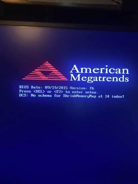

tommymckinley Posted April 13, 2020 Share Posted April 13, 2020 Hi Any id on what this error means? Thanks in advance! Link to comment https://www.insanelymac.com/forum/topic/343415-error-on-boot-ocs-no-schema-for-shrinkmemorymap-at-14-index/ Share on other sites More sharing options...
ad911 Posted April 14, 2020 Share Posted April 14, 2020 the Key "ShrinkMemoryMap" is an invalid entry make sure that the config.plist version matched the OpenCore version that you are using read the OpenCore documentation, what should be the the correct setting Link to comment https://www.insanelymac.com/forum/topic/343415-error-on-boot-ocs-no-schema-for-shrinkmemorymap-at-14-index/#findComment-2717336 Share on other sites More sharing options...
toothjockey Posted April 25, 2020 Share Posted April 25, 2020 I have the EXACT same error and it's driving me crazy! Did you figure it out? It doesn't seem to effect anything. It's just annoying. Link to comment https://www.insanelymac.com/forum/topic/343415-error-on-boot-ocs-no-schema-for-shrinkmemorymap-at-14-index/#findComment-2719317 Share on other sites More sharing options...
foster Posted April 26, 2020 Share Posted April 26, 2020 That means the item named in the error is no longer valid or has been renamed Like others have said check config.plist against configuration pdf example in latest 0.5.8 uefi > protocols has been renamed Link to comment https://www.insanelymac.com/forum/topic/343415-error-on-boot-ocs-no-schema-for-shrinkmemorymap-at-14-index/#findComment-2719326 Share on other sites More sharing options...
ad911 Posted April 27, 2020 Share Posted April 27, 2020 On 4/26/2020 at 6:31 AM, toothjockey said: I have the EXACT same error and it's driving me crazy! Did you figure it out? It doesn't seem to effect anything. It's just annoying. you don't read the documentation, the key "ShrinkMemoryMap" has been removed in OpenCore 0.5.7 even in the change log, already mentioned that, OpenCore is still in development, spend some time, read the documentation what's has been changed v0.5.7 Added TimeMachine detection to picker Added early preview version of OpenCanopy Fixed FS discovery on NVMe with legacy drivers Added DirectGopCacheMode option for FB cache policy Added KeyFiltering option to workaround buggy KB drivers Added tool and custom entry separation in audio assistant Added OpenControl tool to configure full NVRAM access from Shell Added boot.efi debug protocol support for 10.15.4+ Added boot.efi performance logging for 10.15.4+ Added ProtectUefiServices quirk to fix DevirtualiseMmio on Z390 Replaced BOOTCAMP Windows with Windows to match the original Added bundled OpenShell originally available as OpenCoreShell Rework readlabel utility into disklabel with encoding support Renamed FwRuntimeServices driver to OpenRuntime Renamed AppleUsbKbDxe driver to OpenUsbKbDxe Update builtin firmware Fixed PowerTimeoutKernelPanic on 10.15.4 Fixed 4K section alignment in OpenRuntime to fix Linux booting on SKL Introduced SyncRuntimePermissions to fix multiple memory permission flaws Introduced RebuildAppleMemoryMap to fix macOS booting on Dell 5490 Removed ShrinkMemoryMap in favour of more advanced RebuildAppleMemoryMap Marked EnableWriteUnprotector as deprecated on modern systems Introduced ProtectMemoryRegions to fix memory region handling Removed ProtectCsmRegion in favour of ProtectMemoryRegions Renamed PickerAttributes to ConsoleAttributes Introduced PickerAttributes as a matter of UI configuration Link to comment https://www.insanelymac.com/forum/topic/343415-error-on-boot-ocs-no-schema-for-shrinkmemorymap-at-14-index/#findComment-2719574 Share on other sites More sharing options...
toothjockey Posted April 29, 2020 Share Posted April 29, 2020 On 4/26/2020 at 11:01 PM, ad911 said: you don't read the documentation, the key "ShrinkMemoryMap" has been removed in OpenCore 0.5.7 even in the change log, already mentioned that, OpenCore is still in development, spend some time, read the documentation what's has been changed v0.5.7 Added TimeMachine detection to picker Added early preview version of OpenCanopy Fixed FS discovery on NVMe with legacy drivers Added DirectGopCacheMode option for FB cache policy Added KeyFiltering option to workaround buggy KB drivers Added tool and custom entry separation in audio assistant Added OpenControl tool to configure full NVRAM access from Shell Added boot.efi debug protocol support for 10.15.4+ Added boot.efi performance logging for 10.15.4+ Added ProtectUefiServices quirk to fix DevirtualiseMmio on Z390 Replaced BOOTCAMP Windows with Windows to match the original Added bundled OpenShell originally available as OpenCoreShell Rework readlabel utility into disklabel with encoding support Renamed FwRuntimeServices driver to OpenRuntime Renamed AppleUsbKbDxe driver to OpenUsbKbDxe Update builtin firmware Fixed PowerTimeoutKernelPanic on 10.15.4 Fixed 4K section alignment in OpenRuntime to fix Linux booting on SKL Introduced SyncRuntimePermissions to fix multiple memory permission flaws Introduced RebuildAppleMemoryMap to fix macOS booting on Dell 5490 Removed ShrinkMemoryMap in favour of more advanced RebuildAppleMemoryMap Marked EnableWriteUnprotector as deprecated on modern systems Introduced ProtectMemoryRegions to fix memory region handling Removed ProtectCsmRegion in favour of ProtectMemoryRegions Renamed PickerAttributes to ConsoleAttributes Introduced PickerAttributes as a matter of UI configuration What the hell does that have to do with the boot error? Just criticizing me doesn't help unless that was your goal. I've tried removing the line with RebuildAppleMemoryMap and no change. I'm on OC 0.5.7. Any suggestions? Link to comment https://www.insanelymac.com/forum/topic/343415-error-on-boot-ocs-no-schema-for-shrinkmemorymap-at-14-index/#findComment-2719918 Share on other sites More sharing options...
