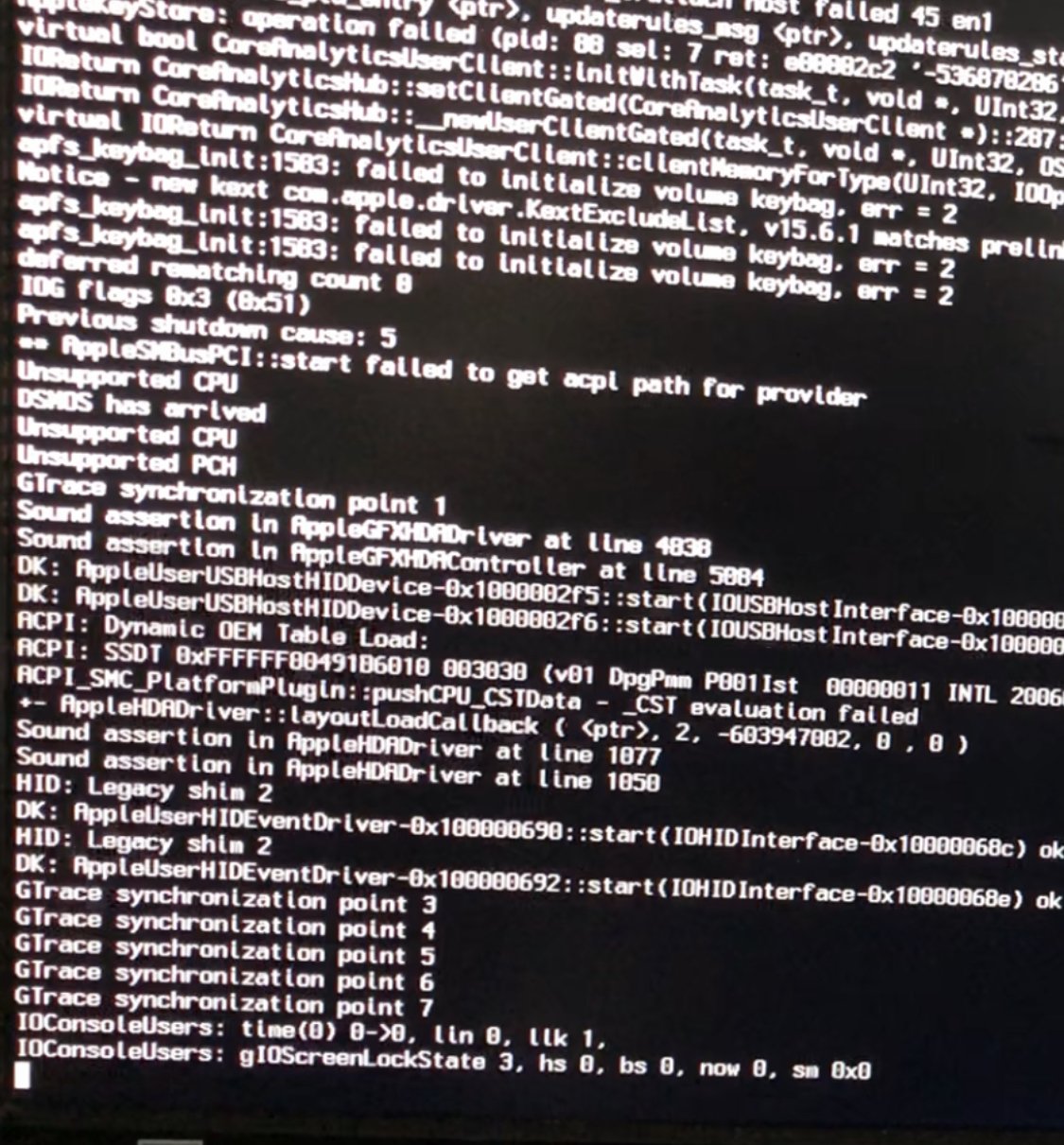

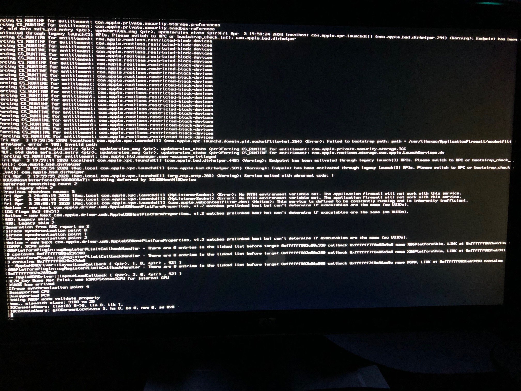

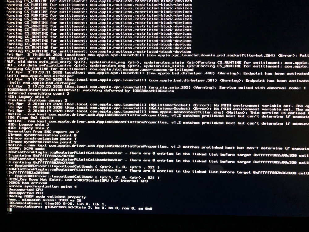

TimothyF Posted April 4, 2020 Share Posted April 4, 2020 My steps so far: Set up Catalina install USB exactly according to Plain Vanilla guide. Disconnect my Windows drive in PC, so that only the empty Hard Drive is connected to Motherboard. Boot to USB, select Install Catalina option. BIOS set to UEFI, Safe mode Off. Always get stuck at the same IOconsoleUsers: GIOScreenLockState point. Tried -radvesa, -radoff, nv-disable=0 boot options (separately), and disabling BIOS virtualization (vt-d) -> NO luck. This from the top search result https://www.reddit.com/r/hackintosh/comments/b5a6ry/ioconsoleusersgioscreenlockstate_3_blackscreen/ Screen pics attached. Here are the last couple of lines that could be important: GTrace synchronization point 4 Unsupported CPU Unsupported PCH Adding ADGP mode validate property hmm.. mismatch sizes 3100 vs 20 IOConsoleUsers: time(0) 0->0, lin 0, llk 1, IOconsoleUsers: gIOScreenLockState 3, hs 0, bs 0, now 0, sm 0x0 Please give me some ideas what else might work. Thank you. Other details of Clover and Desktop PC below: Clover USB specs OS installer used: Catalina (10.15) Clover revision: 5103 Kexts included: ATH9KFixup.kext AppleALC.kext Lilu.kext RealtekRTL8111.kext USBInjectAll.kext VirtualSMC.kext WhateverGreen.kext config.plist: config.plist ------------------------------------------ Target Desktop specs: Dell Inspiron 3847 (64 bit) CPU: Intel Core i5-4460, 3.2 GHz, 4 cores Architecture: Haswell GPU: Intel HD 4600 Motherboard: Dell 088DT1 (version A01) Chipset: Intel H81 Install method: with USB, configured with Clover, 100% following Plain Vanilla guide for Desktops RAM: 12 GB, 2 slots Hard drive for installation: SATA HDD 4TB, by HGST LAN: RTL8111/8168/8411 WLAN: AR9565 (atheros) Audio: Realtek ALC661 (not 100% sure this is correct) Link to comment https://www.insanelymac.com/forum/topic/343249-stuck-at-ioconsoleusers-gioscreenlockstate-3-dell-desktop-inspiron-3847-i5-4460/ Share on other sites More sharing options...
