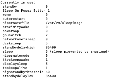

I’ve done the below per guides:
Disable Hibernation:
  • sudo pmset -a hibernatemode 0
  • sudo rm /var/vm/sleepimage
  • sudo mkdir /var/vm/sleepimage
Disable other hibernation options:
  • sudo pmset -a standby 0
  • sudo pmset -a autopoweroff 0
Turned off in settings:
  • Allow Bluetooth devices to wake up this machine
  • Enable power nap
  • Wake for network access
Does anyone have any idea what could be causing these 4 constant wake up codes and ideas on how to fix?

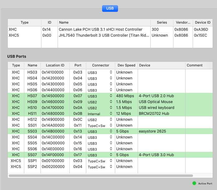

I have recently changed HS11 port type to Internal but it seems that I am still getting errors in the log.
I am on opencore 0.5.6 / Catalina 10.15.4 and built a USBMAP.KEXT file which I have also attached.
USBPorts.kext.zip
