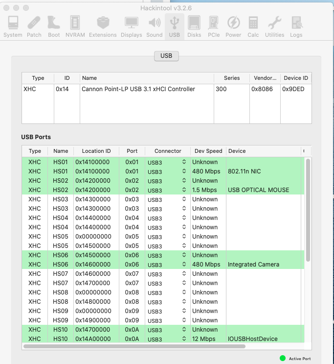

I've just realized that I have some problem with USB Port on my laptop. The case are like this:
1. While I plug USB WiFi into USB Port on the right side (on the right side have two port, all the port are USB 3.0), the Wifi is normal without any problem. But,
2. While I add USB 3.0 storage device, (the condition is port 1 for USB Wifi and port 2 for storage device, use them together) like Flashdisk or External Drive, the wifi suddenly stop working. The wifi isn't disconnect, but I can't use the connection to browsing/surfing.
3. The laptop has USB C too, but the USB not interference the USB 3.0 ports
Does anyone here know what's the solution to makes the USB normal?
Looking forward for any help.
Thank you.
