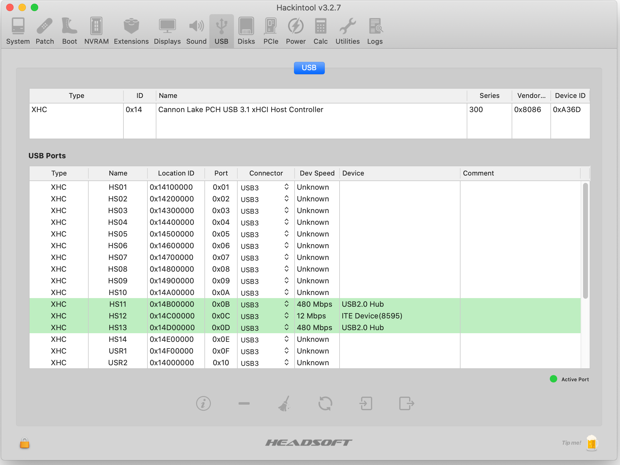

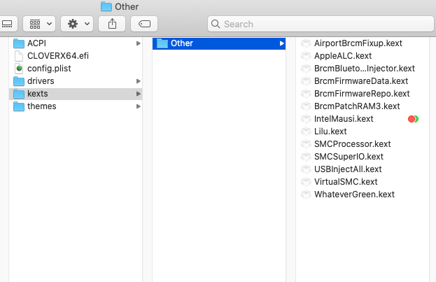

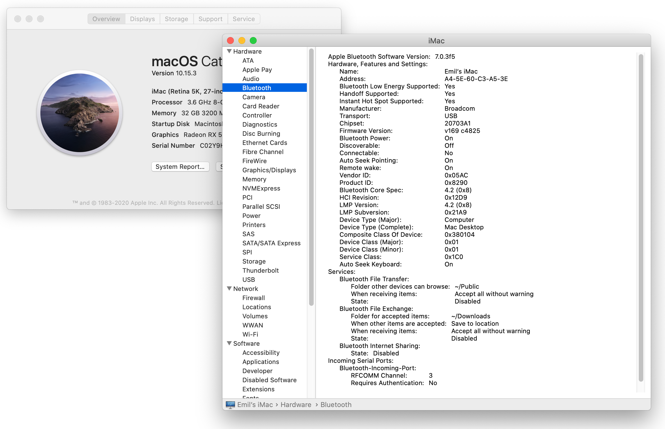

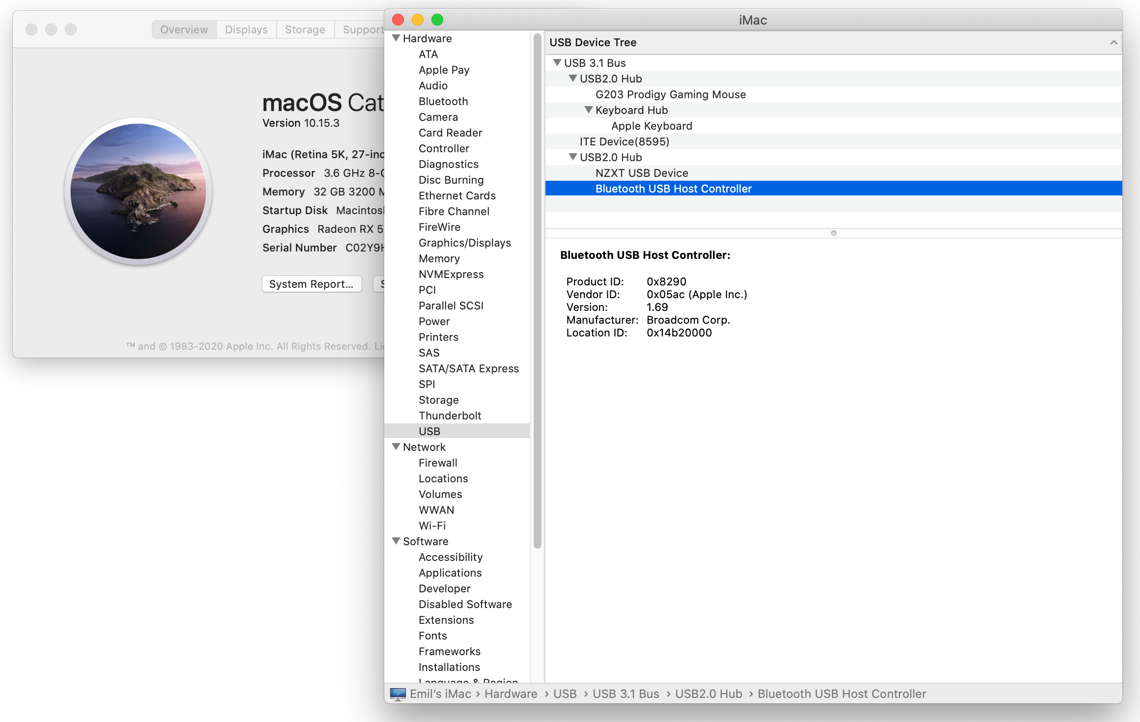

Emek Posted March 14, 2020 Share Posted March 14, 2020 Hi, I'm having trouble connecting my bt devices using bcm943602cs combo card. Wifi is working. Am I missing something? I thought it's plug and play. I've tried these kexts: BrcmBluetoothInjector.kext BrcmFirmwareRepo.kext BrcmPatchRAM3.kext ...and many many other solutions inc installing kext using hackintool to L/E Help me good ppl! Screenshots attached. PS: With bluetooth dongle + BrcmPatchRAM2.kext everything works fine. PS: I using this conf with 9700k and RX580: Link to comment https://www.insanelymac.com/forum/topic/342992-bluetooth-bcm943602cs-on-catalina-doesnt-work/ Share on other sites More sharing options...
emistral Posted May 20, 2020 Share Posted May 20, 2020 Hi there, Not sure if it will help but I had the same issue but with the bcm943602cs card. Wifi worked out of the box but not bluetooth. I initially had brcmp patches in teh \OTHER folder in clover EFI partition but it did not work. After scouring the net all over I found what worked at least for me: - get rod of brcm patches in \OTHER. My understanding is that because this card is a genuine apple card, those kexts are not needed - in the config plist (loaded in clover configurator after mounting the EFI partition), I had to remap the USB ports. Changing EHC1 to EH01 and EHC2 to EH02 in the acpi section - finally I installed usbinjectall (something like that) in /Library/Extension (I followed the guide of that kext of github) Rebooted and then I could see the BT card and pair all my BT devices (magic mouse, magic kb and yamaha soundbar) Link to comment https://www.insanelymac.com/forum/topic/342992-bluetooth-bcm943602cs-on-catalina-doesnt-work/#findComment-2723068 Share on other sites More sharing options...
