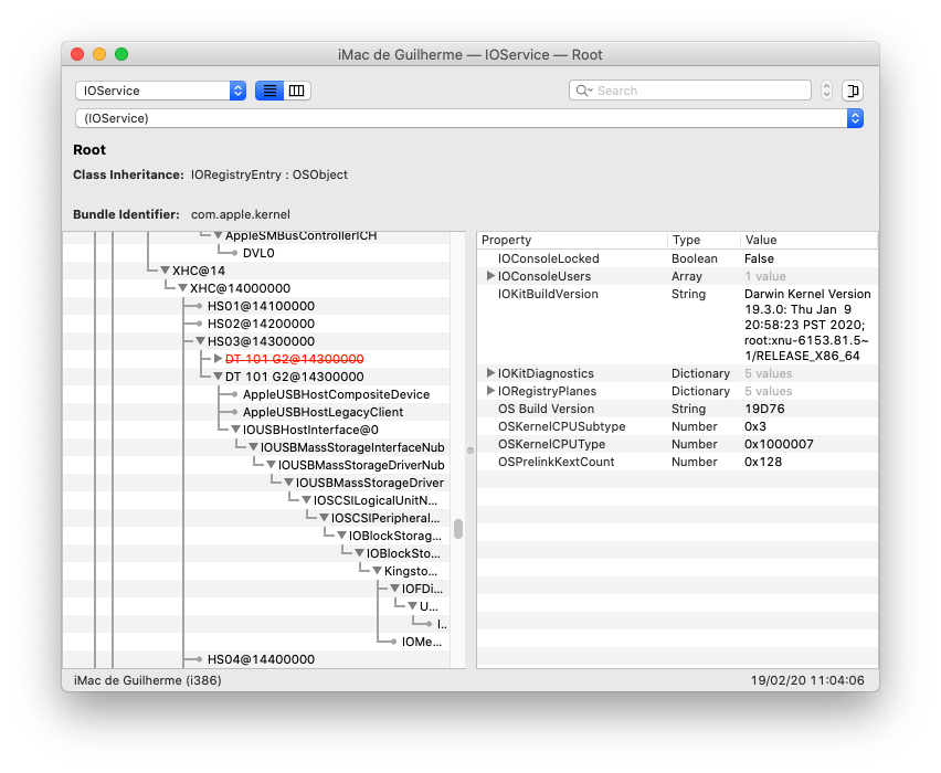

lai0n Posted February 19, 2020 Share Posted February 19, 2020 Motherboard: H110M PRO-VH PLUS Clover version: 5104 I installed USBInjectAll.kext and added USB Port-Limit Removal Patch <key>KextsToPatch</key> <array> <dict> <key>Disabled</key> <false /> <key>Find</key> <data>g/sPDw==</data> <key>InfoPlistPatch</key> <false /> <key>Name</key> <string>com.apple.iokit.IOUSBHostFamily</string> <key>Replace</key> <data>g/s/Dw==</data> </dict> <dict> <key>Disabled</key> <false /> <key>Find</key> <data>g/kPDw==</data> <key>InfoPlistPatch</key> <false /> <key>Name</key> <string>com.apple.driver.usb.AppleUSBXHCI</string> <key>Replace</key> <data>g/k/Dw==</data> </dict> </array> But when I connect to rear usb3 port, it shows as HS(usb2) instead of SS Ioreg and screenshot attached araujo@iMac-de-Guilherme ~ % sudo kextcache -i / Password: Kext with invalid signature (-67062) allowed: <OSKext 0x7fb724603600 [0x7fff87b1a690]> { URL = "file:///Library/Extensions/VirtualSMC.kext/", ID = "as.vit9696.VirtualSMC" } Kext with invalid signature (-67062) allowed: <OSKext 0x7fb724403160 [0x7fff87b1a690]> { URL = "file:///Library/Extensions/Lilu.kext/", ID = "as.vit9696.Lilu" } Kext with invalid signature (-67062) allowed: <OSKext 0x7fb724600d20 [0x7fff87b1a690]> { URL = "file:///Library/Extensions/USBInjectAll.kext/", ID = "com.rehabman.driver.USBInjectAll" } Kext with invalid signature (-67062) allowed: <OSKext 0x7fb724602fe0 [0x7fff87b1a690]> { URL = "file:///Library/Extensions/RealtekRTL8111.kext/", ID = "com.insanelymac.RealtekRTL8111" } Kext with invalid signature (-67062) allowed: <OSKext 0x7fb724464fd0 [0x7fff87b1a690]> { URL = "file:///Library/Extensions/WhateverGreen.kext/", ID = "as.vit9696.WhateverGreen" } Kext with invalid signature (-67062) allowed: <OSKext 0x7fb724406070 [0x7fff87b1a690]> { URL = "file:///Library/Extensions/AppleALC.kext/", ID = "as.vit9696.AppleALC" } KernelCache ID: 9E8B16C7466CD54607F1805E90BF5BE1 Kext with invalid signature (-67062) allowed: <OSKext 0x7fb06840bff0 [0x7fff87b1a690]> { URL = "file:///Library/Extensions/Lilu.kext/", ID = "as.vit9696.Lilu" } Kext with invalid signature (-67062) allowed: <OSKext 0x7fb0684108d0 [0x7fff87b1a690]> { URL = "file:///Library/Extensions/AppleALC.kext/", ID = "as.vit9696.AppleALC" } Kext with invalid signature (-67062) allowed: <OSKext 0x7fb06ab4ea70 [0x7fff87b1a690]> { URL = "file:///Library/Extensions/WhateverGreen.kext/", ID = "as.vit9696.WhateverGreen" } Kext with invalid signature (-67062) allowed: <OSKext 0x7fb0687742a0 [0x7fff87b1a690]> { URL = "file:///Library/Extensions/RealtekRTL8111.kext/", ID = "com.insanelymac.RealtekRTL8111" } Kext with invalid signature (-67062) allowed: <OSKext 0x7fb06866f510 [0x7fff87b1a690]> { URL = "file:///Library/Extensions/USBInjectAll.kext/", ID = "com.rehabman.driver.USBInjectAll" } Kext with invalid signature (-67062) allowed: <OSKext 0x7fb06877fff0 [0x7fff87b1a690]> { URL = "file:///Library/Extensions/VirtualSMC.kext/", ID = "as.vit9696.VirtualSMC" } iMac de Guilherme.ioreg Link to comment https://www.insanelymac.com/forum/topic/342647-clover-treat-usb3-ports-as-usb2/ Share on other sites More sharing options...
MaLd0n Posted February 19, 2020 Share Posted February 19, 2020 first, use all kexts into clover/kexts/other, rebuild cache reboot and extract one dump https://www.olarila.com/files/Utils/RunMe.app.ziphttps://www.youtube.com/watch?v=k9wmIfGLe3A Link to comment https://www.insanelymac.com/forum/topic/342647-clover-treat-usb3-ports-as-usb2/#findComment-2709060 Share on other sites More sharing options...
lai0n Posted March 1, 2020 Author Share Posted March 1, 2020 Here it is Send me iMac-de-Guilherme.zip Link to comment https://www.insanelymac.com/forum/topic/342647-clover-treat-usb3-ports-as-usb2/#findComment-2710608 Share on other sites More sharing options...
