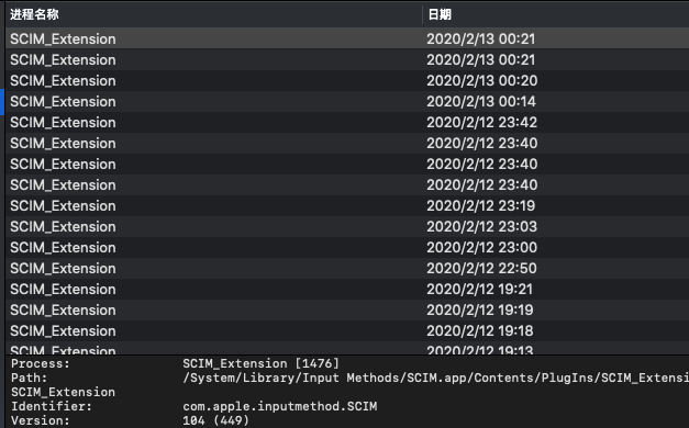

After several hours working, my "ancient" hackintosh build works fine except this problem.
Keep getting this in my system.log while typing in Chinese:
Feb 13 00:21:20 iMac-Home com.apple.xpc.launchd[1] (com.apple.inputmethod.SCIM[1471]): Service exited due to SIGILL | sent by exc handler[1471]
Feb 13 00:21:20 iMac-Home com.apple.xpc.launchd[1] (com.apple.inputmethod.SCIM[1472]): Service exited due to SIGILL | sent by exc handler[1472]
Feb 13 00:21:22 iMac-Home com.apple.xpc.launchd[1] (com.apple.inputmethod.SCIM[1473]): Service exited due to SIGILL | sent by exc handler[1473]
See this in Crash Report:
First part of Detailed report:
Process:               SCIM_Extension [3620]
Path:                  /System/Library/Input Methods/SCIM.app/Contents/PlugIns/SCIM_Extension.appex/Contents/MacOS/SCIM_Extension
Identifier:            com.apple.inputmethod.SCIM
Version:               104 (449)
Build Info:            ChineseIM-449000000000000~1174
Code Type:             X86-64 (Native)
Parent Process:        ??? [1]
Responsible:           SCIM_Extension [3620]
User ID:               501
Date/Time:             2020-02-12 23:40:24.139 +0800
OS Version:            Mac OS X 10.15.3 (19D76)
Report Version:        12
Anonymous UUID:        F074C2E8-F3D0-8140-BAD8-99597A6FC80B
Time Awake Since Boot: 17000 seconds
System Integrity Protection: disabled
Crashed Thread:        0  Dispatch queue: com.apple.main-thread
Exception Type:        EXC_BAD_INSTRUCTION (SIGILL)
Exception Codes:       0x0000000000000001, 0x0000000000000000
Exception Note:        EXC_CORPSE_NOTIFY
Termination Signal:    Illegal instruction: 4
Termination Reason:    Namespace SIGNAL, Code 0x4
Terminating Process:   exc handler [3620]
I tried 10.15.2 10.15.3 10.15.4DP. (Clean Installation: Wipe everything+MAS image) No luck.
10.14.x- are not affected.
Actually, Apple dropped support of MacPro 5,1 which has same CPU architecture as mine in macOS Catalina.
I searched for "EXC_BAD_INSTRUCTION (SIGILL)". I wonder if my CPU's ancient architecture is to blamed.
Anyone have a solution?
