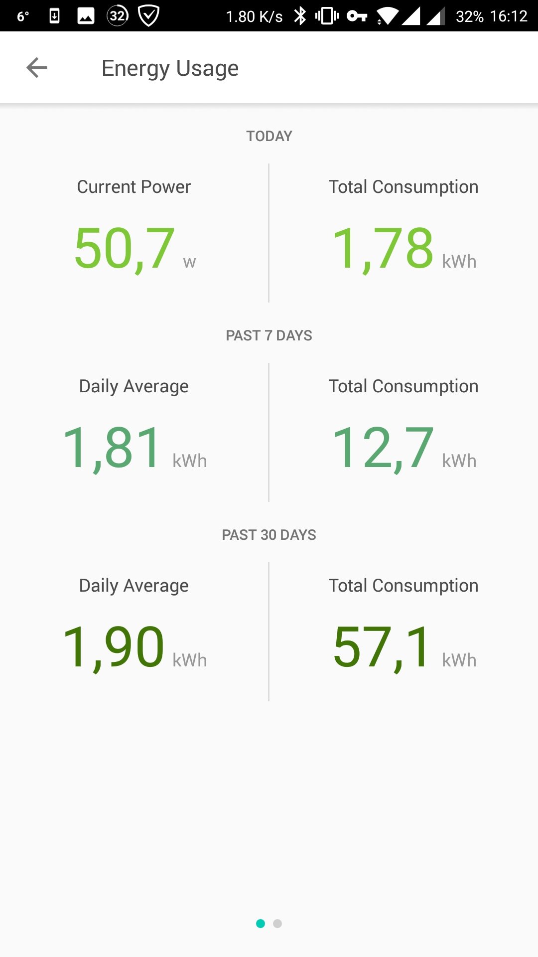

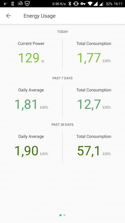

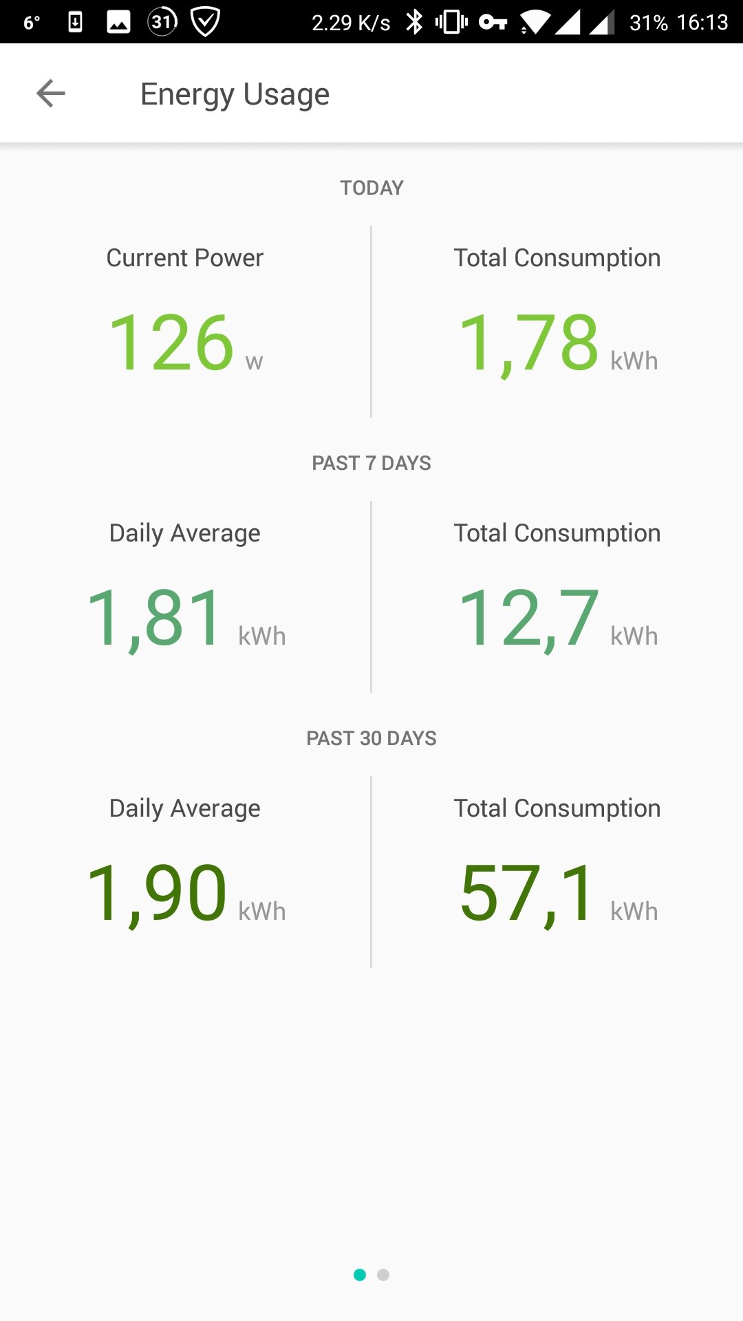

decat Posted February 4, 2020 Share Posted February 4, 2020 (edited) I do think they are not correct, started a bit of troubleshooting and searching on the net because I got a similiar setup & when having two monitors connected the RX 580's memory clock is constantly at 2Ghz. Temp of the card is around 48 to 50 on idle and therefore the vents always turn on & off. With only one monitor connected temps are 10° lower. I just measured at the wall socket moments ago: My setup: Z390 Aorus Master, 9700k, RX 580 Sapphire Nitro Pulse, Mojave & Clover. Screenshot 1 : Dual monitor setup in macOS consumes 79w on idle. Power from screens not included. Screenshot 2: system of but the NAS, router & switch are on the same socket drawing 50w Screenshot 3: dual monitor in Windows drawing 76w on idle. No screens either. iStat says that my RX 580 is taking about 90 to 100w constantly. At first I thought just like you that there might be problem, but compared to Windows it takes the same power from the wall. In Windows HWmonitior & Radeon tool says the card takes about 32w in idle. Edited February 4, 2020 by decat Link to comment https://www.insanelymac.com/forum/topic/342425-got-a-huge-power-consumption-with-my-rx580/#findComment-2707028 Share on other sites More sharing options...
unk Posted February 5, 2020 Author Share Posted February 5, 2020 15 hours ago, Andrey1970 said: VirtualSMC has no GPU sensors. Data undertake from AMD driver, but they uncorrect. Write bugreports to Apple. ok, i'll try 12 hours ago, decat said: I do think they are not correct, started a bit of troubleshooting and searching on the net because I got a similiar setup & when having two monitors connected the RX 580's memory clock is constantly at 2Ghz. Temp of the card is around 48 to 50 on idle and therefore the vents always turn on & off. With only one monitor connected temps are 10° lower. I just measured at the wall socket moments ago: My setup: Z390 Aorus Master, 9700k, RX 580 Sapphire Nitro Pulse, Mojave & Clover. Screenshot 1 : Dual monitor setup in macOS consumes 79w on idle. Power from screens not included. Screenshot 2: system of but the NAS, router & switch are on the same socket drawing 50w Screenshot 3: dual monitor in Windows drawing 76w on idle. No screens either. iStat says that my RX 580 is taking about 90 to 100w constantly. At first I thought just like you that there might be problem, but compared to Windows it takes the same power from the wall. In Windows HWmonitior & Radeon tool says the card takes about 32w in idle. thanks for your answer, now i'm not worry about the power. Link to comment https://www.insanelymac.com/forum/topic/342425-got-a-huge-power-consumption-with-my-rx580/#findComment-2707114 Share on other sites More sharing options...
