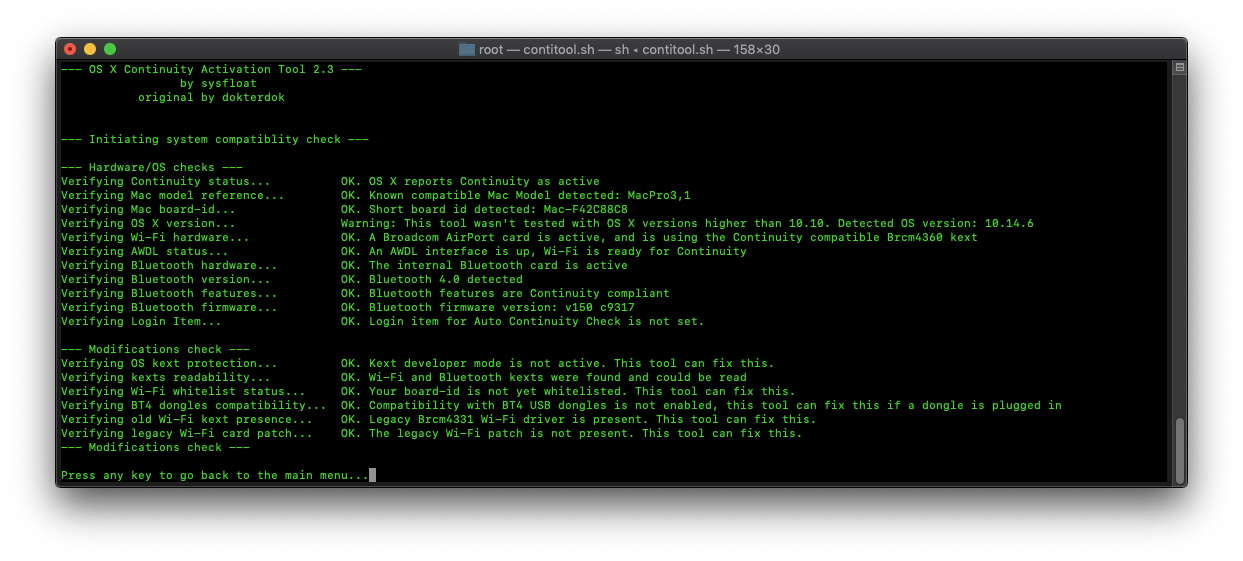

laptopleon Posted February 3, 2020 Share Posted February 3, 2020 Hi all, I installed a BCM94360CD in my Mac Pro 2008, on which I just installed the latest version of Mojave, 10.14.6, thanks to @dosdude's patcher (really, thank you!). It can take a few seconds for the Mac Pro 3,1 to show up in Airdrop, but then it works fine, both ways to and from my iPhone XR with iOS 13. However, the iPhone won't show up in Continuity Camera. I've been looking for a solution for quite a while, reading up on the Continuity Activation Tool, but it seems to be outdated and has it's functionality an – at least partially – taken over by dosdude's patcher. It says Continuity on my Mac is already activated and has a slew of analysing hints, that I'm not familiar with: Then I found the Atheros installer for macOS Mojave and Catalina. I can't figure out though, if this is applicable to my setup? I'm hesitant to use it, because I'm not sure if this is an Atheros based WiFi adapter. (Or should I just use a different WiFi/BT adapter?) Link to comment https://www.insanelymac.com/forum/topic/342413-how-to-get-continuity-camera-working-on-mac-pro-2008/ Share on other sites More sharing options...
