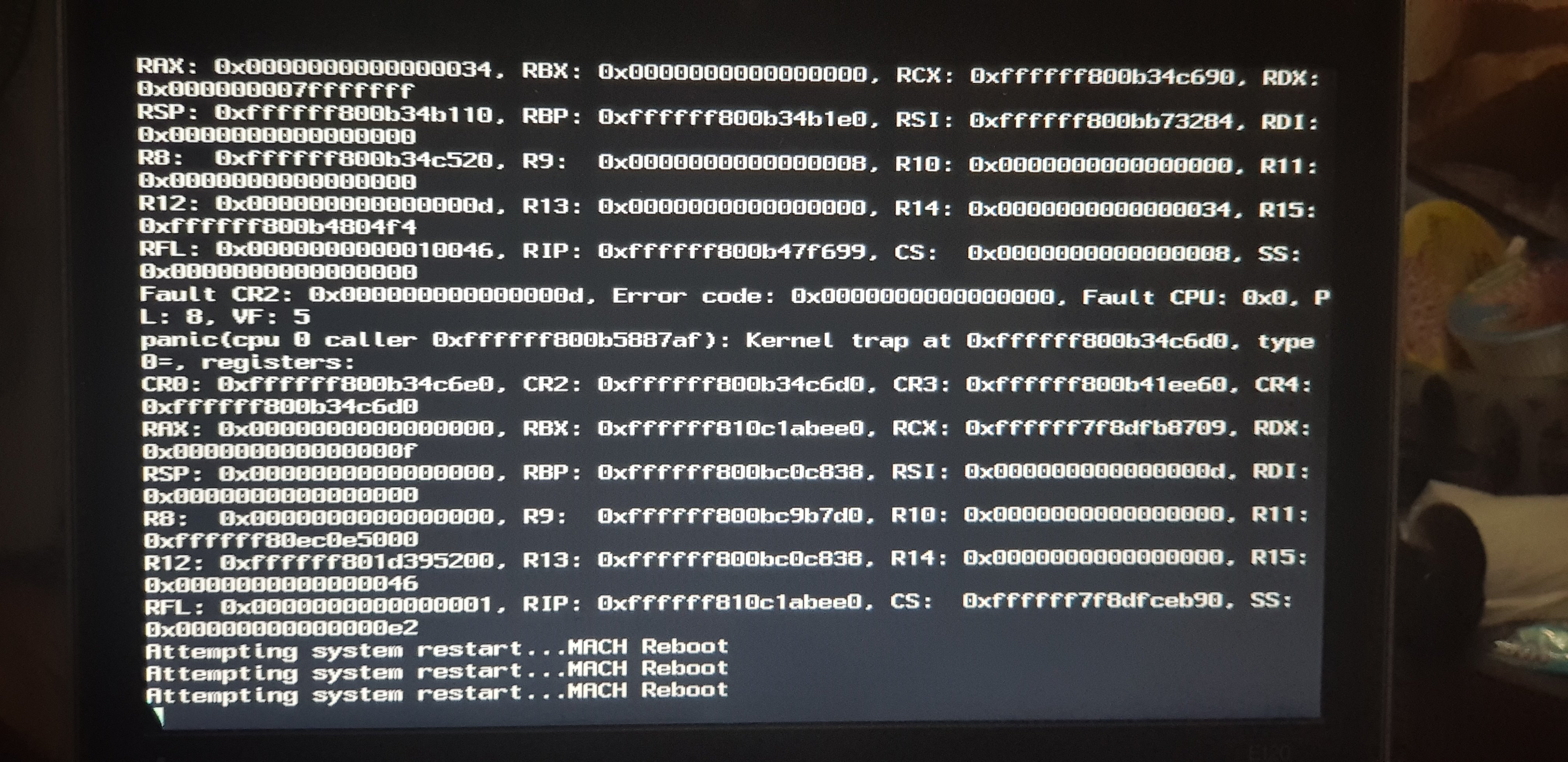

hohoho Posted January 25, 2020 Share Posted January 25, 2020 (edited) This is my first time using OC so i don't know what's wrong. It was just stuck at Mach Reboot. It was booting fine using Clover. I never had this error using clover. any help is appreciated. Thanks! My hackintosh: Lenovo E120 intel Core i3-2367M 8GB of RAM OS: MacOS High Sierra 10.13.6 and Windows 10 (dual boot - 2 partitions in 1 SSD) Kingston Sata SSD EFI.zip Edited January 25, 2020 by hohoho more info Link to comment Share on other sites More sharing options...

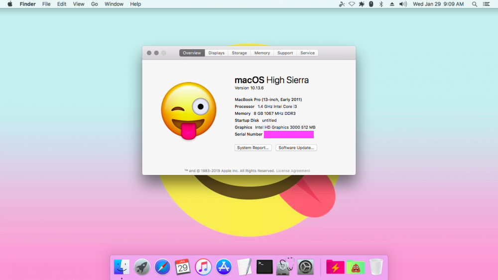

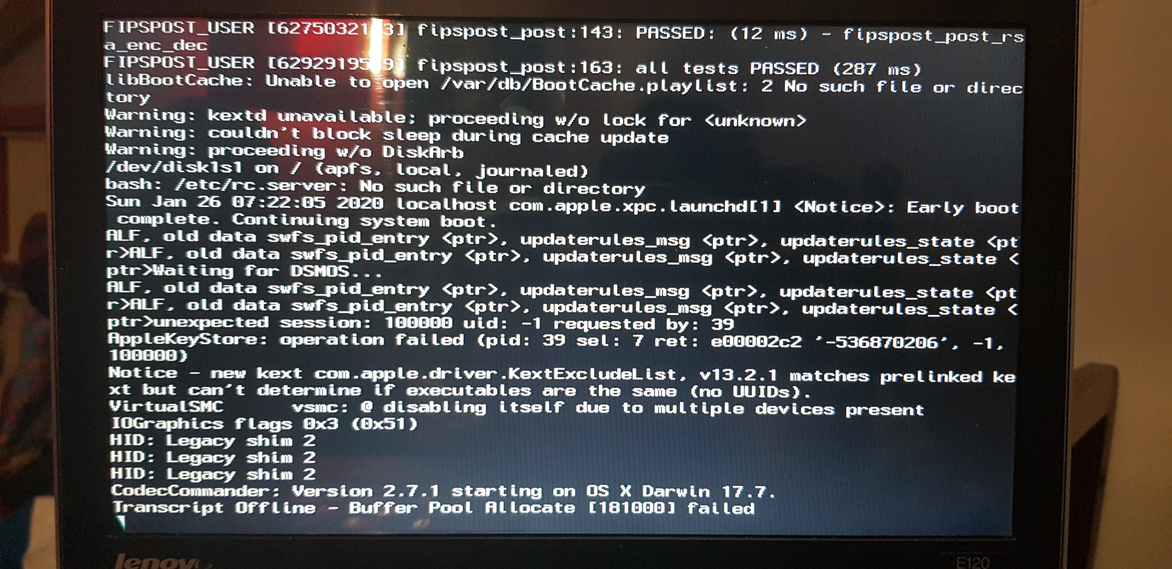

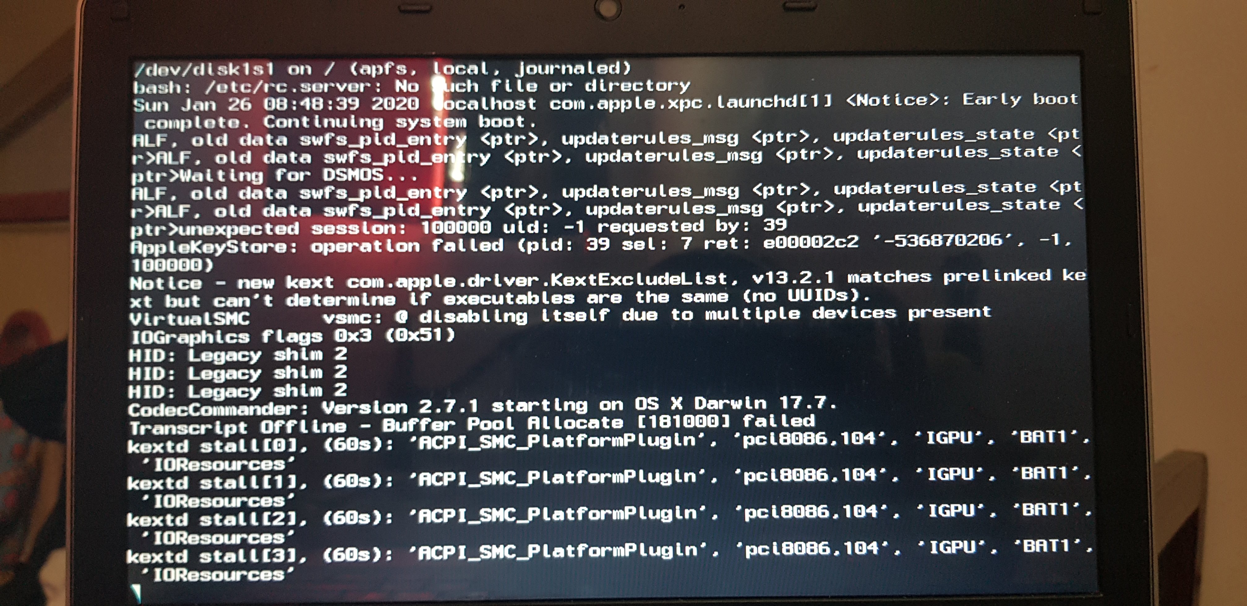

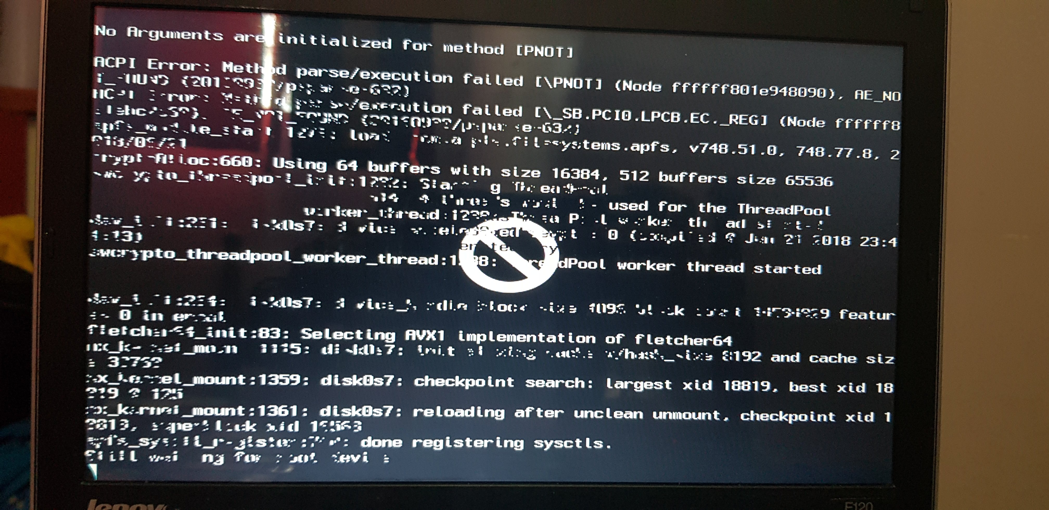

hohoho Posted January 25, 2020 Author Share Posted January 25, 2020 (edited) On 1/25/2020 at 9:58 PM, HmO said: EFI.zipEFI thanks for the reply. your efi fixed the Mach Reboot error, but now it is showing a new error that i have never seen before using clover and it's still not booting completely. my High Sierra setup was a clover setup with kexts in L/E. When i wait for several minutes, an unusual kextsstall happens and seems to be freezing there for 30 mins. or more now after kextd stall[3] . after more than 1 hour in kextd stall[3] i just forced shut down my lenovo because it was getting too hot to the touch. in clover after a few kext stalls, it usually continues to MacOS and does not appear again next time...thanks! update 1: i tried to boot the High Sierra installer with OC and your EFI but it gives an error too and does not boot to the installer and just gave me the stop sign. When using clover, i remember getting the stop sign when there were no kexts installed in the kext folder of clover. thanks update 2: i replaced virtualsmc.kext to fakesmc.kext and my hack booted with QE/CI using OC and your EFI thanks! EFI with fakesmc.zip Edited January 29, 2020 by hohoho more info Link to comment Share on other sites More sharing options...
