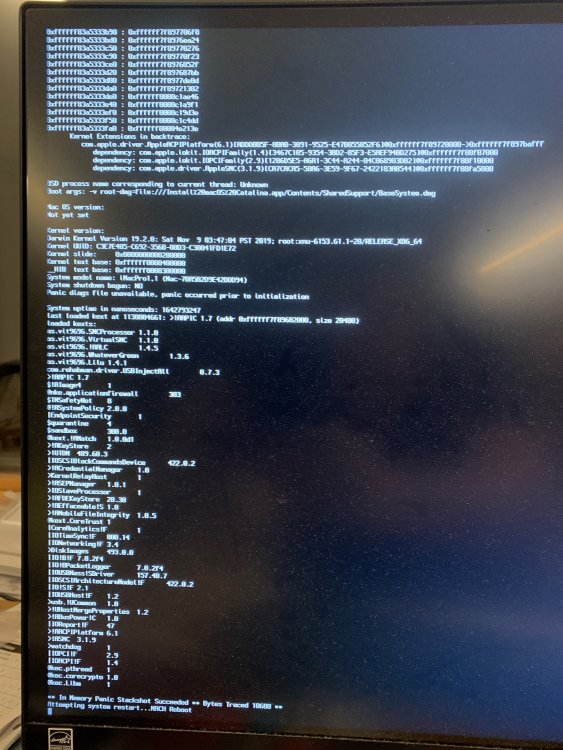

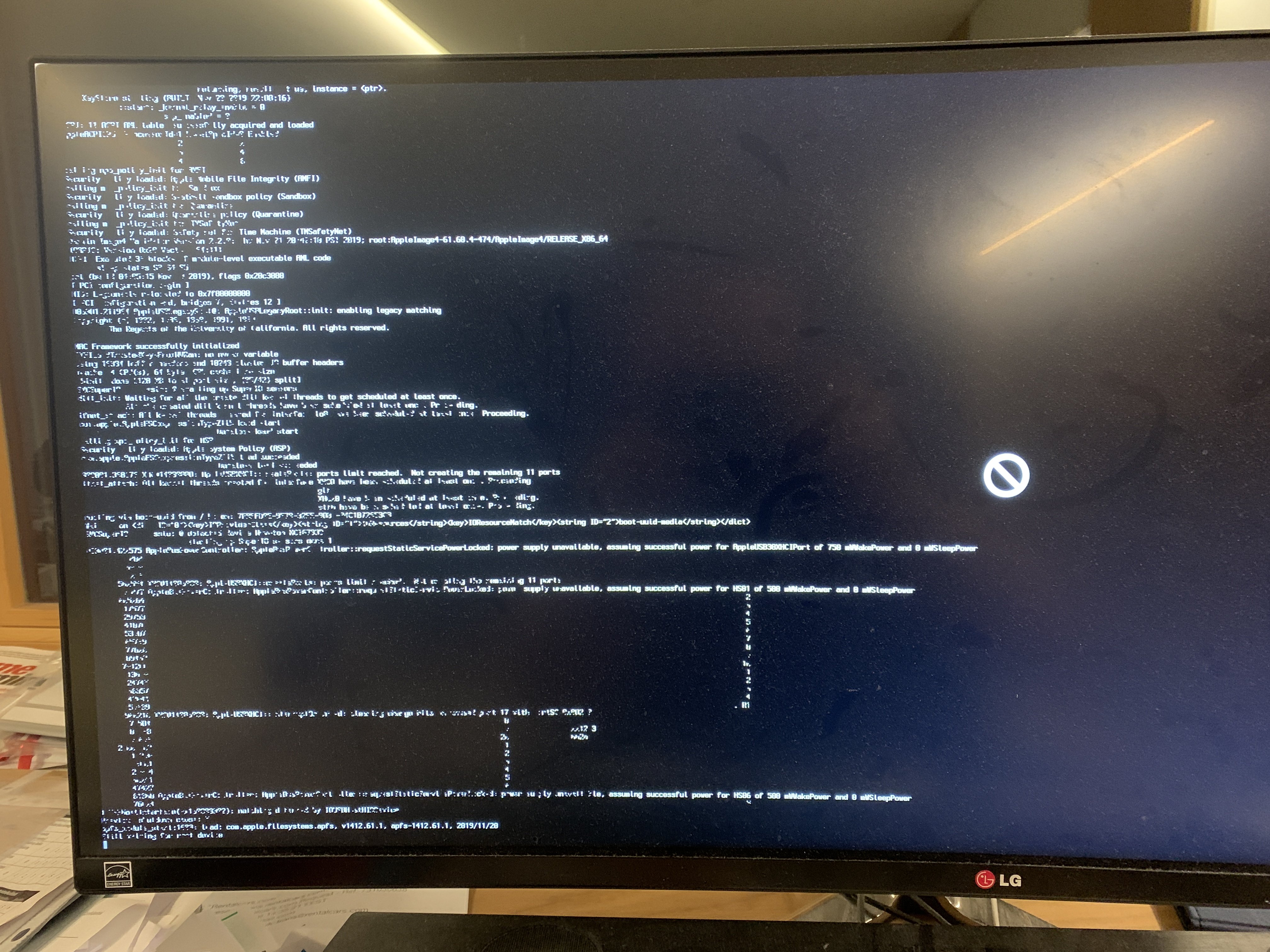

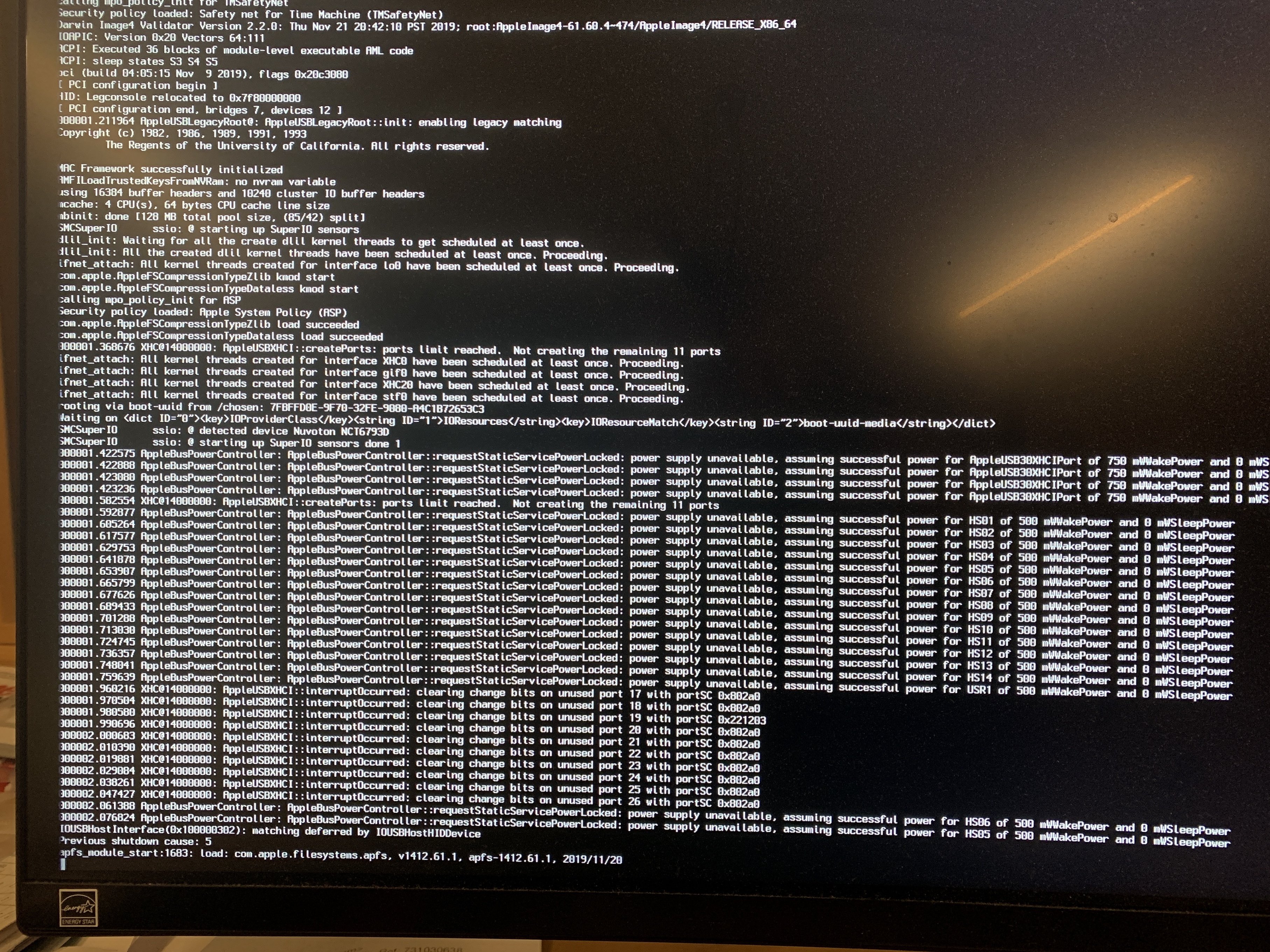

Ben282 Posted January 24, 2020 Share Posted January 24, 2020 Hi,Any help would be appreciated. Installing Catalina a clean install on:CPU: Intel Core i5-6600K CPU @ 3.5 GHzArchitecture: Skylake - 6th generation Intel CoreFamily: 6 (06h)Model: 94 (5Eh)Stepping: 3 (03h)Motherboard: Asus Z170 Pro GamingAudio: Realtek ALC1150Memory: Corsair Vengeance LED 4x8GB DDR4 3200MHz C16 - Blue LEDVideo card: Gigabyte Radeon RX 5700 XT GAMING OC 8GDestination drive: WD Blue 3D NAND SSD 2TBBIOS:Virtual-d disabled, integrated graphics disabled, serial port disabled.Created install USB with [url="http://www.insanelymac.com/forum/topic/279450-why-insanelymac-does-not-support-tonymacx86/"]#####[/url]. When loading into Catalina install after I select to boot from USB, system hangs on apfs_module_start:1683 (screenshot attached). After a while screen garbles up and a stop sign is displayed (screenshot attached).I am including clover EFI directory with all .kexts and configuration files.Read forums, tried:1. placing SSDT-EC.aml in ACPI->Patched - no effect2. placing SSDT-ECUSBX.aml in ACPI->Patched - a different crash message (screenshot attached to this message, file name "Error with SSDT-ECUSBX_aml.jpeg"). I attached "SSDT-ECUSBX.aml" to this message just in case as well. Any help would be really appreciated.-Ben EFI.zip Oher screenshots Link to comment https://www.insanelymac.com/forum/topic/342259-asus-z170-pro-gaming-problem-booting-into-installer-hanging-after-comapplefilesystemapfs/ Share on other sites More sharing options...
Ben282 Posted January 27, 2020 Author Share Posted January 27, 2020 Solved this issue with Clover configurator by changing config.plist.Kernell and kext patches -> KextsToPatch:NAME: com.apple.iokit.IOUSBHostFamily Find*:83FB0F0F Replace*:83FB3F0FNAME: com.apple.driver.usb.AppleUSBXHCI Find*:83F90F0F Replace*:83F93F0FNow testing the rest of the system. Link to comment https://www.insanelymac.com/forum/topic/342259-asus-z170-pro-gaming-problem-booting-into-installer-hanging-after-comapplefilesystemapfs/#findComment-2706041 Share on other sites More sharing options...
