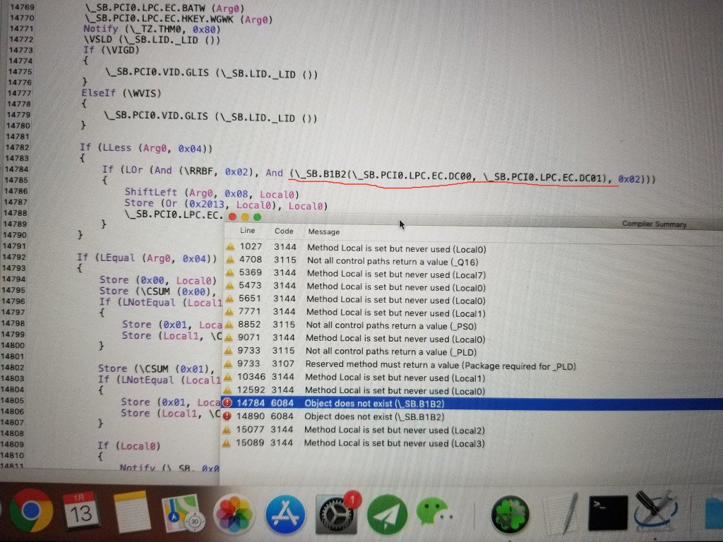

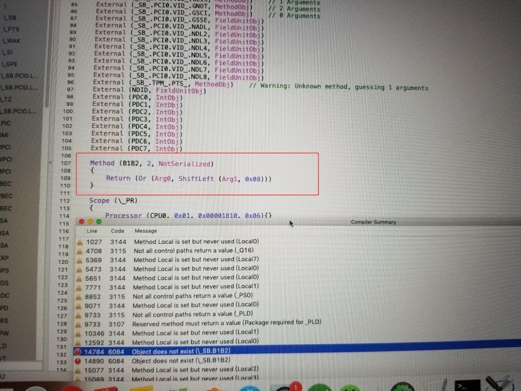

wcy233 Posted January 14, 2020 Share Posted January 14, 2020 i have already defined method B1B2 ,but compiler goes wrong.the compiler is ACPI 6.0a.what should i do next step.thank you. DSDT.dsl Link to comment Share on other sites More sharing options...
wcy233 Posted January 14, 2020 Author Share Posted January 14, 2020 5 minutes ago, Hervé said: Move your definition of Method (B1B2 ... under the 1st instance of Scope (\_SB), right above Method (_INI ... and you'll find all will be well... it works .thank you very much . Link to comment Share on other sites More sharing options...
wcy233 Posted January 14, 2020 Author Share Posted January 14, 2020 18 minutes ago, Hervé said: You make calls to (\SB.B1B2 (...)) so move your definition of Method (B1B2 (...)) under the 1st instance of Scope (\_SB), right above Method (_INI ...) and you'll find all will be well... Logical, isn't it? sorry to bother you again , compile well , but...still can't display battery level ,and if i add ACPIBatteryManager.kext , os can't run. Link to comment Share on other sites More sharing options...
