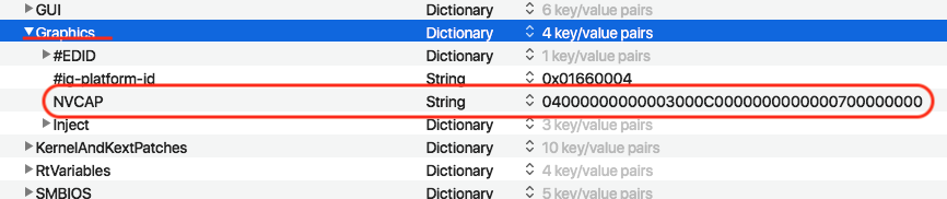

HmO Posted January 9, 2020 Share Posted January 9, 2020 Maybe edit NVCAP ? Link to comment https://www.insanelymac.com/forum/topic/342056-nvidia-9800gt-hdmi-el-capitan/#findComment-2703530 Share on other sites More sharing options...
RichieKotzen Posted January 9, 2020 Author Share Posted January 9, 2020 1 minute ago, HmO said: Maybe edit NVCAP ? what is it? Link to comment https://www.insanelymac.com/forum/topic/342056-nvidia-9800gt-hdmi-el-capitan/#findComment-2703531 Share on other sites More sharing options...

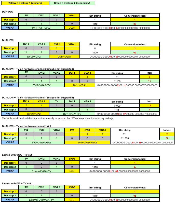

HmO Posted January 9, 2020 Share Posted January 9, 2020 This is it  Link to comment https://www.insanelymac.com/forum/topic/342056-nvidia-9800gt-hdmi-el-capitan/#findComment-2703532 Share on other sites More sharing options...
RichieKotzen Posted January 9, 2020 Author Share Posted January 9, 2020 2 minutes ago, HmO said: This is it  which is good for me? and where do I insert it? Link to comment https://www.insanelymac.com/forum/topic/342056-nvidia-9800gt-hdmi-el-capitan/#findComment-2703533 Share on other sites More sharing options...

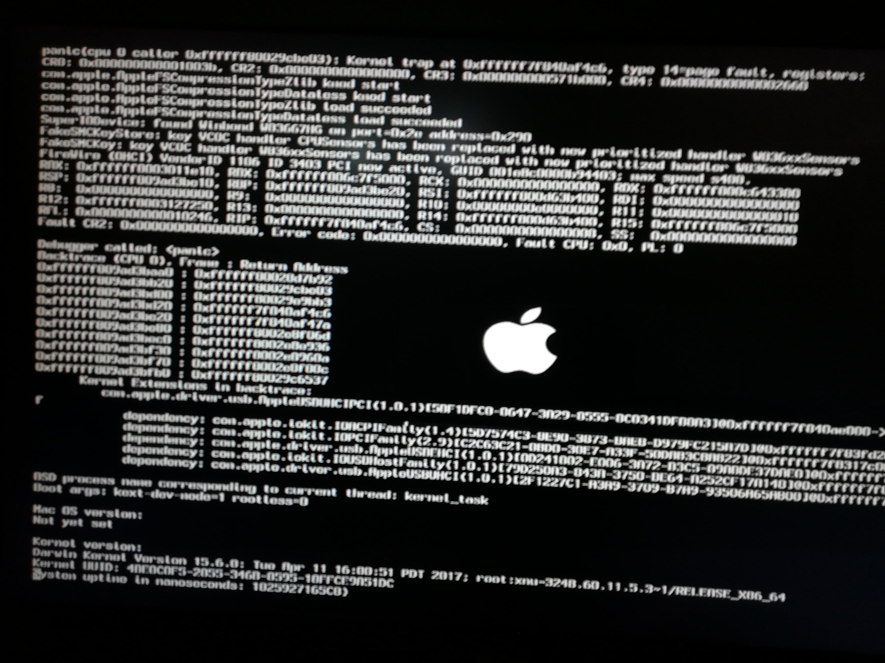

RichieKotzen Posted January 10, 2020 Author Share Posted January 10, 2020 2 hours ago, HmO said: Just put dsdt.aml into pathed folder smbios does not matter Kernel panic does NVCAP go into config? Link to comment https://www.insanelymac.com/forum/topic/342056-nvidia-9800gt-hdmi-el-capitan/#findComment-2703628 Share on other sites More sharing options...

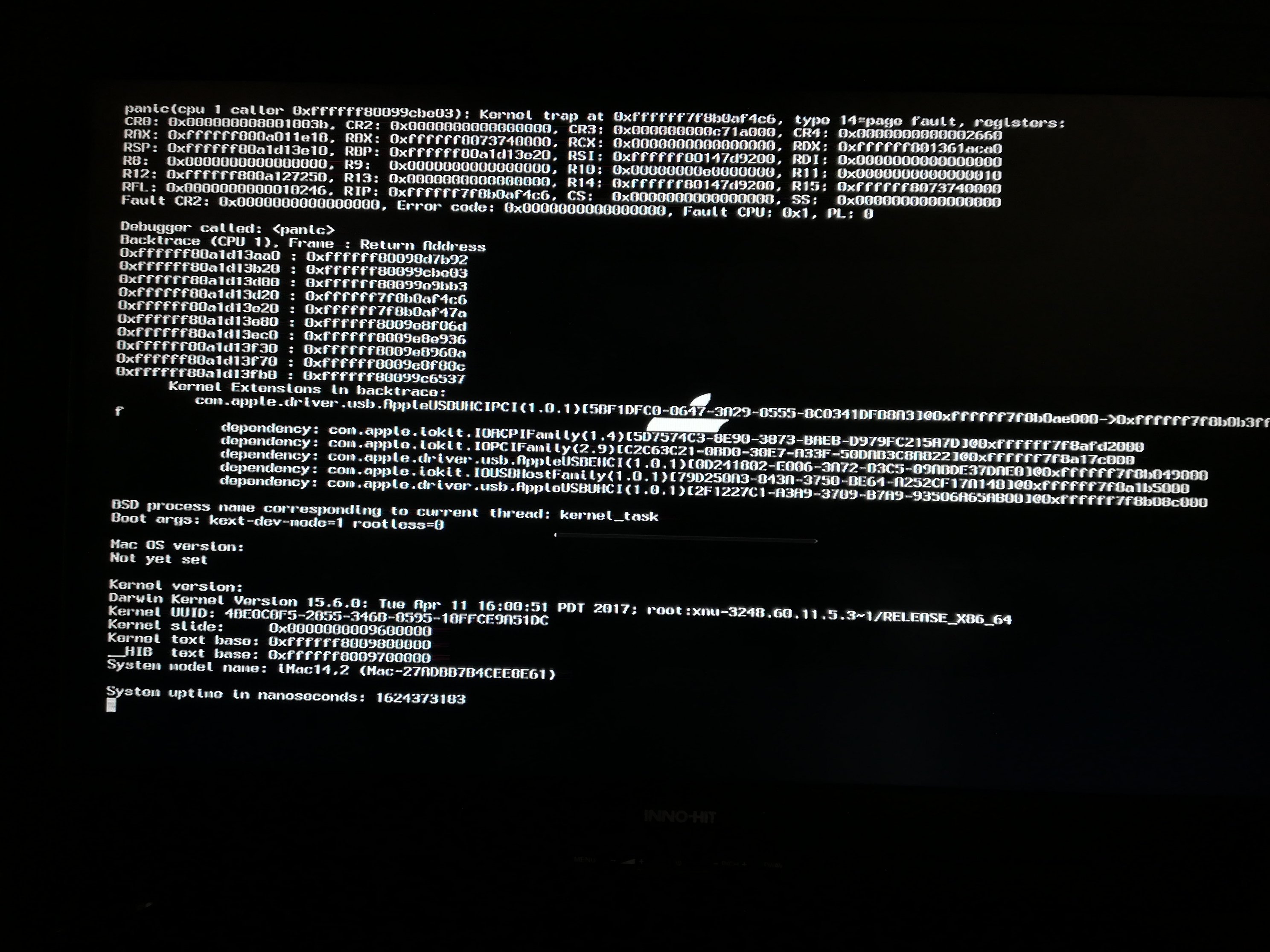

RichieKotzen Posted January 10, 2020 Author Share Posted January 10, 2020 no way.kernel panic Link to comment https://www.insanelymac.com/forum/topic/342056-nvidia-9800gt-hdmi-el-capitan/#findComment-2703647 Share on other sites More sharing options...
RichieKotzen Posted January 10, 2020 Author Share Posted January 10, 2020 Link to comment https://www.insanelymac.com/forum/topic/342056-nvidia-9800gt-hdmi-el-capitan/#findComment-2703655 Share on other sites More sharing options...
