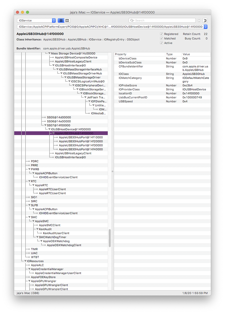

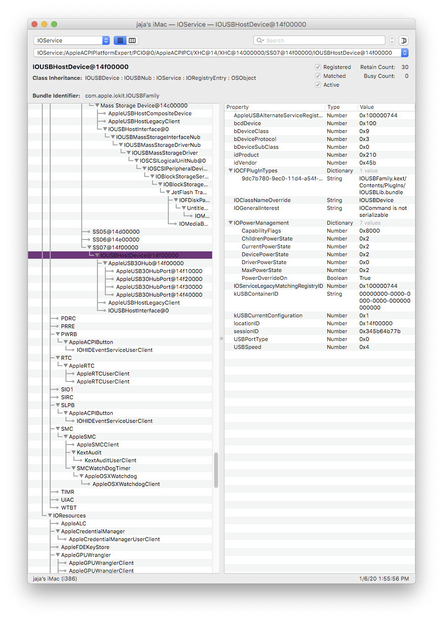

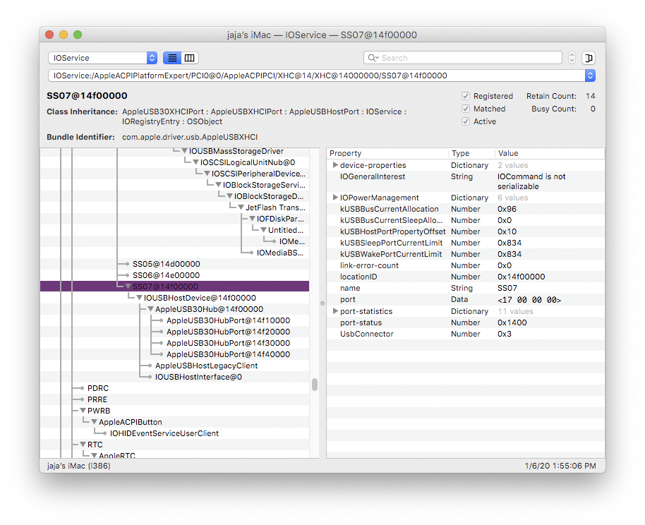

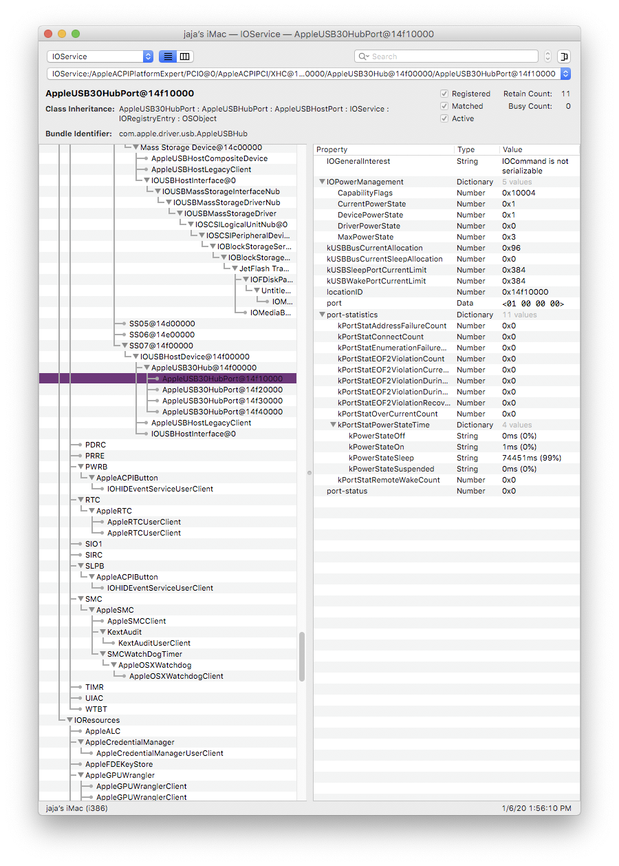

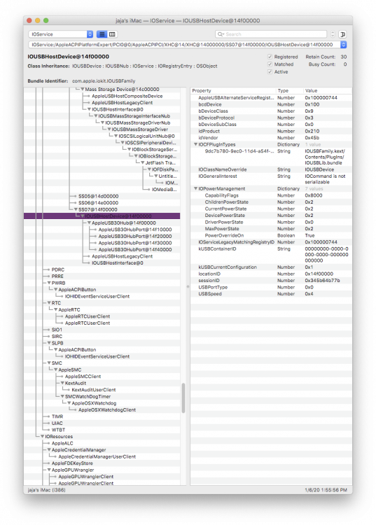

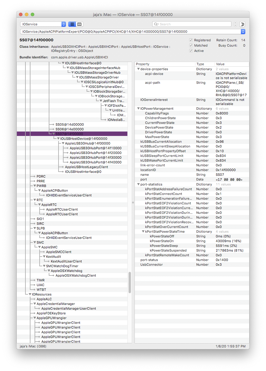

My system works with full usb support, single click wake and usb drives not ejecting except when I boot with my monitor usb attached(hardware calibration + built in usb 3.0 hub, EIZO CS2420). If I boot with the monitor plugged in, it auto-wakes from sleep without the display and ejects drives, and has other usb inconsistencies. Any ideas? If I boot with the monitor in rather than plug it after, it mounts it to a HS port rather than a SS port as it should and I screenshotted below.
Below is what the hub device looks like in IOreg. Here's my ssdt-uiac
