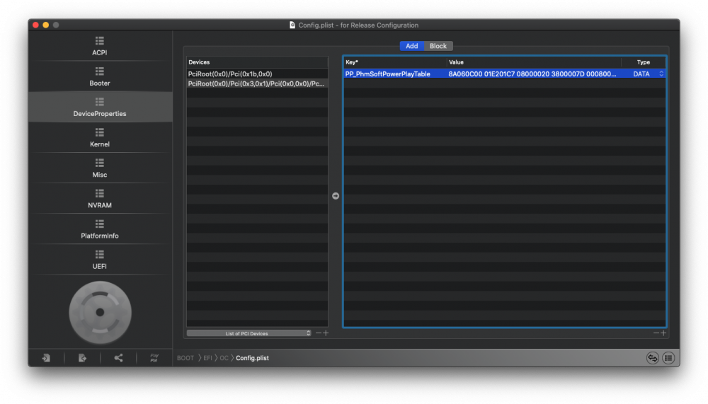

atoffolo Posted March 30, 2020 Share Posted March 30, 2020 (edited) I apologise for bothering you guys on this topic, and I realise Chris put the table generator out there for people that know what they are doing. I know many things but not this far unfortunately and I'm wondering if you can help me out and walk me through the process. I already downloaded your table and Clover Configurator. I'm on a iMacPro with OS 10.15.4. I have an eGPU Razer Core X with a XFX AMD Radeon™ RX 5700 XT 8GB GDDR6 THICC III Ultra. I'm trying to get a little better performance since it is not much different then the built in video card (an Radeon Pro Vega 64 16 GB) score 1700 vr 1400... I'm coming your screenshot of Clover and entering the values under the device section... but after that I'm not sure what to do... I imagine saving the .plist and substituting the original one in some folder location... but it is just a guess... Let me know if you can help... I would really appreciate it... I'm using all this for work... Twinmotion renders... I'm an interior architect. I apologise for badgering you guys on this topic, and I realise Chris put the table generator out there for people that know what they are doing. I know many things but not this far unfortunately and I'm wondering if you can help me out and walk me through the process. I already downloaded your table and Clover Configurator. I'm on a iMacPro with OS 10.15.4. I have an eGPU Razer Core X with a XFX AMD Radeon™ RX 5700 XT 8GB GDDR6 THICC III Ultra. I'm trying to get a little better performance since it is not much different then the built in video card (an Radeon Pro Vega 64 16 GB) score 1700 vr 1400... I'm coming your screenshot of Clover and entering the values under the device section... but after that I'm not sure what to do... I imagine saving the .plist and substituting the original one in some folder location... but it is just a guess... Let me know if you can help... I would really appreciate it... I'm using all this for work... Twinmotion renders... I'm an interior architect. Edited April 1, 2020 by atoffolo Link to comment https://www.insanelymac.com/forum/topic/340909-tool-amd-radeon-rx-5700-xt-powerplay-table-generator/page/2/#findComment-2714615 Share on other sites More sharing options...

mrexot Posted April 29, 2020 Share Posted April 29, 2020 I have a problem with my "SAPPHIRE Radeon NITRO+ RX 5700 XT 8G OC Special Edition" and PowerPlay Table generator. I'm new with hackintosh but learning fast. Wanted only to disable zero RPM and set fanPWMmin lower then 26 (that is default for my card, and its too high). But I get black screen while booting (few seconds after Apple logo appears). This is my configuration (default values extracted with gpuz/morepowertool at Win10): Using OpenClover 0.5.6, configurating my config.plist with OpenCore Configurator I found my device path with gfxutil, hope its correct. OpenCore Configurator -> DeviceProperties -> Devices: PciRoot(0x0)/Pci(0x3,0x1)/Pci(0x0,0x0)/Pci(0x0,0x0)/Pci(0x0,0x0) -> Key: PP_PhmSoftPowerPlayTable -> Value: (from excel) -> Type: DATA Can you help me / tell me what I'm doing wrong please? Link to comment https://www.insanelymac.com/forum/topic/340909-tool-amd-radeon-rx-5700-xt-powerplay-table-generator/page/2/#findComment-2719993 Share on other sites More sharing options...
mrexot Posted May 3, 2020 Share Posted May 3, 2020 It works now, I used 7 years old office instead of office 365 2019... damn Link to comment https://www.insanelymac.com/forum/topic/340909-tool-amd-radeon-rx-5700-xt-powerplay-table-generator/page/2/#findComment-2720684 Share on other sites More sharing options...

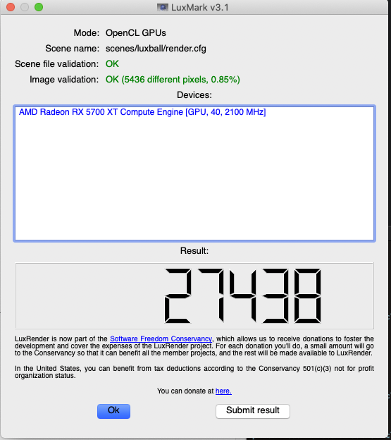

iodine131 Posted June 7, 2020 Share Posted June 7, 2020 (edited) got some improvements, still tuning combinations of voltage and frequency limits under windows. great work! note: the original benchmark is much worse, but I trashed the screenshots, these two are two different settings. config: i9 9900K @ 4.8GHz KLEVV 16GB x2 Gigabyte Z390I AUROS PRO Wifi (BIOS: f8c) Gigabyte 5700 XT Gaming OC Edited June 7, 2020 by iodine131 Link to comment https://www.insanelymac.com/forum/topic/340909-tool-amd-radeon-rx-5700-xt-powerplay-table-generator/page/2/#findComment-2725185 Share on other sites More sharing options...

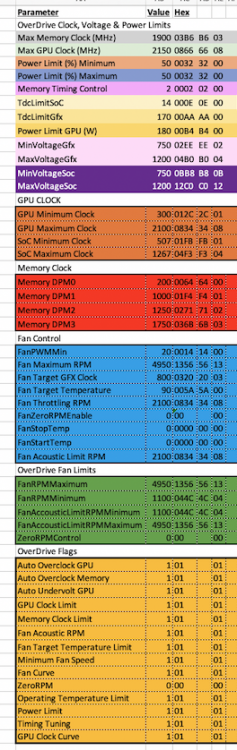

Wackymac Posted July 8, 2020 Share Posted July 8, 2020 Hey @CMMChris wondering if you guide me in the right direction and how to pull the stock powerplay table from my card? its a 5700xt asrock taichi X and has slightly different clocks than this posted powerplay table. Thanks Link to comment https://www.insanelymac.com/forum/topic/340909-tool-amd-radeon-rx-5700-xt-powerplay-table-generator/page/2/#findComment-2729384 Share on other sites More sharing options...
CMMChris Posted July 9, 2020 Author Share Posted July 9, 2020 Use More Power Tool on Windows to get the values from your VBIOS. 1 Link to comment https://www.insanelymac.com/forum/topic/340909-tool-amd-radeon-rx-5700-xt-powerplay-table-generator/page/2/#findComment-2729417 Share on other sites More sharing options...
Wackymac Posted July 11, 2020 Share Posted July 11, 2020 now the big questions is, how do i import this data into your excel sheet? surely you use some sort of macro? On 7/9/2020 at 4:37 AM, CMMChris said: Use More Power Tool on Windows to get the values from your VBIOS. Link to comment https://www.insanelymac.com/forum/topic/340909-tool-amd-radeon-rx-5700-xt-powerplay-table-generator/page/2/#findComment-2729830 Share on other sites More sharing options...
CMMChris Posted July 12, 2020 Author Share Posted July 12, 2020 You just need to enter the values that MPT displays. Link to comment https://www.insanelymac.com/forum/topic/340909-tool-amd-radeon-rx-5700-xt-powerplay-table-generator/page/2/#findComment-2729967 Share on other sites More sharing options...
Wackymac Posted July 12, 2020 Share Posted July 12, 2020 1 minute ago, CMMChris said: You just need to enter the values that MPT displays. its actually appears large areas are quite different. i was hoping you could assist in how you did this to start with. Link to comment https://www.insanelymac.com/forum/topic/340909-tool-amd-radeon-rx-5700-xt-powerplay-table-generator/page/2/#findComment-2729968 Share on other sites More sharing options...
Wackymac Posted July 13, 2020 Share Posted July 13, 2020 (edited) 22 hours ago, Wackymac said: its actually appears large areas are quite different. i was hoping you could assist in how you did this to start with. ive just managed to import the data to excel and it appears that my powerplay table is 78 lines while yours is only 67 as well the values seem to be in different locations. Edited July 13, 2020 by Wackymac Link to comment https://www.insanelymac.com/forum/topic/340909-tool-amd-radeon-rx-5700-xt-powerplay-table-generator/page/2/#findComment-2730119 Share on other sites More sharing options...
CMMChris Posted July 13, 2020 Author Share Posted July 13, 2020 Probably a new revision of the PPT. It shouldn't matter tho. Show me a screenshot of your MPT so I can see the differences you are talking about. 1 Link to comment https://www.insanelymac.com/forum/topic/340909-tool-amd-radeon-rx-5700-xt-powerplay-table-generator/page/2/#findComment-2730135 Share on other sites More sharing options...

Wackymac Posted July 13, 2020 Share Posted July 13, 2020 2 hours ago, CMMChris said: What am I supposed to do with that xlsx file? compare the differences i am speaking of? you asked for a screenshot. that is the power play table from my vbios. Link to comment https://www.insanelymac.com/forum/topic/340909-tool-amd-radeon-rx-5700-xt-powerplay-table-generator/page/2/#findComment-2730169 Share on other sites More sharing options...
CMMChris Posted July 13, 2020 Author Share Posted July 13, 2020 (edited) Eh?! I told you to use MorePowerTool to check your cards values and then transfer them into my PPT generator. Then you told me about differences On 7/12/2020 at 10:58 AM, Wackymac said: its actually appears large areas are quite different I asked you to provide screenshots of MorePowerTool and you came up with a copy of your cards PowerPlay Table which is not what I asked for. Edited July 13, 2020 by CMMChris Link to comment https://www.insanelymac.com/forum/topic/340909-tool-amd-radeon-rx-5700-xt-powerplay-table-generator/page/2/#findComment-2730214 Share on other sites More sharing options...
