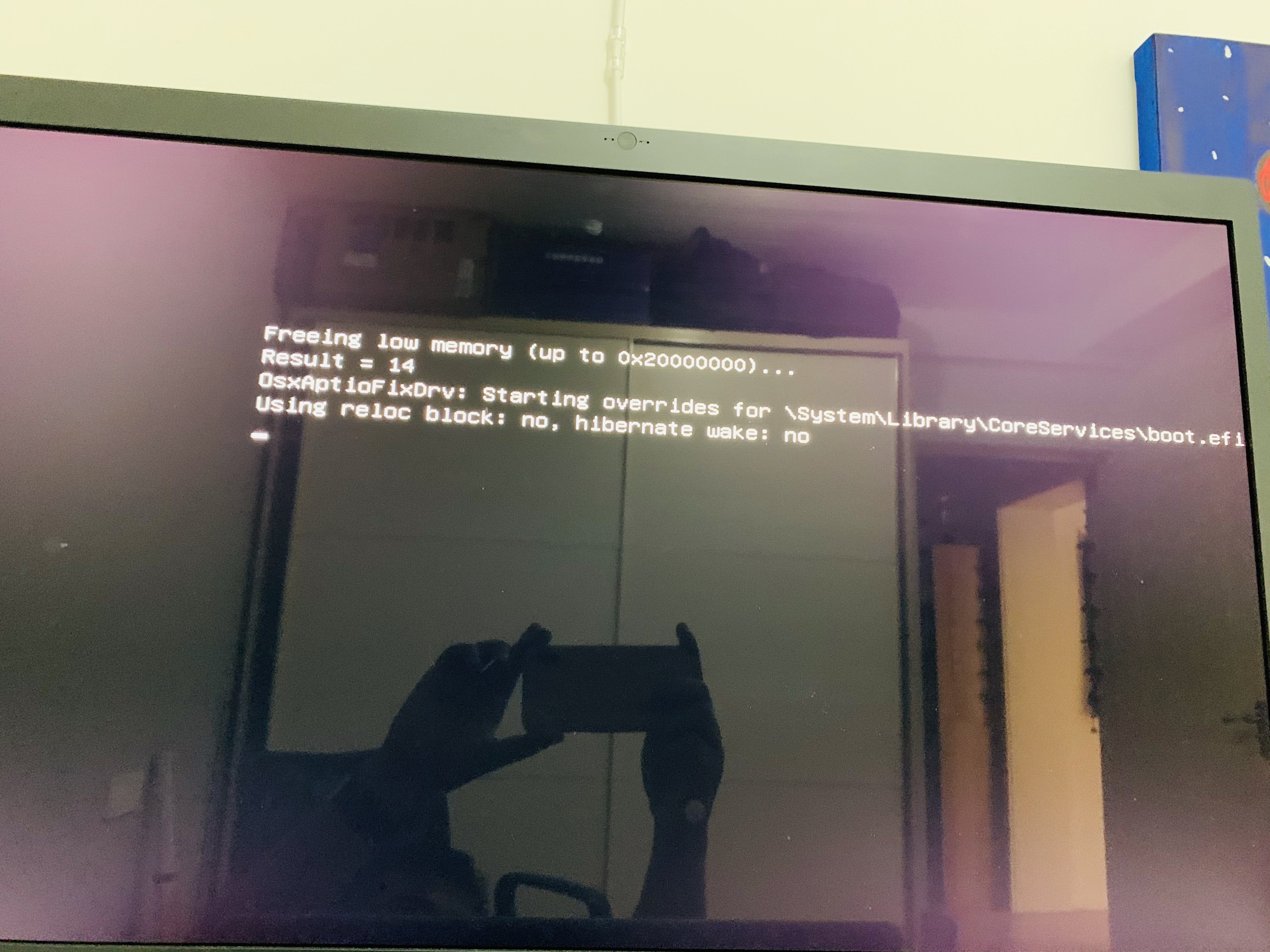

vrox4eva Posted October 9, 2019 Share Posted October 9, 2019 Hi Am still pretty new to this, but I managed to get my Hackintosh up and runnning. My configuration is : CPU - Intel i5 7500 Motherboard - ASUS Z270A Prime Graphics - Sapphire RX580 RAM - Kingston Fury X 16GB (2x8GB) My issue is the iGPU doesn't seem to be detected at all, but my RX580 does get detected. I tried to follow the Framebuffer patch from Rehabman, but doesnt seem to fix it. The kexts I am using are : AppleALC IntelMausi VirtualSMC AptioFix WhateverGreen Lilu Realtek8100 XHCI Unsupported NoVPAJpeg Could someone point me in the right direction on fixing this please? 1 Link to comment Share on other sites More sharing options...

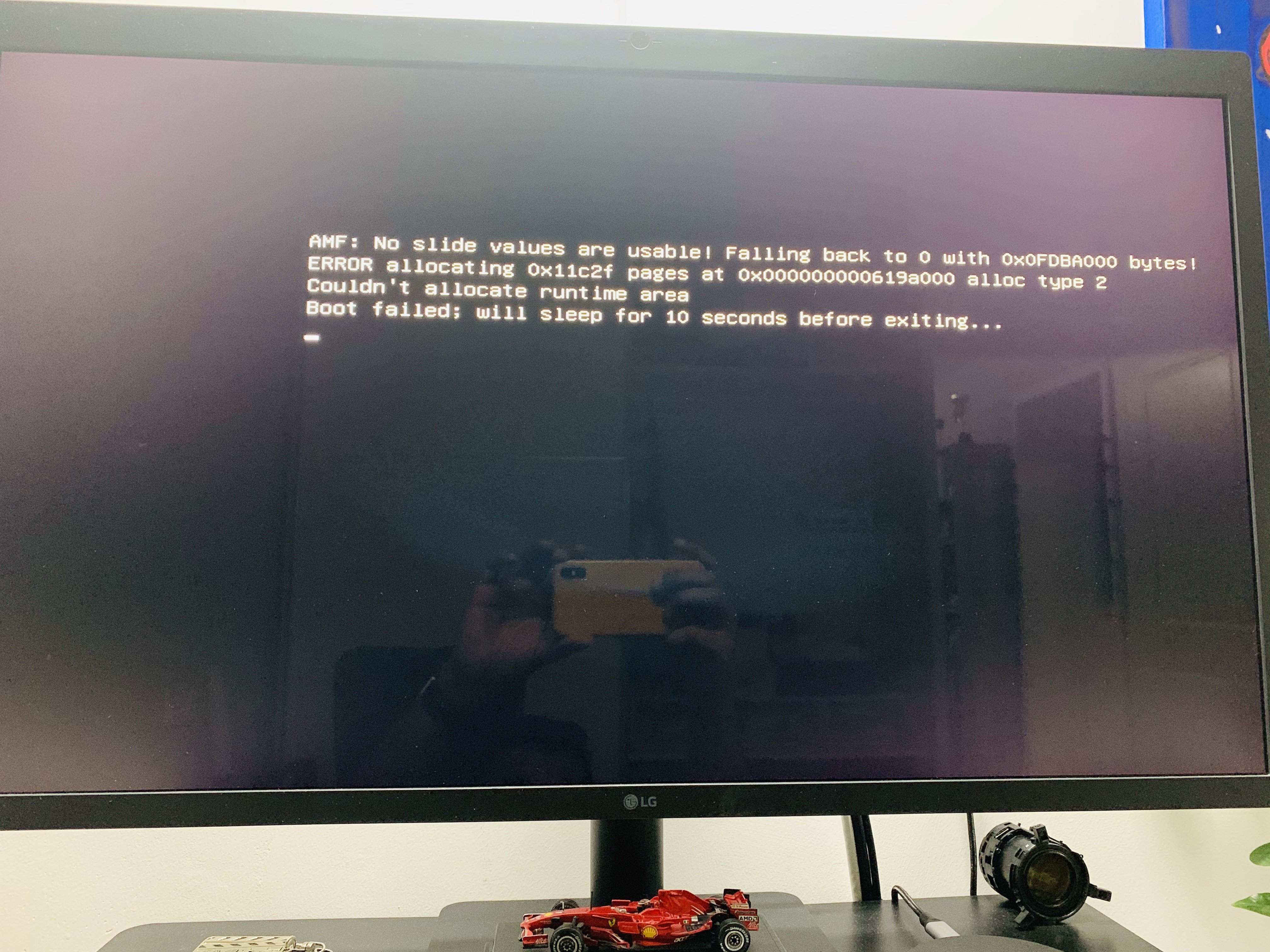

vrox4eva Posted October 9, 2019 Author Share Posted October 9, 2019 5 hours ago, MaLd0n said: asus mobo for intel quick sync u need enable in BIOS/UEFI Multi Monitor option and Primary Gpu = PEGP Use last weg kext and let the kext inject a correct things When i enable Multi monitor, macOS doesnt boot and stop with message "Couldn't allocate runtime area", but boots once i turn off the Multi-monitor option Link to comment Share on other sites More sharing options...
vrox4eva Posted October 9, 2019 Author Share Posted October 9, 2019 Tried all the OSXAptioDrv drivers, cant seem to get any of them to work Link to comment Share on other sites More sharing options...
MaLd0n Posted October 9, 2019 Share Posted October 9, 2019 OsxAptioFix2Drv-free2000.efi work with slide=0 bootarg have many discussion about this driver, use or not Link to comment Share on other sites More sharing options...
vrox4eva Posted October 10, 2019 Author Share Posted October 10, 2019 Doesnt seem to work. Would you mind having a look at my config.plist? Thank you config.plist.zip Link to comment Share on other sites More sharing options...
