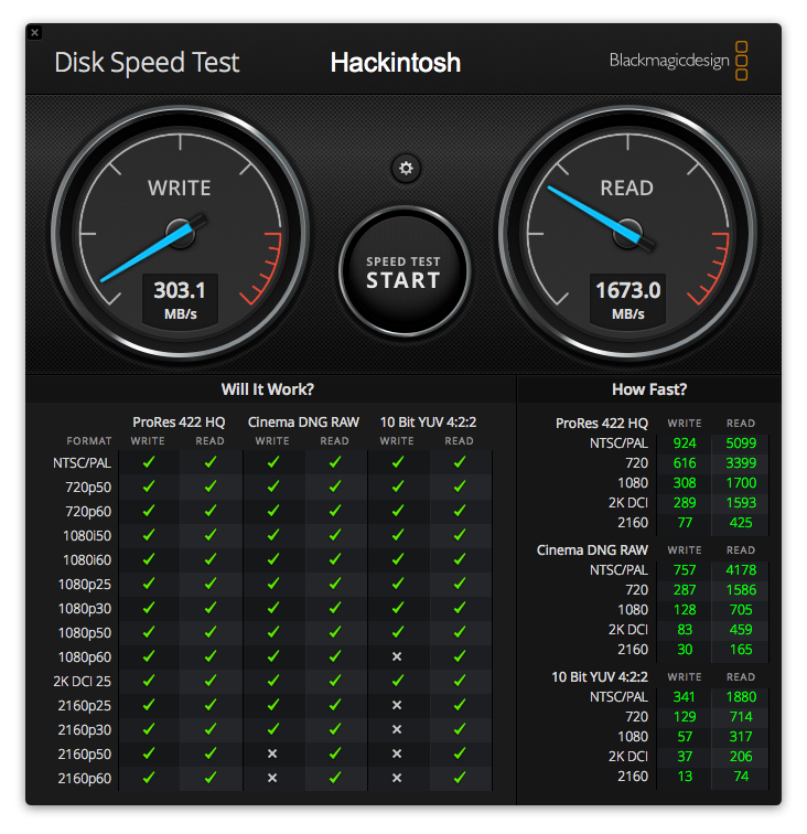

I did a fresh install of MacOS 10.14.6 because I had a lot of trouble after upgrading from 10.13 (random boot errors, preview problems and what not).
The problem now is:

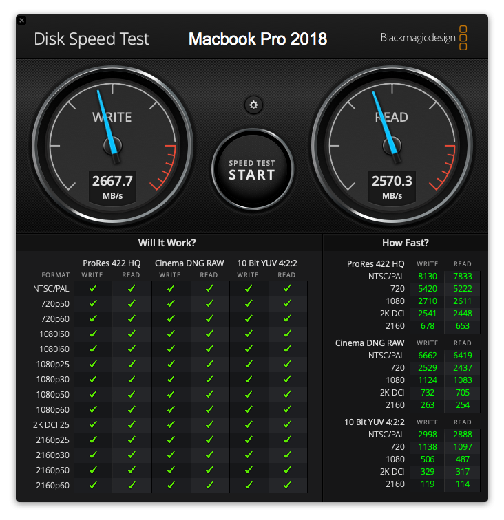

My disk speed is terrible. I just compared to a brand new Macbook Pro 2018 and the result (see attached pics):
Macbook Pro: 2667/2570 MB/s
Hackintosh :  303/1673 MB/s
After a bit of research I tried enabling TRIM again. No difference.
Any idea how to fix this?
My specs:
CPU: Intel i3-8100 | Board: MSI Z370-A Pro | GPU: Sapphire Radeon RX580 | RAM: 32GB Corsair Vengeance LPX | Drive: Samsung 960 EVO m.2 250 GB
Installed drivers:

On 9/24/2019 at 5:24 PM, Hervé said:
Check your BIOS settings in case you missed something out on that front. If the M.2 slot is set for 4 x lanes as it can be expected, you should be getting the same sort of performance I reported in the post linked above.
Sorry für the late answer. In my bios is no setting regarding the m.2 slot and the speed is still terrible. Any more ideas?
