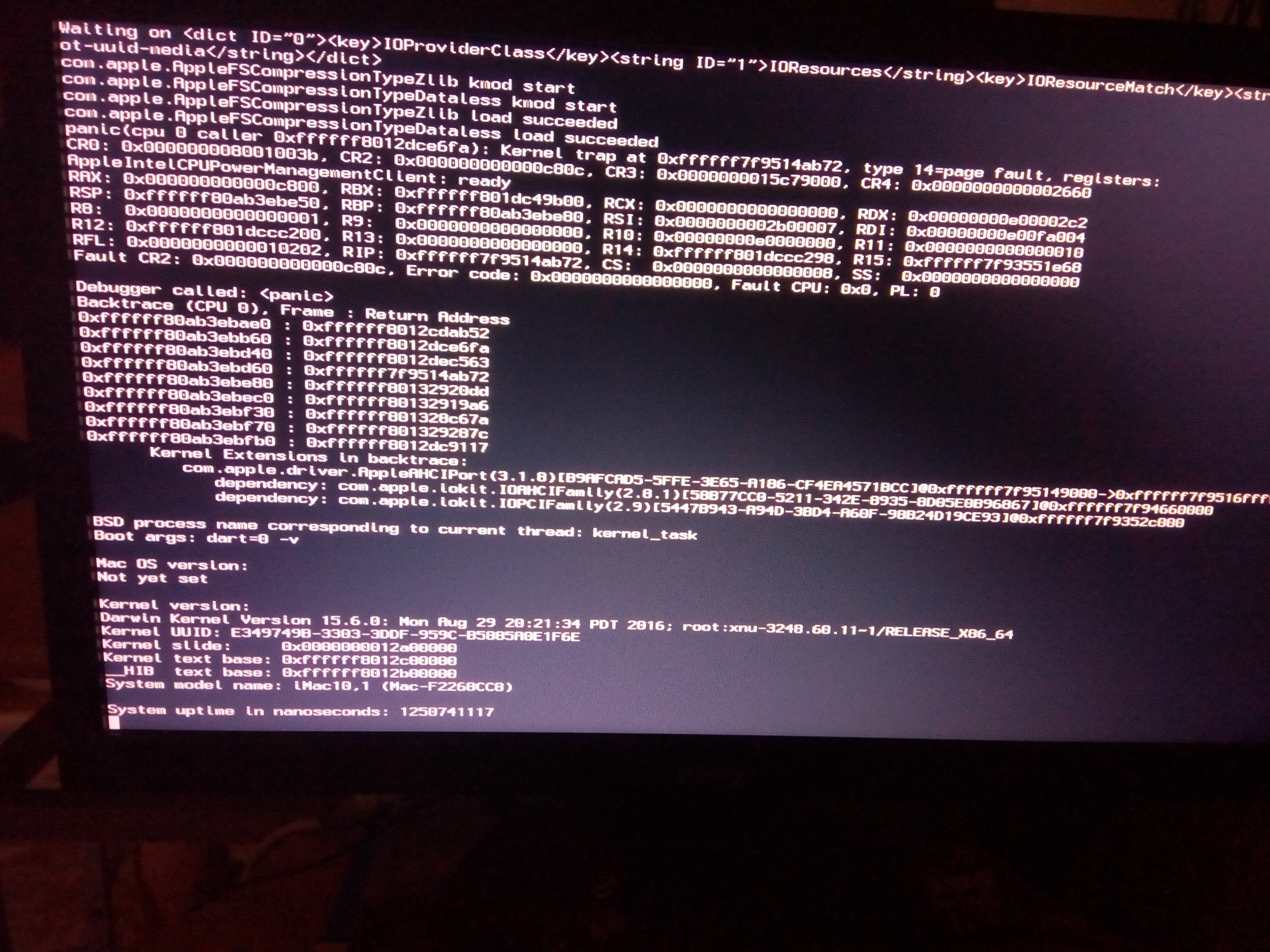

shinho73 Posted August 5, 2019 Share Posted August 5, 2019 (edited) I managed to install El Cpitan on a very old (no AHCI only IDE option) core 2 duo PC with no_ahci_fix kexts. Everything is working except the power off and reboot. It just hangs. The screen turns black with cursor. On DSDT and SSDT, no errors. On clover config "fix_shutdown" does not do anything. Only way to turn the PC off is by pushing the power button. I uploaded DSDT, SSDT, and Config.plist. Can somebody look at them. Any help will greatly appreciated. Thank You. DSDT.dsl SSDT-0.dsl config.plist Edited August 5, 2019 by shinho73 Link to comment https://www.insanelymac.com/forum/topic/339792-el-capitan-10116-shutdown-and-reboot-issue/ Share on other sites More sharing options...

shinho73 Posted August 5, 2019 Author Share Posted August 5, 2019 Did not work. System uptime in nanosecond and just reboots. Also on the boot screen, graphics issue. Link to comment https://www.insanelymac.com/forum/topic/339792-el-capitan-10116-shutdown-and-reboot-issue/#findComment-2684448 Share on other sites More sharing options...

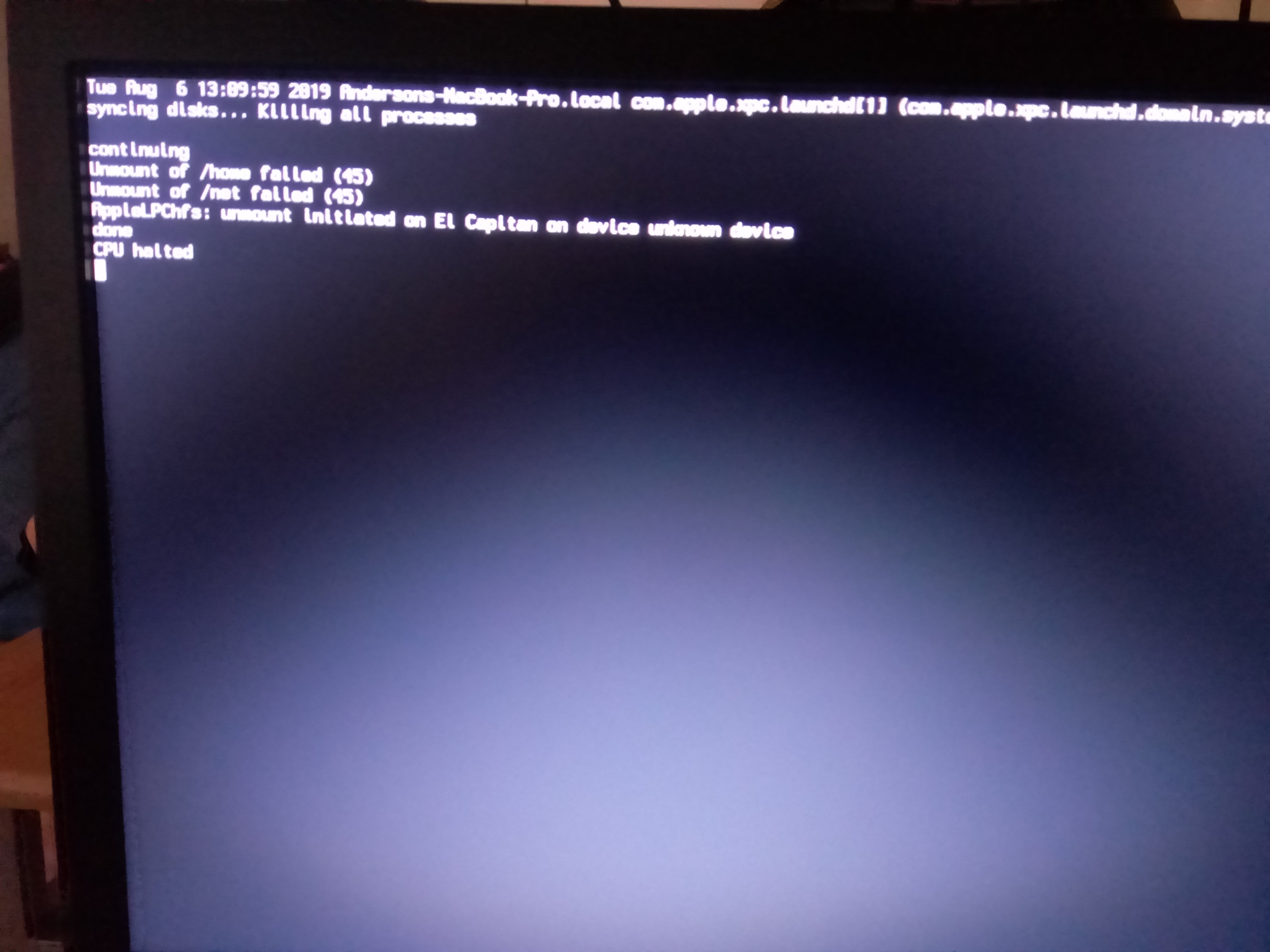

shinho73 Posted August 6, 2019 Author Share Posted August 6, 2019 (edited) Did not work. Could not use keyboard and mouse and stuck on black screen with cursor while shutting down or on reboot. I had same issue on Yosemite and used these commends and worked without any issues. Muchas gracias por tu ayuda. sudo defaults write /System/Library/LaunchDaemons/com.apple.securityd ExitTimeOut -int 5 sudo defaults write /System/Library/LaunchDaemons/com.apple.mDNSResponder ExitTimeOut -int 5 sudo defaults write /System/Library/LaunchDaemons/com.apple.diskarbitrationd ExitTimeOut -int 5 sudo defaults write /System/Library/LaunchDaemons/com.apple.coreservices.appleevents ExitTimeOut -int 5 sudo defaults write /System/Library/LaunchAgents/com.apple.coreservices.appleid.authentication ExitTimeOut -int 5 Not getting this screen on shutdown or reboot. Edited August 6, 2019 by shinho73 Edit Link to comment https://www.insanelymac.com/forum/topic/339792-el-capitan-10116-shutdown-and-reboot-issue/#findComment-2684604 Share on other sites More sharing options...
